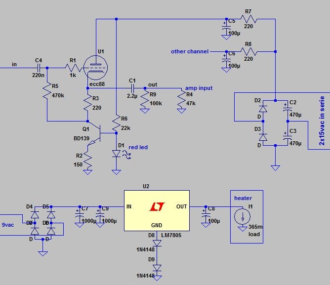

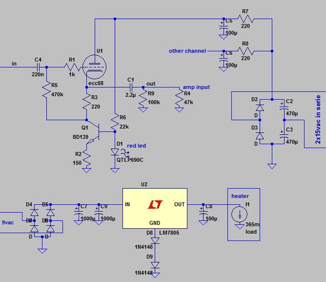

For LED lamp QTLP690C is Vf=2V (2.4Vmax)
we obtain (2-0.65)/150=0.009A or we obtain 9mA, when the current should be 5...8mA?😕
why with the red LED (Vf=1.8V; 2Vmax) current is 7mA

Stop obsessing about that led. In the program I use to draw the schematic (and simulate it to double check for errors), that QTLP690C gives me 1.8v. It matches cheap 3mm or 5mm red leds, I never ever used a QTLP690C in real life.

If someone wants to make some suggestions regarding these schemes go ahead.

So Ben (00940) now I'm working on arranging the schematic, and then attach to the soldering iron.😉
So if you need some changes to the schematic go ahead.

"We" ? 😕We have a transformer with a secondary voltage 2x22V / 0.15A and 2x8V / 0.6 A, what should I change in the schematic with tube buffer?
Anyway:
For the high voltage, use the 2x22v just as the 2x15v, tying the two secondaries in serie (read here about tying the secondaries: Transformers Part 2 - Beginners' Guide to Electronics ). You need higher rated caps though, c2-c3 must be changed to 220uf or 330uf/100v and c5-c6 to 100uf/150v. R7-R8 can be increased to 470 ohms.
For the heaters, use your two 8V secondaries in a full wave rectifier configuration, keep the rest unchanged. Read here to know what I mean: Elliott Sound Products - Linear Power Supply Design (fig. 5).
And, for the love of God, read this if you're going to mess around main voltage: Power Supply Wiring Guidelines
R=? R3=?
Is R6 = 22k; R3 = 220R remain in their value or should be changed for Usec = 2x22Vac?
Is this good (see Figure 2)?
Thanks and Cheers!
Ben thanks for your help!"We" ? 😕
Anyway:

Where have you been chasing new ideas... If it's your first build, keep it simple. Remove that high voltage regulator, you'll add one later if you need it and if the buffer works.
R3 is still 220, R6 is still 22K. Just make sure that R6 is 2w (all other resistors can be 1/2w but it wouldn't hurt to have r7/r8 as 1w resistors).
Neither of your schematics is correct.
For the high voltage: fig.1 is correct (if the secondaries are correctly wired).
For the heaters: both are wrong. You need to tie the two 8vac secondaries to make a center tap (again, take care of the windings' phase !). Center tap is ground. Read again: Elliott Sound Products - Linear Power Supply Design , you only need two diodes.
Furthermore, why a 7812 ? the ecc88 has a 6.3V heater. Stick to my schematic, you'll make changes when it works.

Figure 1F
So m-r Ben here we go with this schematic (Figure 1F)
