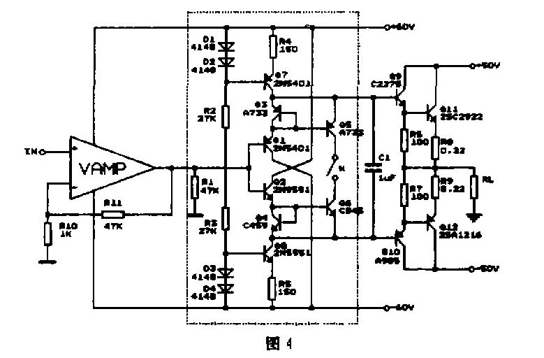

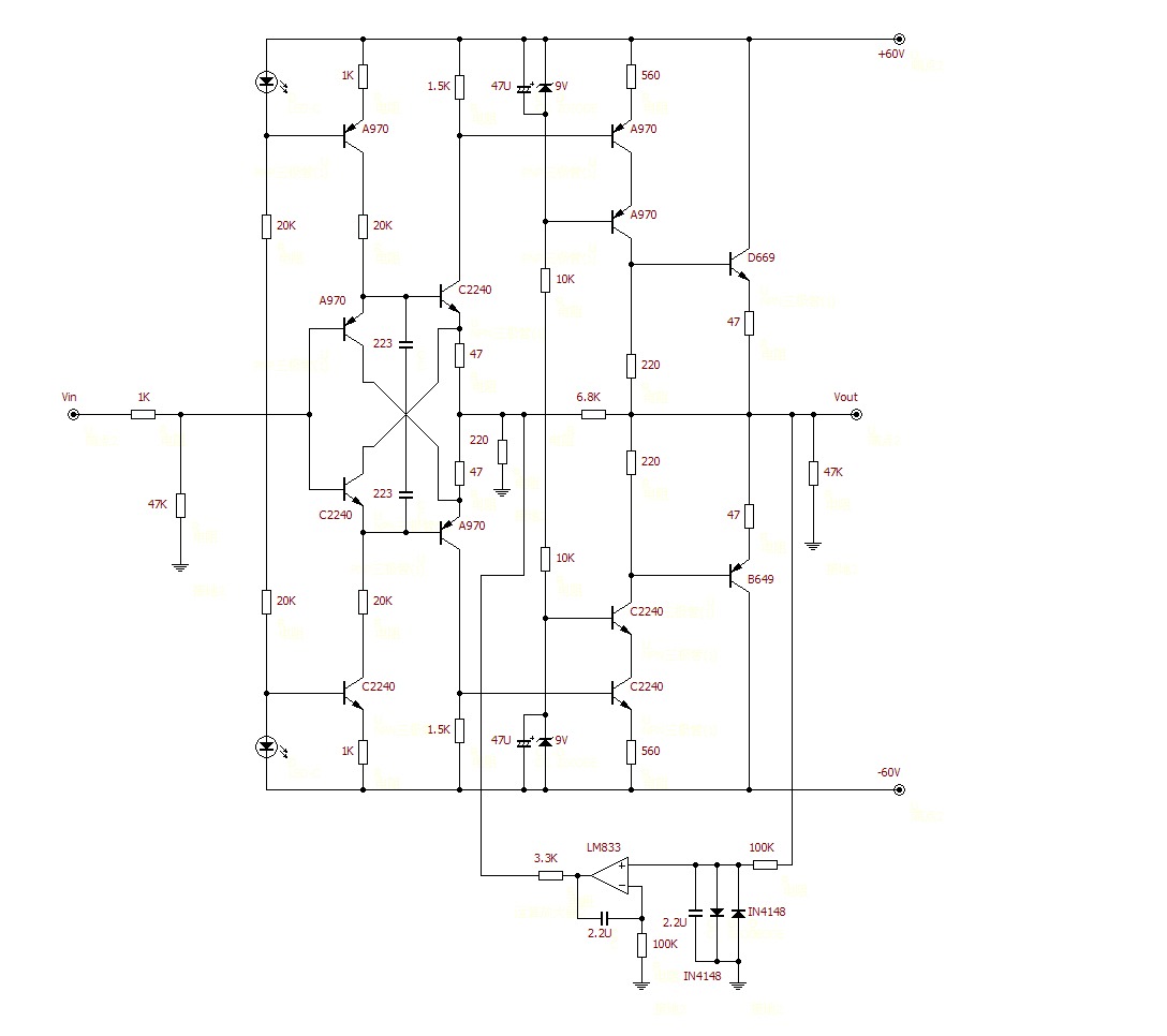

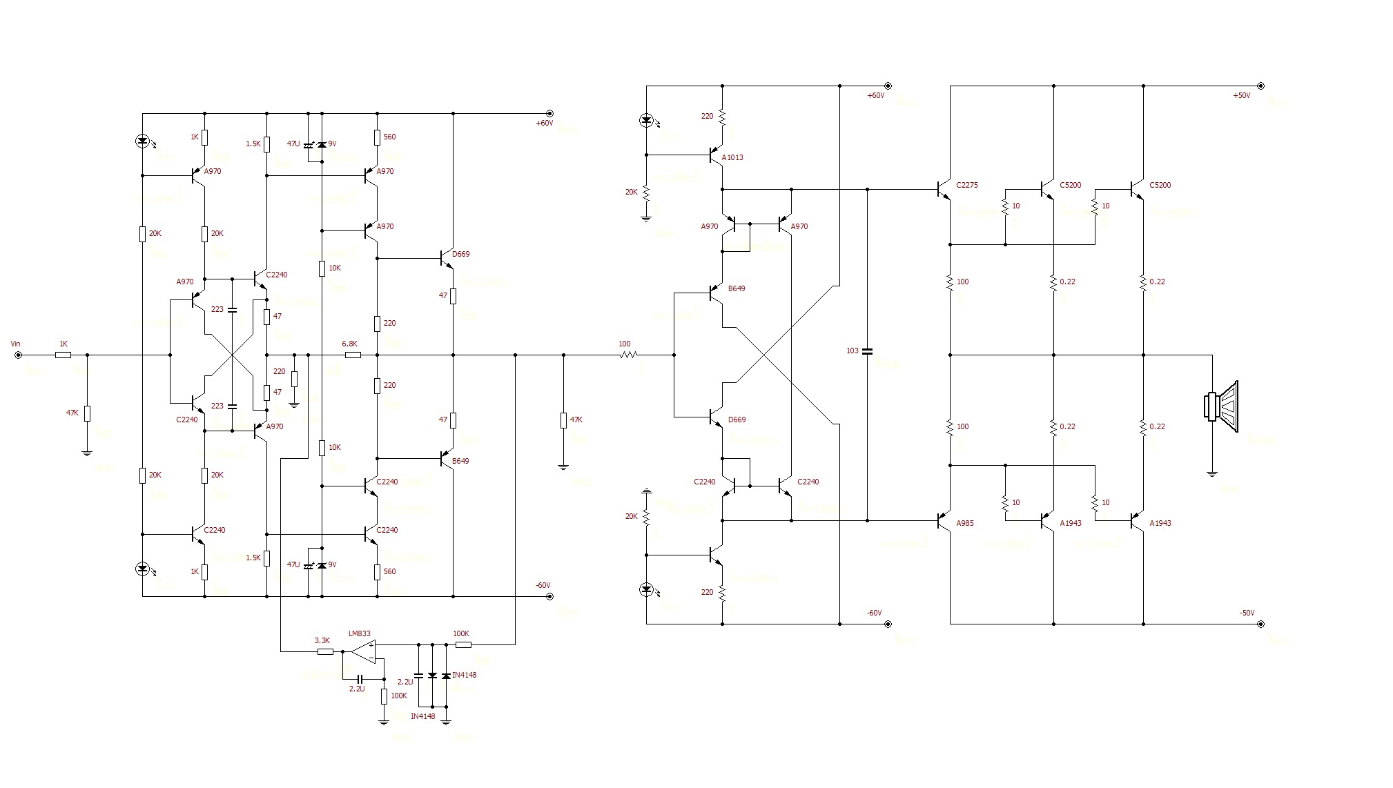

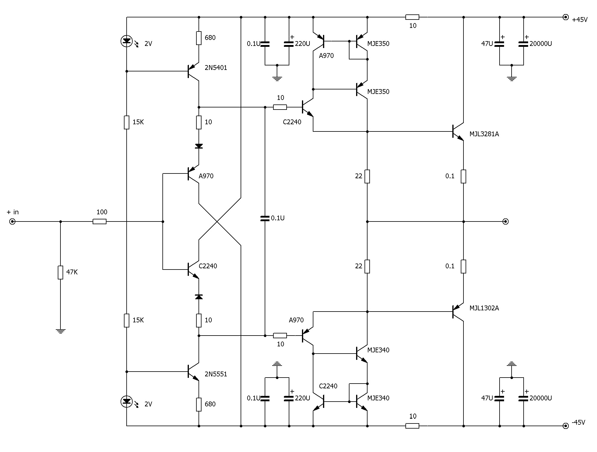

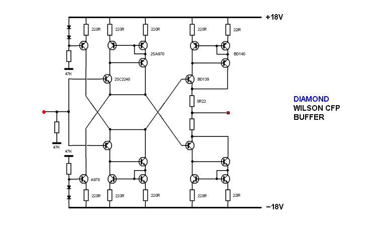

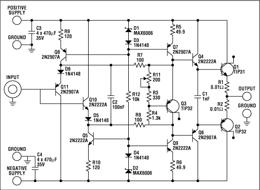

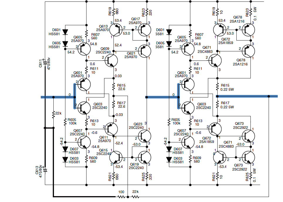

Hi guys,
Do you have or know a high current diamond buffer type? I would like to build a 100W+ amplifier in this composition wich diamond buffer.
Thank you in advence

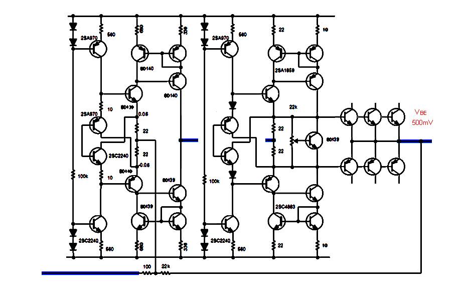

Thank you dreamth, but I am a little bit bad searcher. I don't find the right schematic because none of the above include the exact part types or high current parts. If you or anybody have a tried schema, please share with me.
#104 https://www.diyaudio.com/community/...ign-a-thread-split.366099/page-6#post-6521682Do you have or know a high current diamond buffer type?

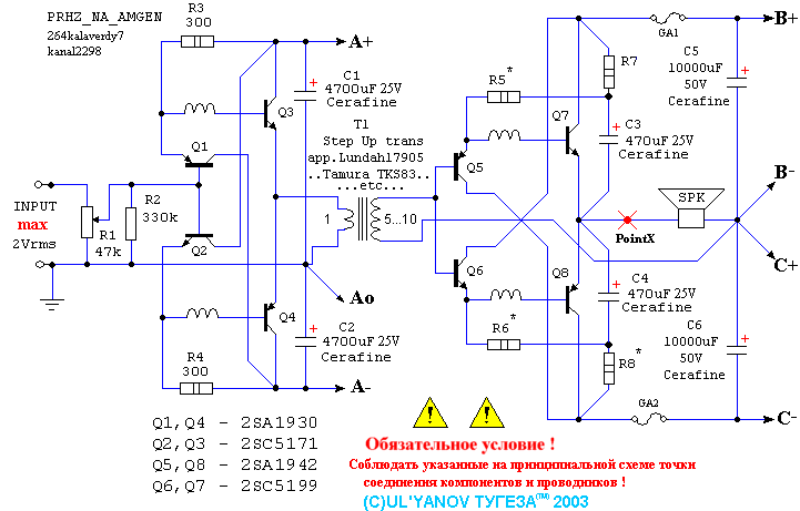

From Russia with Love 🙂
Ageev 1982 http://interlavka.narod.ru/stats03/img/056.jpg
Diamond follower output

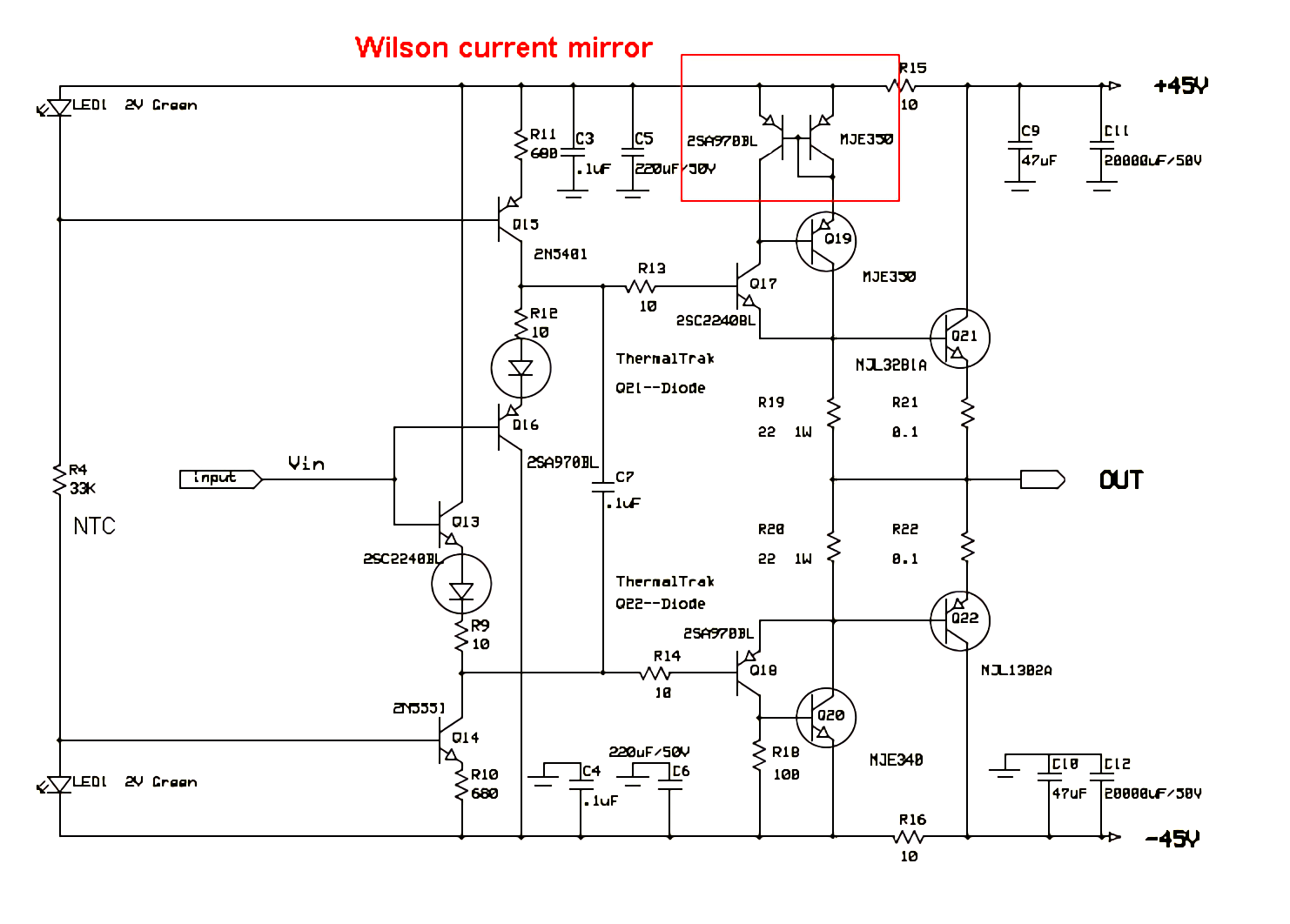

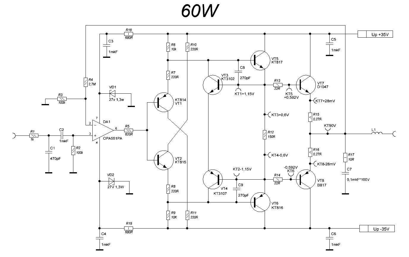

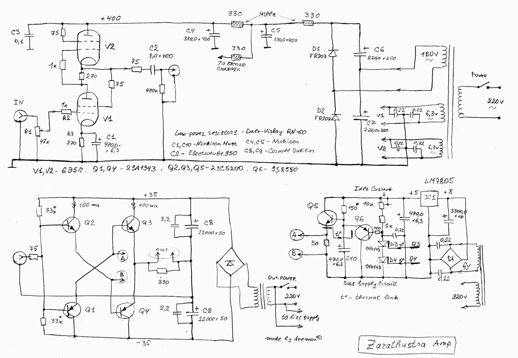

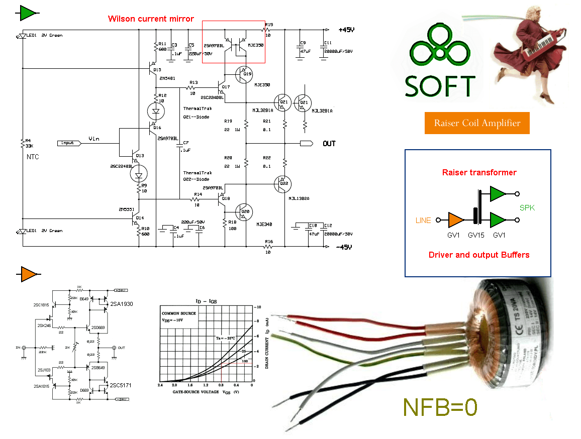

Thank you Mark and OldDIY! Is there one of them the Walt Jung buffer?Diamond follower output
LM,Diamond follower output

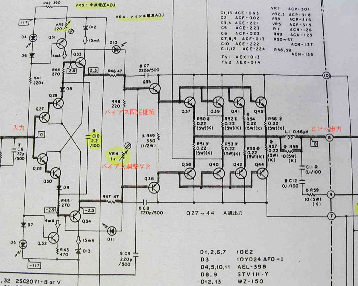

This amp with Wilson mirror - do you have some more info about it? An article or something...
It looks very interesting..

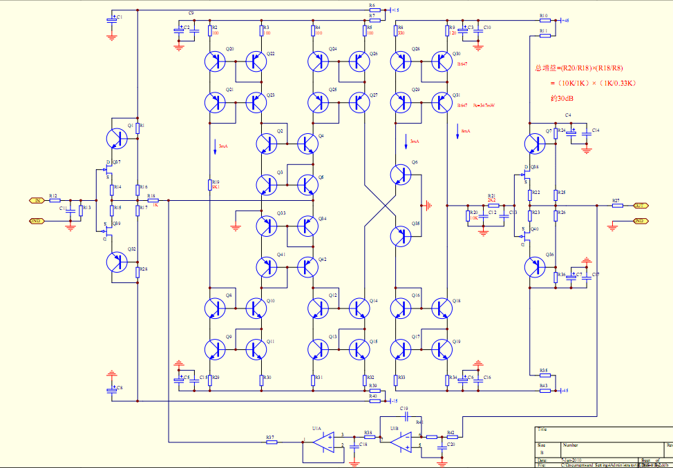

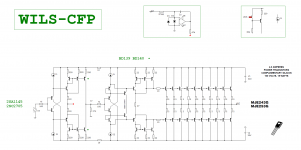

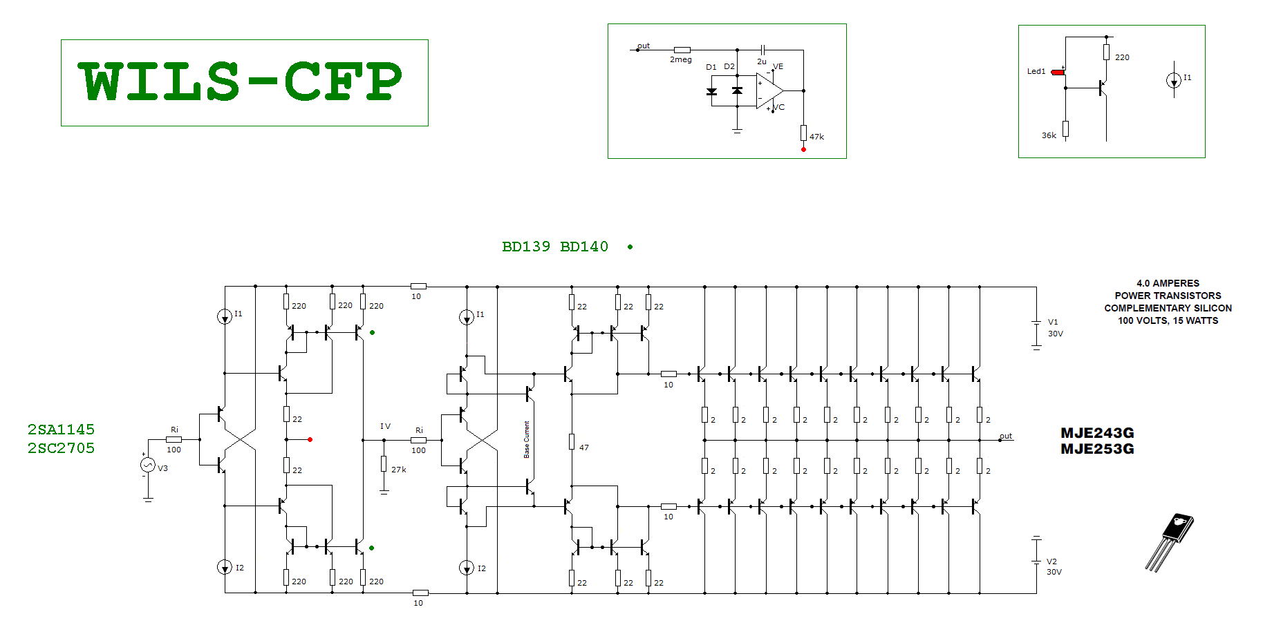

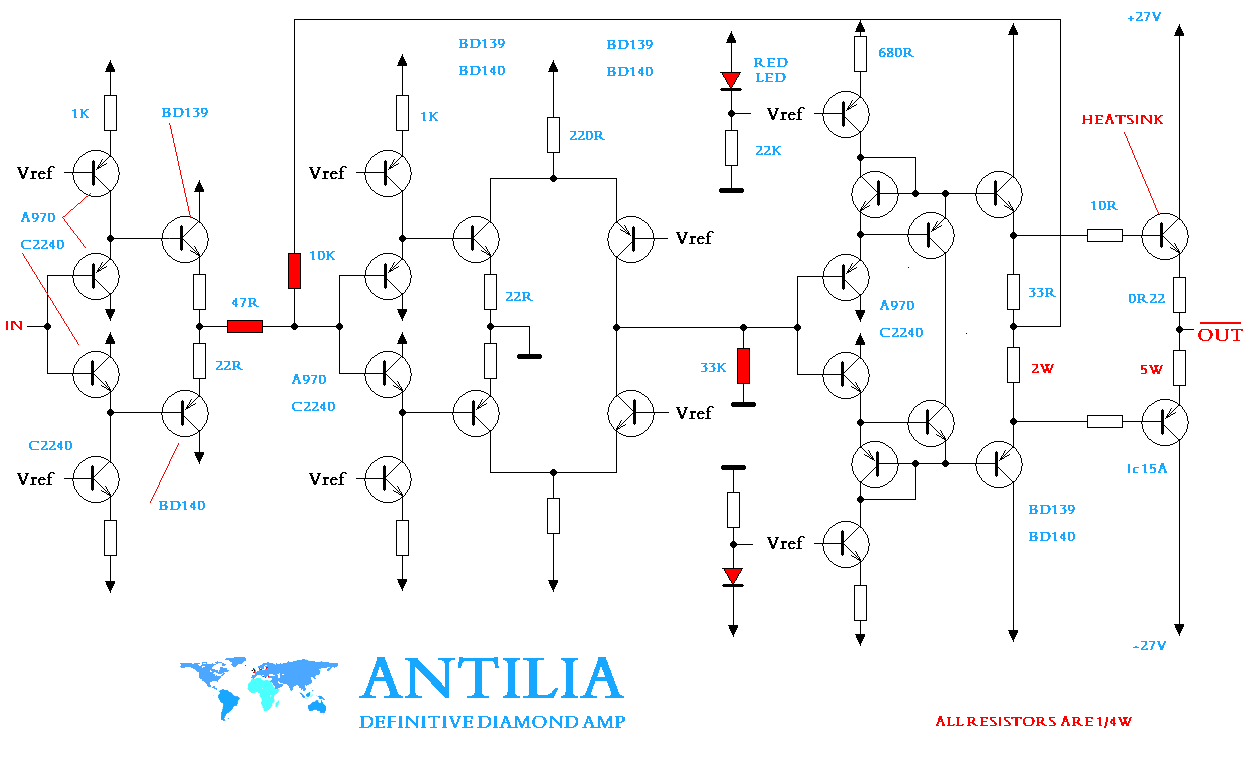

Diamond Buffer with CFP

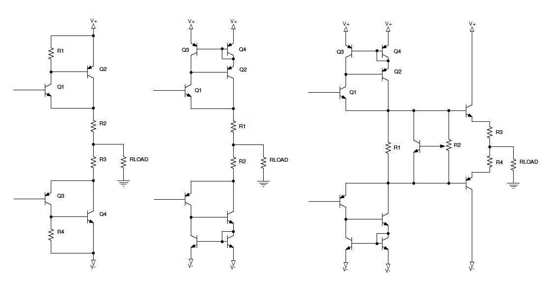

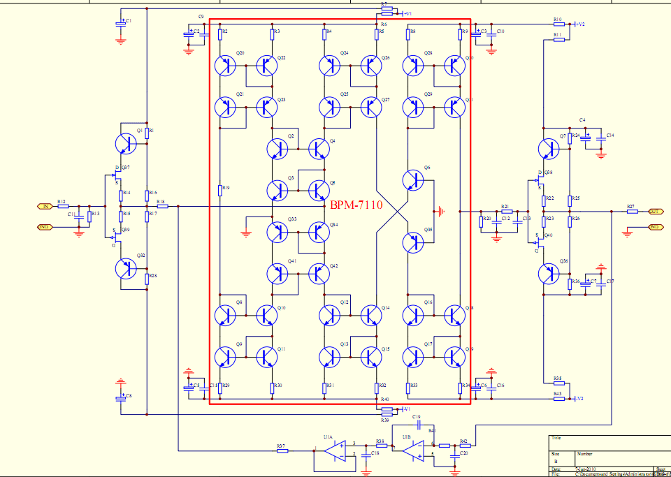

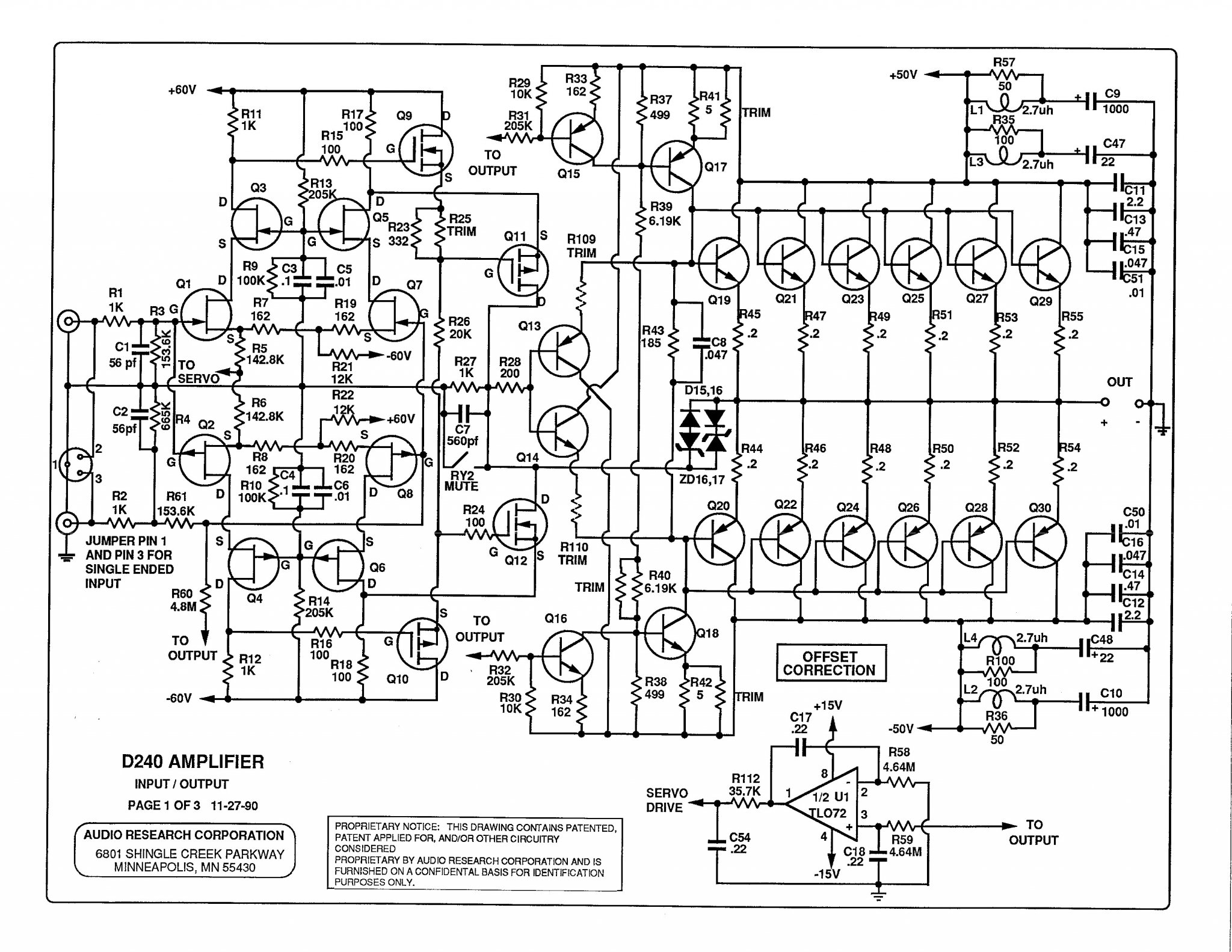

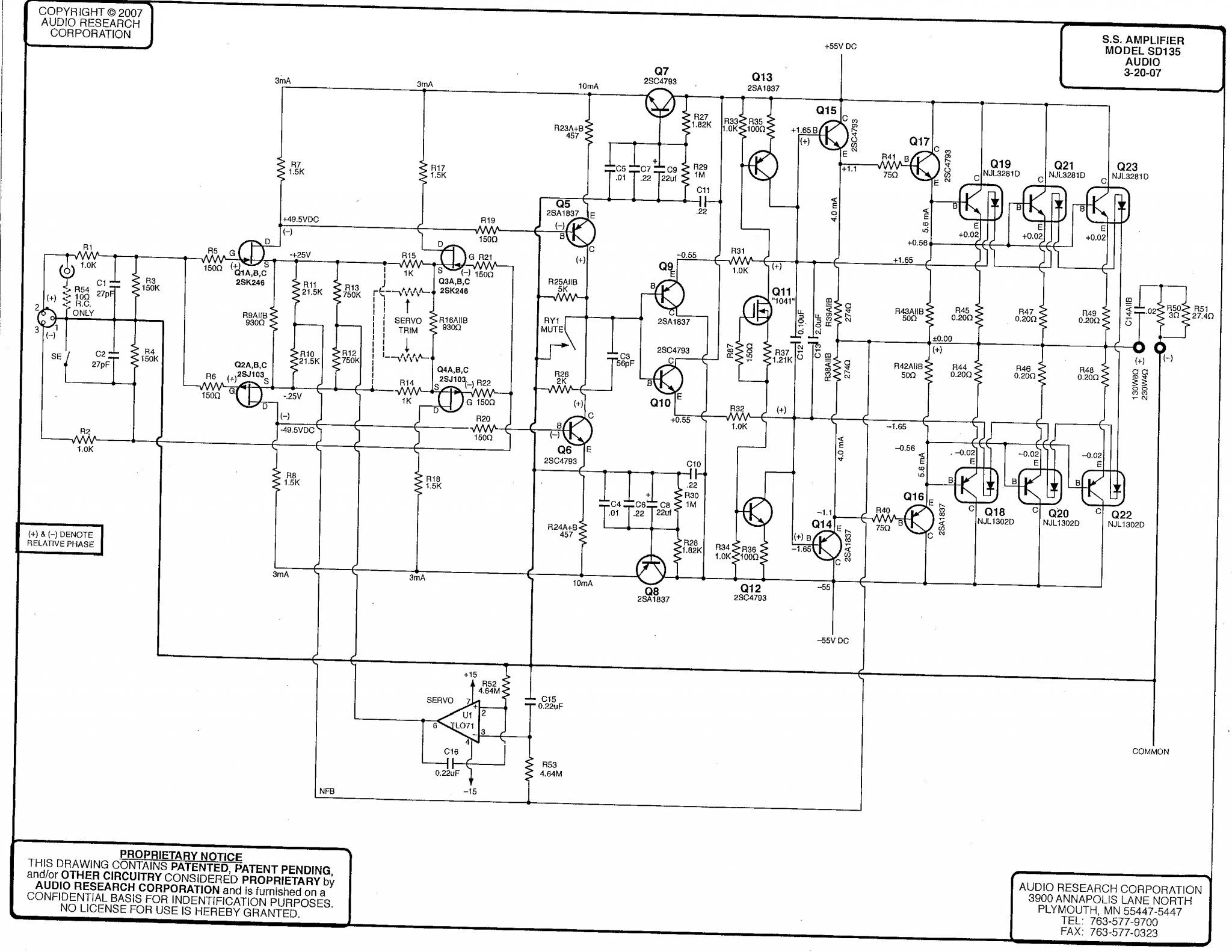

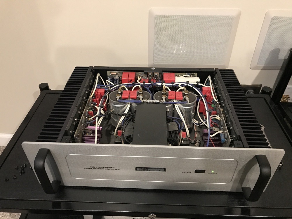

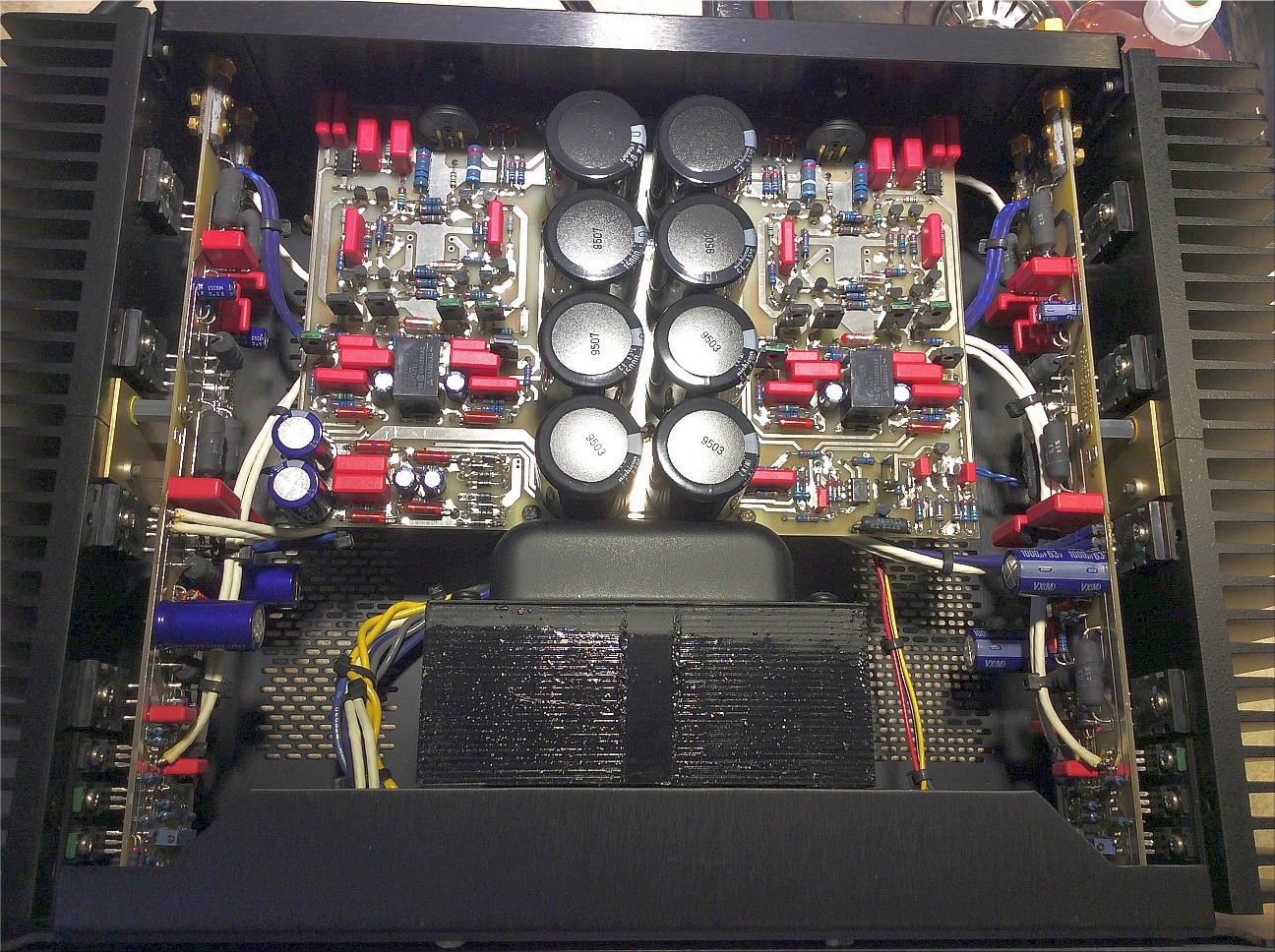

Audio research SD135 / Audio research D240
It's been a long time since i last saw Roman's favourite amp. Perhaps no longer favourite. Looked uncompromising to me at at the time, but not so sure about that today. With the fake bipolar output supply and the really basic supply for the tubez. What, not even a choke?
And a quote from Charly Hansen seems appropriate, seeing the weird biasing arrangement here:
"What is different about the diamond buffer from a typical output stage is that after the signal has been split into two halves to send to each output device, is that the two half signals are rejoined at ONE single point. There is NOTHING in between these two half signals. A conventional output stage always has something in between the two inputs of the two half-output stages before they are recombined. Typically it is a bias circuit of some sort that sets the idling current in the output devices. but there is always something there."
