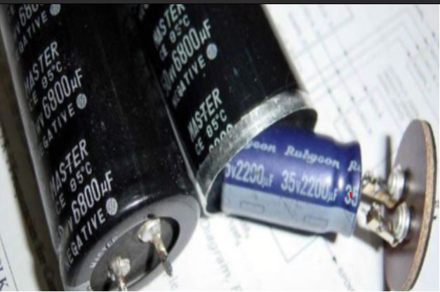

Another visual observation; with a new fuse in that channel to conduct it again, fuse stays ok but one the power caps starts cooking away (bubbling and pops, basically this one is ruined). Switched off to prevent any more pain. Poor Cap.
May aswell replace power caps... 100v 2200uf rubycons on ebay for not much from Poland, set's of 4.
Before buying anything and soldering iron permitting I will try one pair of TO-3 as suggested!! £30 quid though damnit!
If a reservoir cap is bubbling then that is way to much of a coincidence. Could you have a power supply fault such as a shorted diode in the bridge ?

And there are a lot of fake caps around too...

So theres something. No idea what to make of it, theres hum and one cap bubbles away with current applied.
