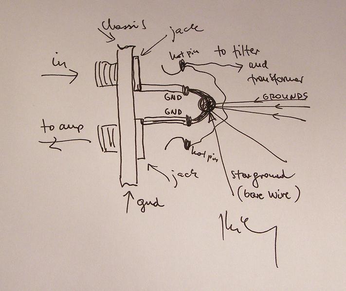

My questions are about the wiring. It is simple enough that I was considering just direct wiring the electrical components between the switches, sockets and transformers. If we do that, how do we run the grounding connections?
1) Can we just wire them to different spots on the bottom of the aluminum enclosure and utilize the enclosure floor to provide the grounding circuit?
2) Or should we collect all the ground in one spot (star grounding?)? If so, should that spot be at the input jack? The 1/4" jacks recommended by Jensen connect the collar to the enclosure, so the collar must be connected to the box. Is that a problem?

After the connectors and the switches are installed into the box, the resistors and wires should be connected directly to their soldering joints (no additional PCB needed). The star ground point is the ground of the input connector, which is also connected to the box. In my opinion, it would be best to mount the input connectors and attenuator and filter switches on the top side of the box whereas the output connectors and the output ground lift switch should be mounted onto the rear side.

Only real issue is the grounding question. Since we can't think of a way to ground everything at the same point, we're going to stay with using the ground lugs from both of the 1/4" jacks.

Don't do it that way, you'll create a ground loop. You should isolate the ground lug of one of your 1/4" jacks. There are many ways to do this. Can you find a plastic 1/4" jack? A plastic box (IMHO this will work fine)? Are you handy enough to rig up a plastic washer and sleeve to isolate the metal jack?

You should mount the jacks as close to one another as possible and then solder a thick piece of uninsulated (bare) wire between the ground lugs to connect them. You will then be able to use the length of the wire as a larger star-ground point (NB: the jacks need not be isolated from the chassis).
Milan
The wire between the lugs is thick so there are no ground loop-induced voltages. See the picture below.
Milan

How thick a wire?
