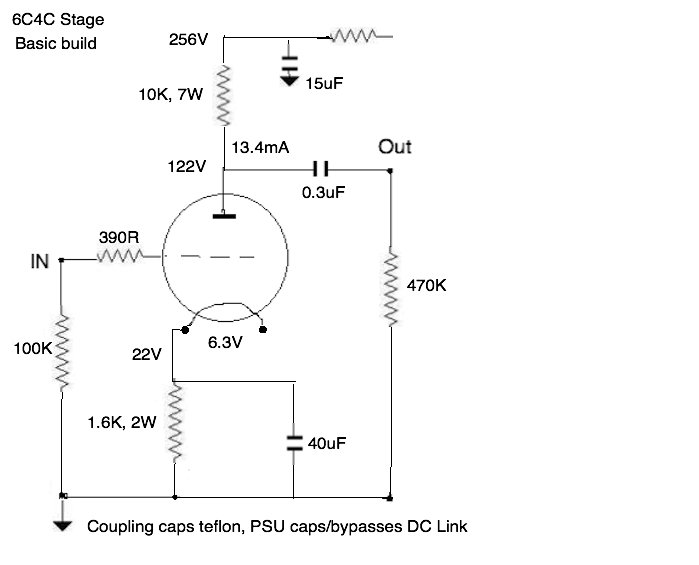

A new build of a 6C4C preamp. I like this a lot - dynamic, detailed, like listening to master tapes in a studio. It's far from an ideal build - solid state PSU with SIC 1200V diodes, lower current through the 6C4C. Just a basic build with parts I had available. But the outboard filament supply is quite a monster - huge chokes in choke input and then Rod's regs in the main chassis. I think it's worth optimising this preamp. The Svetlana 6C4C is a good sounding valve.

Soory but these settings are totaly wrong. Dont want to be offansive, sorry, bur almost every passive complonnent value is wrongA new build of a 6C4C preamp. I like this a lot - dynamic, detailed, like listening to master tapes in a studio. It's far from an ideal build - solid state PSU with SIC 1200V diodes, lower current through the 6C4C. Just a basic build with parts I had available. But the outboard filament supply is quite a monster - huge chokes in choke input and then Rod's regs in the main chassis. I think it's worth optimising this preamp. The Svetlana 6C4C is a good sounding valve.
1. Anode voltage of only 100V is simply too low - tube is voltage dvice not current device. should be more than 200v. Current can be smaller, even the half or more compared to the same tube in amplifier circuit...
2. Anode Rload is too high value of 10K. For the premplifier, when this tube of tube is employed, totaly opposite way is right.
smaller Rload values. Maybe smaller than 3K, should be checked. Distortion will be the minimal or same as with 10K BUT sound will be much better...
3. Grid stopper of 390ohms are doing almost nthing - should be inreased with respect to dynamic capacitance of tube.
4. 100K input grid termination is relatively OK but could be a bigger value u to 390K to accept tube stage before wityhot shunting tha output with 100K...
5. C output is too low value. Imagine next stage Rin of 47K or even 10K standard solid state... Should be 10uF in any way.
6. Output terminatination resistor of 470K is actually NOT the real termination res. Because one Rin from next stage IS. And should be from higher value 2.2meg to 4.7meg. Just to keep the output tied to gnd when preamp is not connected...
7. Kathode bypass capacitor is too low for this value of Rk. In any case shoud be checked with simulations, NOT with the simple RC time formula, because it is not valid in these context. What is the factor is the last C in PS colsest to the Anode, Rload. And offcourse output RC constant.

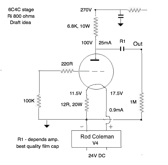

I don't accept half of your reasoning, though you have one or two points. In any case I would build this now in filament bias which sounds better.Soory but these settings are totaly wrong. Dont want to be offansive, sorry, bur almost every passive complonnent value is wrong
- I would use a resistor load because the tonal qualities are better than active loads on acoustic instruments. A plate choke is a possible alternative, but I like the sound of resistor loads.
- B+ would be around 300V because that's what I have available. Anode resistor would be scaled appropriately, could be 3K or whatever
- Grid resistor would be 100K, not bigger
- Output cap would be as low as possible allowing for decent bass response. Probably 1uF or less. If this were to feed a tube stage it would be much less than 1uF and made up of paralleled Russian teflon caps like FT-2, K72. The quality of the cap comes first here and may indicate a compromise on deep bass response.
- 390R is probably a bit high for a grid stopper - could be 220R
- Output termination resistor of 1 meg would be fine, or 2.2 meg as you say. If this stage were used to drive e.g. a 2a3 output stage directly then it would indeed be 470K.
- If a cathode bypass were used 40uF would be fine because it could be a DC Link not an electrolytic. Components that sound better are first choice for me because it's the tonality of the sound that matters. But anyway, filament bias sounds better so that's what it would be.
I've built 10Y and 46 stages in filament bias with resistor loads and they sound excellent. 6C4C is good even with a cathode bypass and will be better in filament bias, as the 10Y and 46 have been. I can see we have different priorities.
I thought grid stoppers were for the purpose of suppressing high frequency circuit resonances for the likes of rf/frame grid tubes designed for rf service but adapted for audio frequency use. Why need a grid stopper on a 2A3 or 6C4C?
it is not issue of using R as Anode load it is OK BUT the value of that R is too high with respect to tube characteristics aind parameters... And that loos of DC voltage at the Rload are huge and unnecessary "eating" the same voltage from tube anode voltage... I will post the graph.I would use a resistor load because the tonal qualities are better than active loads on acoustic instruments. A plate choke is a possible alternative, but I like the sound of resistor loads.
B+ is power supply NOT Anode voltage. Anode Voltage is Va-Vk in this case circa 100V which is very lowB+ would be around 300V because that's what I have available. Anode resistor would be scaled appropriately, could be 3K or whatever
This is NOT grid resistor but Input resistor. This resistor is also the terminating resistor for the stage that comes before preampGrid resistor would be 100K, not bigger
The grid resistor is more grid stopper R...
opposite... It is NOT "probably" the value should be calculated with respect to Rin nezt stage and termination R at the output. C forming the time constant with parralel values of Rin next stage and Term R.Output cap would be as low as possible allowing for decent bass response. Probably 1uF or less. If this were to feed a tube stage it would be much less than 1uF and made up of paralleled Russian teflon caps like FT-2, K72. The quality of the cap comes first here and may indicate a compromise on deep bass response.
Rin next stage is something that could vary. For solid state amplifiers it is from 10K, 47K to 100K.
For tube amps Rin is higher in range of hudrede K.
For the example Your termination resistor is 470K assume that input resistor of the next stage is also 470K.
You have parallel load of 235K. C for -0.25db@20Hz is -3dd@1.6Hz = 1 / (2 x PI x 1.6Hz x 235000) = 0.42uF (0.47uF)
BUT for 47K Rin next stage total R is 470K II 47K = 42720ohm and C= 1 / (2 x PI x 1.6Hz x 42720) = 2.32uF

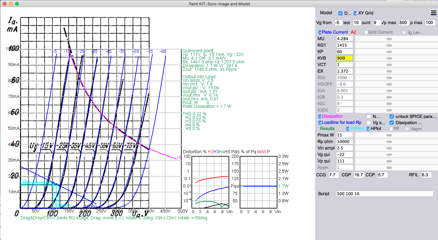

In this specific case
Cgk=7pF+0.7pF=7.7pF (this 0.7pF is socket-pin capacitance acc. M. Jones)
Cga=16pF+0.7pF=16.7pF
6C4C tube mju=4.2 so the gain -A is always smaller than mju and it is about 4 or a bit less...
Dynamic capacitance is Cdyn=Cgk+[abs(-A) x Cga] = 7.7pF+(4 x 16.7pF)= 74.5pF nor more than that for sure...
100ohm with 74.5pF giving the cut off HF at F=1 / (2 x PI x Rgs x Cdyn) = 1000000000000 / 46809 = 21.36MHz
There is absolutely no point to insert just 100ohms Rgrid stopper because it will stop nothing.
With 1k Rgs that will be 2.136MHz
