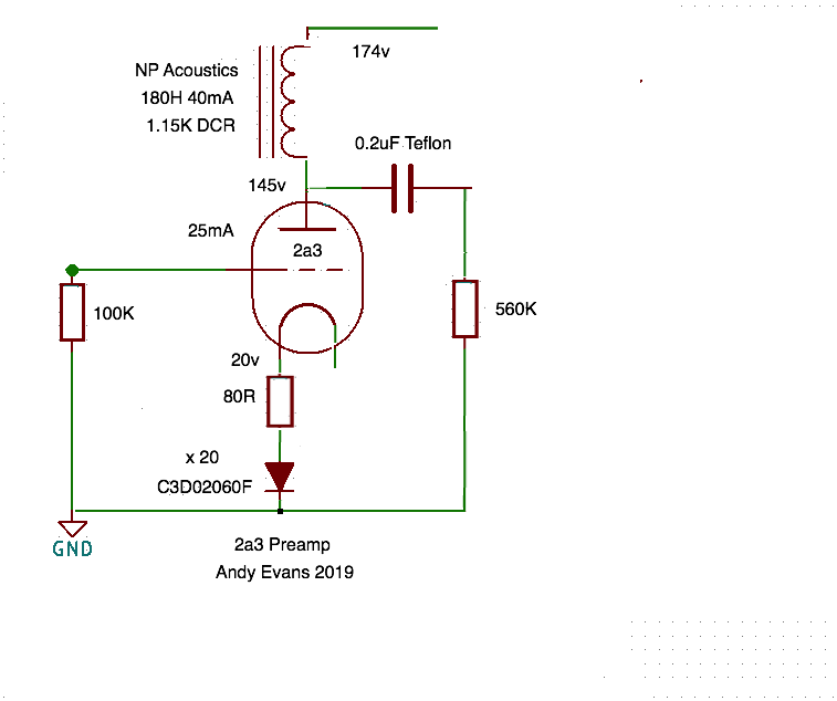

Taking a new look at this older thread, I can see a circuit which seems perfectly viable. It would use SIC diode bias maybe with a resistor thrown in for a bit of feedback. Have a look at this and give me some comments. I was looking at a plate choke design that would feed a solid state amp, and this might do it.

Interesting! Why do you use 20 Schottky rectifiers in series rather than LEDs or ordinary silicon diodes or a zener or even a bigger resistor?
On the basis of using them in my 26 preamp and hearing them in Ale Moglia's 01A preamp, they sound better. Nothing more elaborate than that. I'm using a string of 10. I don't know the sonic effects of doubling that to 20. They aren't exactly cheap, but worth what they cost.
I'd question the use of 2A3 in lieu of other DH tubes which have less input capacities and require less power to heat the filament. Output impedance of 1k (with your resistor bias) or 2k (for example) will make no difference when driving >47k load (or 20k).
71A is a standout for lower input capacities (plural), similar mu and bias, somewhat lower B+ and 1/10th the filament current. Most who have compared 71A and 2A3, power output aside, have found 71A to be the better tube (google).
HK
HK
Hmm - I sold all my 71A except one pair. It is an idea. I have plenty of 4P1L and I intend to try that with SIC diode bias. 2a3 was just a theoretical idea really. Thanks for the post.
One pair could well be all that you need.
160H is about right for Type 26, 2k Rp types require less.
Capacitance comes with that 1k2 winding. If they are gapped right and you still want to try them, use 5k resistor between plate and the choke to decouple this C.
160H is a mismatch for <2k Rp types, if you decided to go with the 2A3 or 71A etc, with the low voltages I would suggest a 1:1 bifilar wound transformer, primary inductance to suit your preference. Otherwise use a choke but be aware of the interaction with any inductive loads; that 0.2uF quickly becomes 2uF, not nearly as appealing and still with issues to do with LF peaking and resonance (ask me how I know).

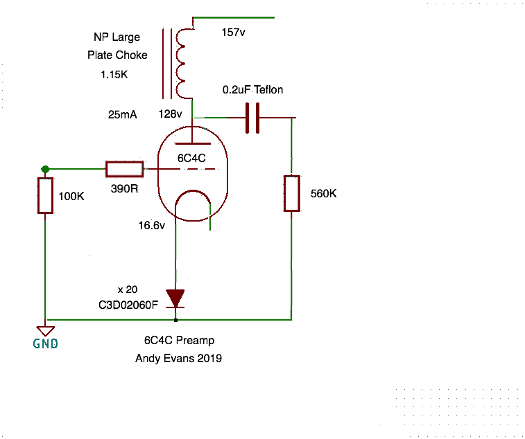

I now have a 6C4C preamp up and running, and listening to it now. Schematic attached. It uses Rod Coleman regs for the filaments. I built this in order to have a preamp stage with a low output impedance, that could drive an average solid state amp if needed.
My usual preamp is a 26 with the same NP Acoustic large plate chokes, so that's my immediate comparison. I right away missed the spark and vividness of the 26 and the lush midrange on vocals. What we have here is a very solid sound which drives my 4P1L PSE output stage well. The presentation is clean with no obvious strain or overload. Sound quality is very neutral, though the balance is a little more towards the bass with less atmosphere and life and fine detail in the higher treble. The predominant quality is smoothness and lack of strain. Bass is well defined.
I'll leave it in my system for a day or two to see how I feel with extended listening. It's a perfectly valid preamp tube if low output impedance is required.

I'll look at the output cap at some point, but the sound is there with 0.2uF. I want to use teflon here, and the Russian teflon caps I use start to get big when you parallel them up. I don't want to compromise on the quality of the output cap.
This isn't filament bias - it's SIC diode bias. If the SICs were replaced with a resistor for 25mA and 16.6v that would be a 664R resistor. I never use cathode bypass caps because I've always found they compromised the sound quality, so that's not a choice I'd make. It could indeed be done in filament bias which is what you are suggesting. When I switched my 26 preamp from filament bias to SIC diode bias I preferred the sound with the SICs. So that was my starting point here.
Yes - I used filament bias for years, but this year I'm using SIC diode bias. I could use filament bias with the SICs but I haven't tried that.
I have plenty of 0.1uF FT-2 teflon caps which I can parallel up if needed. I'll probably go back to my 26 preamp so I'm not throwing the heavy artillery into this preamp just now. I just have to drive my 4P1L PSE output stage and the 26 SIC bias sounds good doing that. I also tried a 4P1L preamp with the same NP plate choke/SIC bias and preferred the 26 in my system. These are all possible choices, though.
I'm quite liking the smoothness of the 6C4C for extended listening. Growing on me a little.
