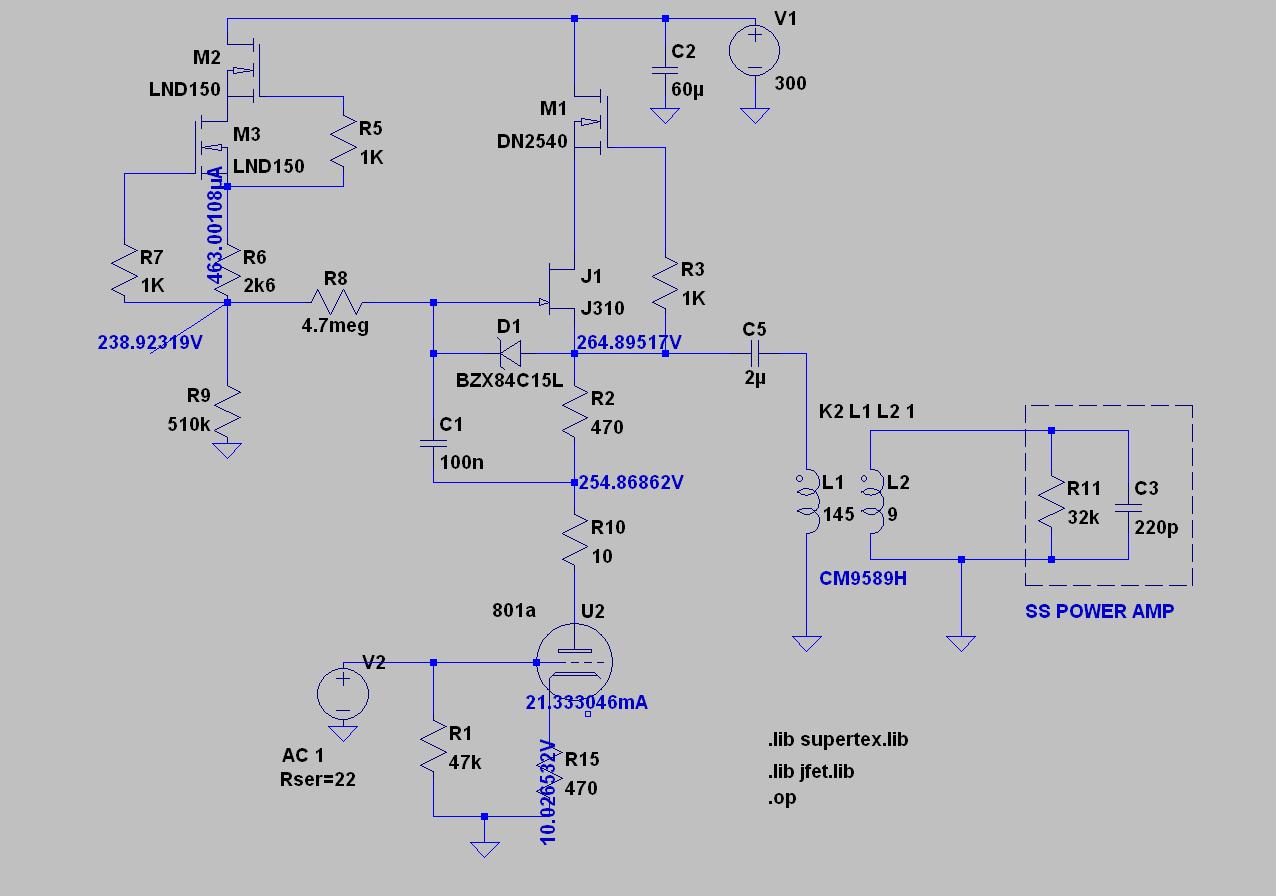

looking forward your comments/advices regarding the following implementation (at the time being on paper only) of Ale's gyrator board with parafeed output.

The little disadvantage is a few dB bump at about 10Hz, due to the gyrator output impedance, the parafeed capacitor value and the OPT inductance.
This will be attenuate with load resistors on BOTH sides of OPT.
Resistors value are between 8-20k, depending of capacitor capacitance and OPT inductance values.
The amplification factor will be decrease (about 1-3 dB) and LF will start downing at about 15-30Hz.
If you use cathode resistor (instead of filament bias) and don't use AC blocking capacitor, the LF roll-down slip upper (50-100Hz). IMHO 100-470uF is necessary.
Hi euro 21,
bypass capacitor is missing since this help to reduce the bump you pointed out. With 2uf cap as pictured the peak is around 0.7dB in the 10Hz area but it becomes almost flat if parafeed cap increase to 3uF. In case of bypass cap, one needs to add the damping resistance on the parafeed transformer but this will increase the output impedance too and this is not my goal (low gain+ low Zout). All this kind of evaluation has been done with the AC analysis of LTspice.
According to this seems no big issues if trying this parafeed design especially with respect to gyrator board operating points. Or am I wrong?

Hi Ale,
according to my simulation the parafeed shows a Zout in the range of hundreds ohm (around 200 ohm) while gyrator mu-out is more than 10 times greater (so in the thousands range). This, in addition to the low gain aimed (6dB is enough) sounded more suited to my needs as soon as it was possible to keep the resonance under control. There is nothing I can add to this analysis due the fact that this implementation, for the moment, is on paper only.
Zout should be 1/gm. The transconductance of the J310 at low VDS will be appalling. When I simulated a similar circuit with 4P1L and BF862 as the jFET, the Zout is close to 95R. I'd expect Zout to be at least below 160R with a J310 as transconductance is 12mS typically and with such low VDS may drop to half at least.
If I were to have the time, I'd traced the J310 on my tester to plot the real transconductance at low VDS.
Running a simulation for a 4P1L with a 30K, distortion is 0.02%.
In my view, forget the parafeed. 30K is a decent load to drive for a mu-follower!
Ale, I measured -live measurement in my 801 preamp- 1k2 at 1kHz (J310 - 01N100D gyrator with 220nF output capacitor).
DN2540 has 140mS G(FS) at 25mA!
I hope at Saturday evening I can replace one gyrator to the same one (containing DN2540).
I will measure output impedance on both (containing J310 and DN2540) channel.

The DN2540 capacitances creep up with VDS<10V:
At 25mA, the GM should be around 200mS, I measured this myself. But this is at VDS=10V, at 1V you can't expect same performance:
However, the rds of the DN2540 falls down into pieces unless you're running it with VDS>1-1.5V:
Otherwise the performance is not great. Alternatively you can try Walter Jung's "impedance multiplier":
I much rather stick to the BF862 (if 25mA) or J310 if Id>25mA.
Your 220nF cap will contribute in both cases around 720 ohms of the impedance at 1kHz.
