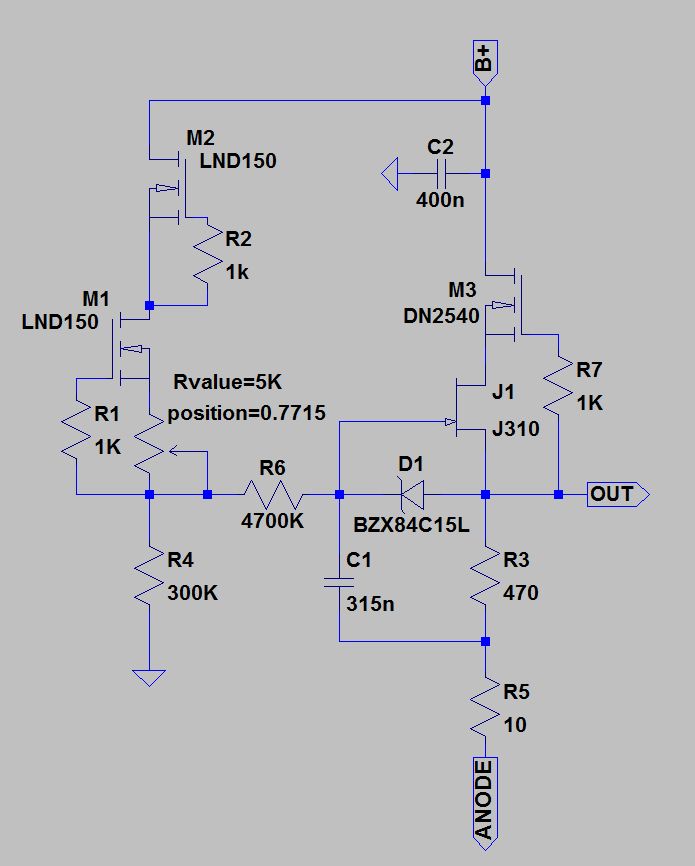

Did your gyrator worked properly from the start? I am trying Ale's gyrator with DN2540 and J310 and I can't adjust the plate voltage. The LND150 CCS works fine and I can adjust the reference. I use a bench HV supply, and as I increase the b+ the plate voltage increases with B+.
I can use a little help.

Hi Radu,
Now I use in my 801 preamp - quasi - fix B+ (simple CLCLC) and gyrators with J310 without any problem.
I tested this gyrator scheme with both (J310 and DN2540) FETs (and 01N100D a "upper" FET) in my test apparatus, but only with regulated B+ (Tomchr's MaidaII regulator).
Soon (at evening -European time- ) I will test it with variable power supply and will inform you.
p.s. I use higher reference voltage -aka greater resistor: 300k), than Ale.
Hi Radu,
It may need some minimum current level, before it regulates, please check that you have some load on the ANODE output when trying it.
