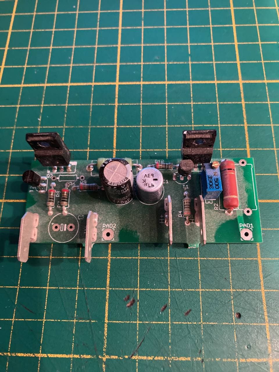

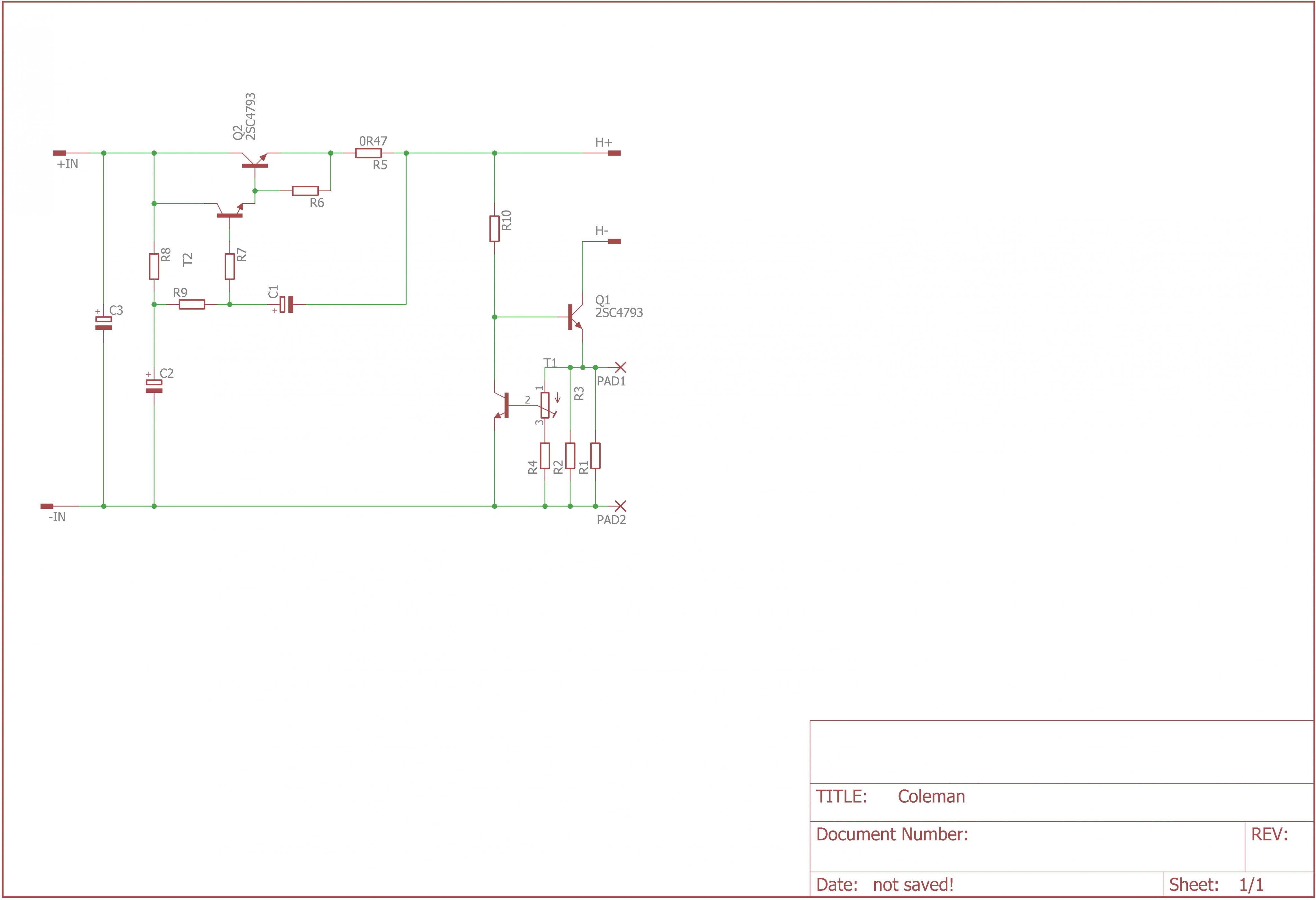

I did a evaluation of some of the publicly available schematics found in Guido Tents topic.
Attached is a picture of one of the quick and dirty prototype boards i did. This was Early 2019 this board was thrown together in under an hour as PCB's are cheaper than Veroboard.
I think i tried some different parts, BC548B and BC550C(Philips because of its low base resistance and noise)
Because i wanted to evaluate the circuit for low current heaters. I found a more linear transistor. The Toshiba 2SC4793 right about 2mA IB in the curves the early voltage is enormous. I also figured i could add a little 5mm pitch electrolytic
This schematic differs from the one i found online, in that it has a 25 turn pot for the current adjustment, i couldn't be bothered to fiddle around with parallel resistors to set the current, i know that this likely increases the impedance of the current source somewhat. But that was besides the scope of what i was trying to find out at the time.
I figured these kinds of circuits where more applicable to battery tube fillaments because those have low enough thermal mass to heat up quickly.
If i recall correctly at the time i thought the thermal stability was rather poor, i tested this whit a hot air soldering station. i think i tried a version where i put a 1N4148 diode in the emitter lead to compensate for the approximately -2mV/K shift in VBE of T1.

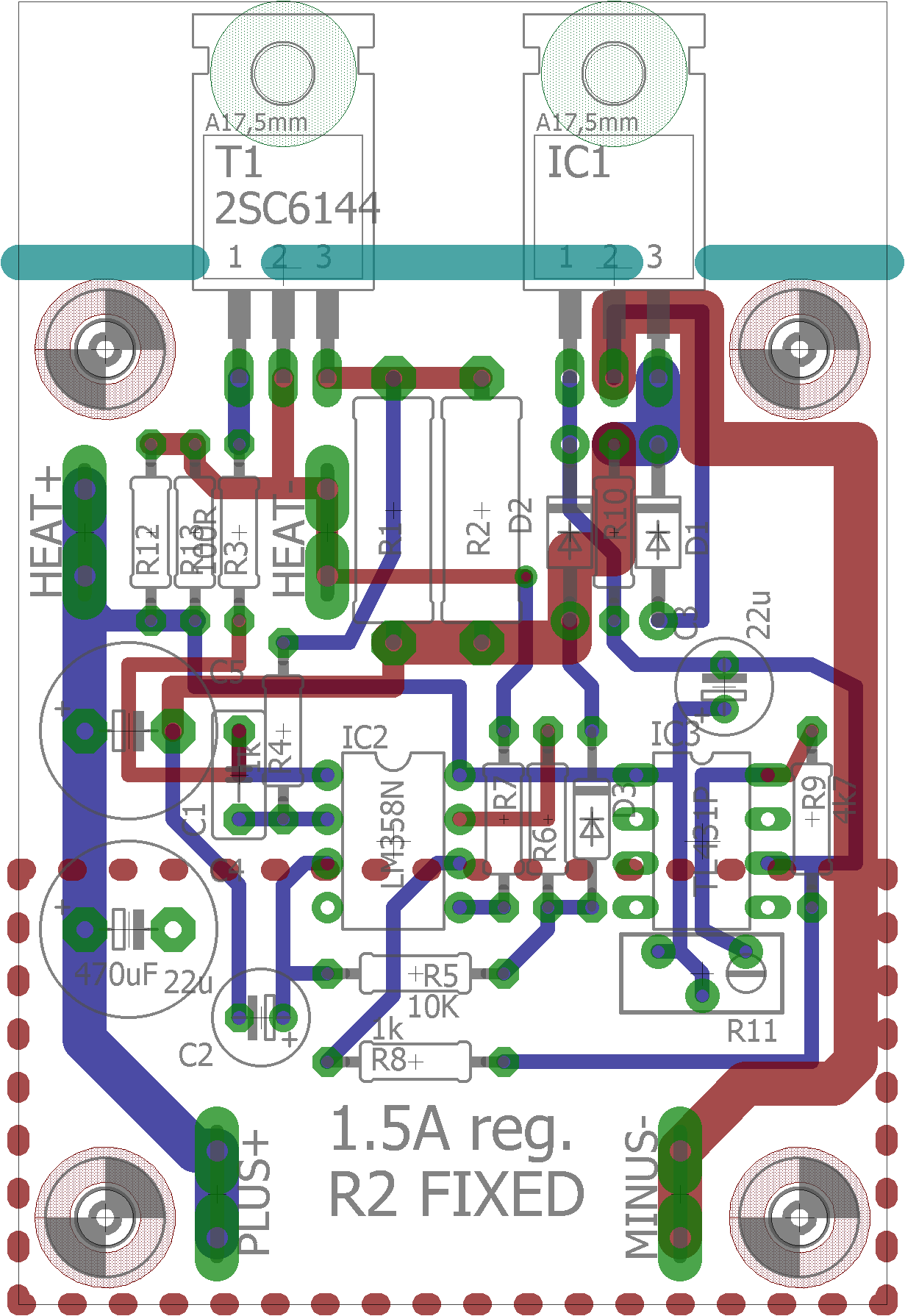

Fixed version.
I found two bugs in the PCB, Appearntly eagle footprints for some parts are just plain wrong, LM337 had pin 2 and 3 reversed, and because D1 was reversed, nothing happened.
Here is the fixed version, Enjoy.
Old PCB's can be made to work by shorting the diode between the adjust and cathode of the TL431.
Remove IC1 (LM337) and Short D1.
That way you cut out the pre-regulator, and are left with a regulator with slightly decreased performance.
  • Gerbers Fixed 1.5A regulator.zip

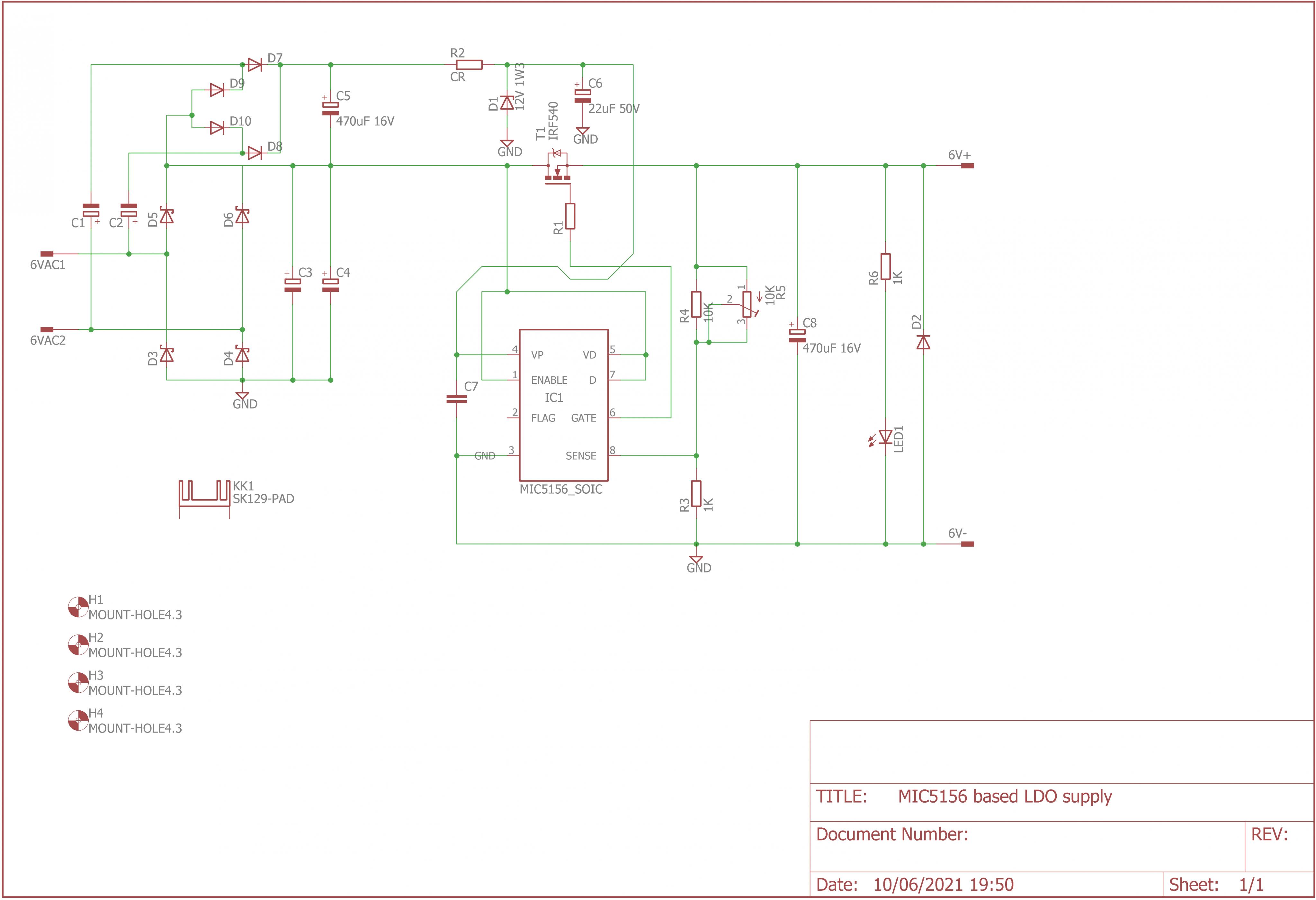

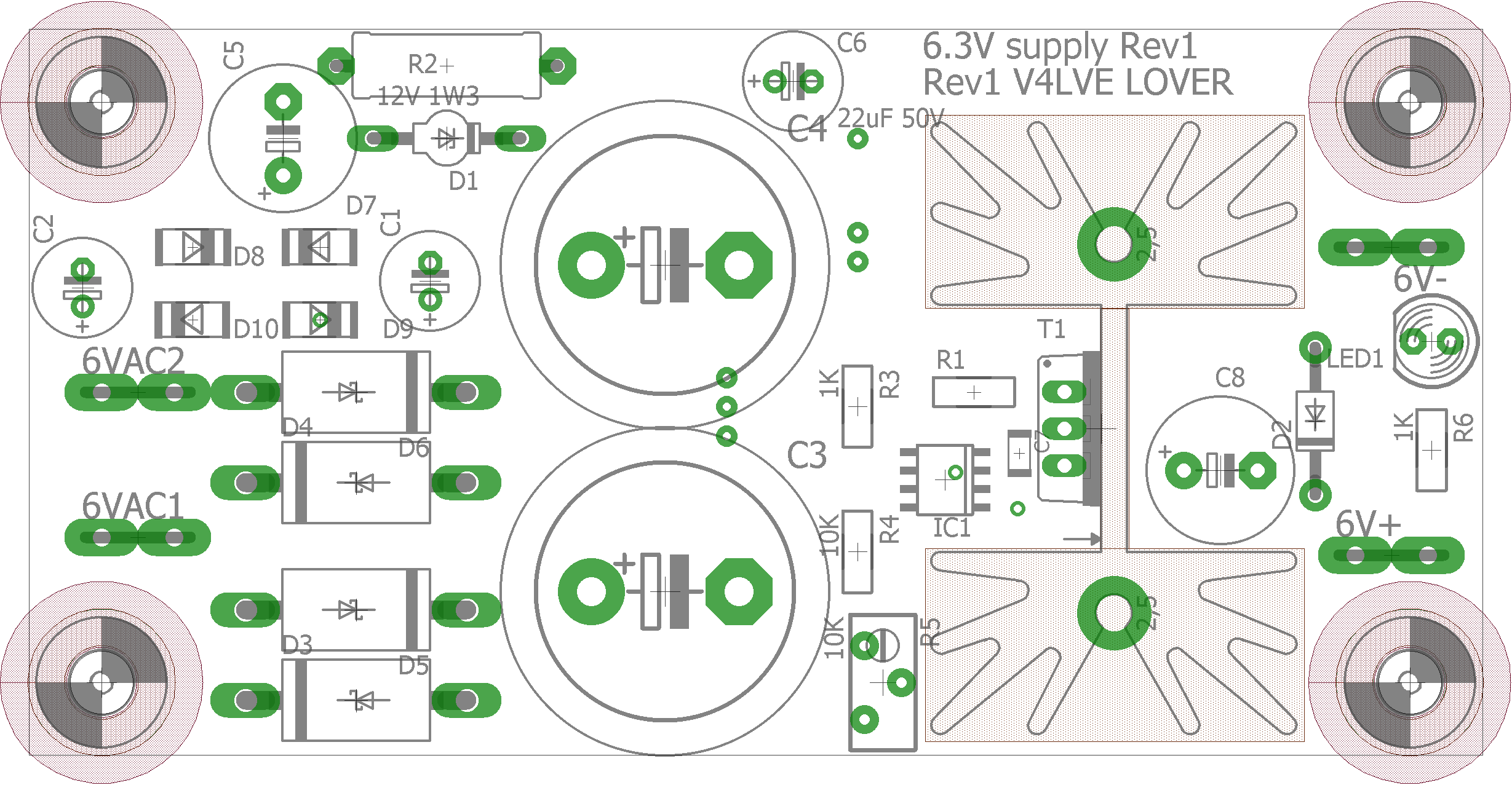

One of which was a low drop regulator that will provide 6.3VDC from 6.3VAC works really well, just a PITA to solder because of all the SMD. Boardfiles attached
