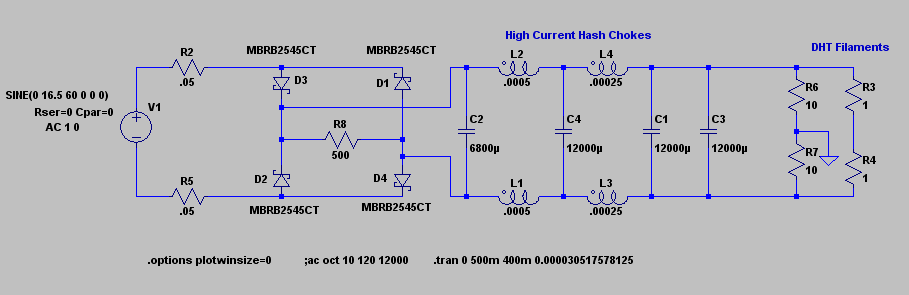

Has anyone used or examined floating plus/minus DC supplies for filaments? See circuit below. The series resistors far right represent an 813 filament (5 amps at 10 volts) with a fictious centre split. Just left of them are two 10 ohm resistors tying either end of the filament to ground for an effective 5 ohm cathode-to-ground impedance. Each resistor dissipates ~2 1/2 watts, increasing the filament circuit power dissipation 10% for an 813, worth the tradeoff for a low and linear cathode impedance.
The hash chokes are off-the-shelf uH Hammonds. The reasoning behind floating the DC supply is that since it's balanced across the filament with no low impedance path to ground the primary audio path to ground is via the 10 ohm resistors. The large DC smoothing caps are effectively no longer in the audio circuit. Spice analysis of the voltage to ground at the fictious filament centre, which should represent the common 'audio' voltage at either end of the filament to ground, is below -200 dB across the band. The result is of course a Spice artifact caused by perfectly matched ideal devices, the real induced noise will obviously be higher but since the filament supply floats relative to ground the supply noise should remain well balanced either end of the filaments and the performance remain high.
uH chokes are shown because I'm trying to make use of a 10 VAC Hammond transformer on hand and can't afford high DCR drops. There's no reason for example a 12 VAC transformer can't be used with higher value chokes for much better noise reduction with less peak current draw. Even so the spectrum from one filament end to ground is still excellent, falling into noise before 1kHz.
Look tenable?

Greetings Everyone, Good food for thought here. There can be two problems with usings an SMPS for tube heating. I have two amps with SMPS heaters - not DHT though. One using 4 EL84s (series parrallel arrangement) is OK as the load is less than half the rating of the SMPS. (about 1.2 amps out of 3.0 rating). The other uses 6L6GCs and was close to 2.3 amps on the same type of SMPS. It had touble starting up. The start up load appeared as a "short" to the SMPS. One brand would start another wouldn't. Worse though, was that when running, the one that did start was putting out high frequency (about 60K HZ) switching spikes. These found their way into the signal path and could be seen at the outputs. I ended up replacing the SMPS on that amp with a conventional DC supply.
