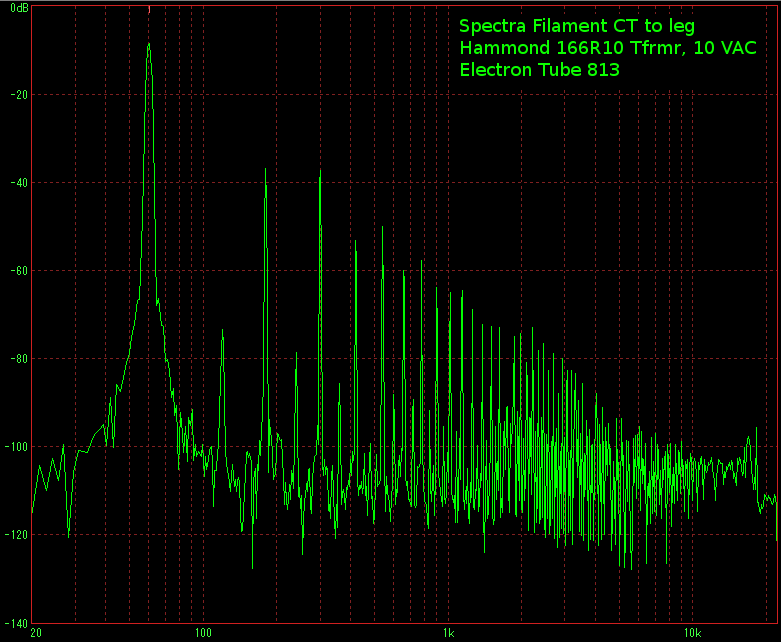

The junkpile finally got large enough for a stab at the SE 813 or 828 in the plans for a couple of years. One of the remaining questions was how to handle the filaments. I started with the simplest and took at wide band look from centre tap to ground of an AC transformer driving an 813. No wonder some claim it has more 'life'. See below. Granted it wasn't hum balanced and some of the hash can be expected to cancel, this is still nasty. With the mains disconnected the measurement dropped to the -140 dB floor across the board so I have no doubt it's the real thing.

Do you think these harmonics are present in the power lines due to industrial loads and/or SMPS? What would you get with a pure sine wave into the tube?
Interesting that there could actually be some truth to the "cleaner power" explanation of why tube amps sound better late at night...

The spectrum above was taken right at the 10 volt secondary of the filament transformer, ground tied to centre tap. A measurement done afterwards from leg to leg was of course 6dB higher overall but otherwise the same. How much of it appears on the plate is naturally dependent on tube and circuit but it's unquestionably on the cathode. As to the cause, I suspect it's the transformer!
Here's why. I benched a very low distortion (0.02%) parafeed headphone amp using a toroidal 240 volt to 20 volt power transformer. The max plate swing into the primary is about 100 volts p-p. Curious how an EI transfomer would perform as an OPT I substituted the same Hammond filament transformer seen here, which is rated 120 volt to 10 volt. Since the voltage ratios are the same the headphone amp plate load should have been roughly equivalent. The distortion shot through the roof and displayed a very complex set of harmonics. The result got me curious about the Hammond in a filament application where it's getting near double the primary voltage and delivering real current. I'll leave it to the black art 'magnetmaticians' to comment on cause but I suspect the core material, i.e. Hammond strikes again.
The standard logic dictates that EI power transformers are preferable in audio partially due to higher internal losses acting to filter power line junk. Toroids are so effcieint and wide band everything passes straight through. As I so often find, the picture is much more complex when a meter enters it. This was intended to be a 'budget' 813SE but now I'm torn between Tentalab CCS filament supplies using these transformers or finding toroid 10 VAC trannies.

The harmonics are originating from the mains and are the result of power supplies chopping of the top of the sine wave. If you chop the top of a sine wave it will start to look like a square wave. A square wave is made up of only odd harmonics and this is what you see in the spectrum.
If there is DC offset on the mains this can also create problems. Not all transformers can handle this which results in harmonics on the secondary, mechanical hum and heating of the transformer.
To minimize the noise on the heater supply I used a Lundahl mains transformer (with air gap to handle DC), a CRC filter and a MachMat VCCS. With this approach I got the noise on the heater down to 0.067mV.
Note: It is important how you measure the noise. If you use autobias the heater supply will float above ground, measuring unbalanced will skew the results. You have to measure the differential noise on the load.

Hi Gerrit. Your 'flat topping' comment piqued my curiousity. You're right, the AC waveform at the filament is highly distorted but I think we're saying the same thing when I ascribe it to a minimally spec'd core. In this case the Hammonds are rated for 8A and the 813 draw at 5A so it's not like it's running on the edge. An 828 draw 3 1/4A and will be tested later today. It might end up an 828 amp instead.
Dang you arend-jan if you're not right. I read your post this morning and took a quick look with a scope at my home service. Not believing what I saw I took a second look at work across town. Still not believing it I investigated the permissible harmonic content of Canadian power utilities. The Ottawa region for example permits almost 9% total with specifications for harmonics to around the 30th! I'm flabbergasted. Something's changed dramatically since I last looked at this at least a decade back, or so I recall, but you were right. The AC on my outlets is a roughly triangular clipped wave, and at under 5% total THD (according to the Audio Precision 1 at work), it's in spec.
I still suspect transformer distortion has an impact on the nature of the distribution, likely the missing 2nd and 4th, however the bulk of the issue is undoubtedly elsewhere. There's no question in my mind AC filaments aren't the best answer.

I've recently taken some harmonic measurements of my service, with similar results. Top of the waveform is chopped off and rounded at the edges. All odd harmonics, of course. I'm considering experimenting with the Sola ferroresonant voltage regulators to try and clean this up. They aren't perfect harmonic filters, but they will improve the spectrum to benefit AC heating, I would think. Will also certainly clean up the noise from the inverter, if one cares to cascade.
Maybe heating DHT's with a ferroresonant supply has some merit - keep running the B+ supply from line voltage, as source impedance still isn't very low.
