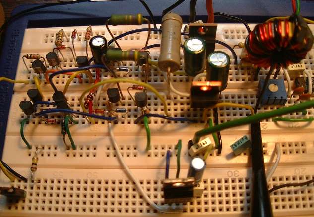

As I mentioned before, I have the circuit running on a protoboard now. I'm using BC546/BC556's, and 2 x IR640 instead of the corresponding components my the PSpice .sch.
See the attachment for a picture of my crummy implementation :xeye:.

Thanks subwo1 - this is it! I added a resistor+13V zener pullup-circuit to the floating supply of the upper driver. This helps get the circuit going much more easily - but it's still not quite perfect. With this simplistic arrangement, the supply voltage needs to be about +/- 25V in order for the circuit to get going by itself...
But when it is going, it does produce sound that isn't displeasing to the ear at low to moderately high levels. (I'm using an old car-speaker to test with, and an sony walkman for the source.)
However, with this simple circuit, there is an issue with bias current to that comparator input, and DC-offset at the output. If I connect the source to the comparator input via a capacitor, the circuit refuses to oscillate at all (again not very surprising). So, for the early trial, I added a voltage-dividing bias supply to the input (two 12K resistors with a 20k pot. in between). With this I can adjust the DC offset at the output to near 0V - but a remaining problem is that the DC offset is not constant against the supply voltage.

Regarding the mosfet timing/shoot-through/ringing, I can offer the following observations from the protoboard implementation:
The switching-frequency is 330kHz. The output waveform (before the filter) looks very nice on the scope - perhaps just a hint of ringing after the output has transitioned from high to low.
Rise/fall times, as observed on the output, are about 100ns, or slightly better.
I do have problems with ringing on the lower gate; when the lower driver goes on, there's a spike, followed by a short pullback almost back to where it began, before the gate goes high for the rest of the half-cycle's duration. Then at the end, I can see the lower gate go low approx. 100ns before the output goes high.
On the upper gate, it looks like it begins going lower some 100ns before the output dives sharply lower, together with the upper gate drive.
A common observation for both upper and lower gate driver is that the "on" current delivery isn't very impressive (but that's by design). But I know I'm using bigger mosfets than what would be warranted by the available power supply (+/-30V lab. supply).
The mosfets do become hot to touch when running at the max. supply voltage. However, not hotter than that I'm sure there wouldn't be a problem if they were fitted with minimal heat sinks, or mounted to a chassis 🙂
