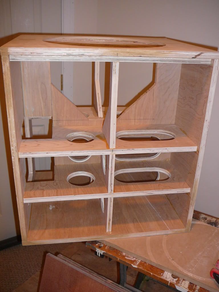

maxx, so I would just look at the build of the parts express 113L cabinet and build a bigger one from scratch out of raw 1" plywood which I would love to do, and could do? I will use the UM18-22 driver as you suggest. What do you think my final volume should be?

Multiple smaller boxes can result in much more even room response than a single big box. They are also a lot easier to build, requiring less bracing. If you are using 1" plywood, dimensions smaller than 2' x 2' would not even need to be braced, but with something large enough for 21", extensive bracing would be needed.
You don't need to "avoid large flat walls", but they require a lot of bracing to keep them from flapping.

It's hard to tell without design it, but i mostly count to guess about 1/5th of the volume as extra for the bracing with this kind of subs, so that is an internal volume of 360L, wich with 1" plywood (25cm for us in Europe) the outside size is about 610x1220x600cm (24"x48"x23.6"). I took sizes that fit a EU standard panel right. This is to give you an id. The actual form of the box is not that important, and even the internal volume is not that critical (read: more or less 300L is good).
About the large flat wall, he means, that if you got large flat walls, you need to brace them to break the resonances and push them out of the passband and low in volume. That means divinding the free surface of the wall in smaller pieces with reinforcements like in the picture attached (not mine, and i don' t know where it came from actually). The space that the brace takes, need to be added to the needed volume of speaker to get the real internal volume needed.

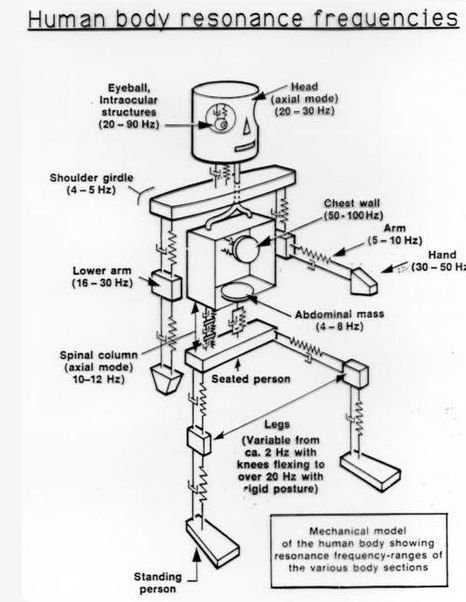

Rattling windows, sound you can feel, and sound that can cause your neighbor to come knocking on the door all occur at different frequencies and levels. The neighbor bit is very dependent on your and their house construction, distance, and how tolerant or aware of sound they are.
The diagram below can give you an idea of the resonant frequencies of various parts of your body, where you tend to "feel" various tones.

I told you one possible size, external measures 24"x24"x48" in 1" thick wood should do it, even including a 1" bracing panel (with holes like in the picture above) every 6" to brake the resonance. But a real detailed drawing is a lot of work that not many willl do for free (and i don't have the tools for that to do a cad).
