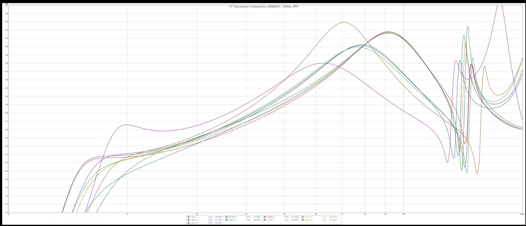

The frequency response chart I posted previously was for the different 21" Devastator options.I am referring to the Devastator 21" by GSG.... I'm just not knowledgeable in audio specifics. I would like the subwoofer to "rattle the windows" and make a sound that you can "feel". I currently have two Definitive Technologies 15" subs and they do a pretty good job however, one of them quit working so I wanted to replace it and still use the one I have left. When I look on the audio forums I see very little information on the Devastator making me think it isn't very popular. (if so, why)
All those Devastator models have 10 dB or more rise between 20Hz and 100 Hz. If not equalized, that rise will make the upper range sound over twice as loud, or bass half as loud, compared to your Definitive Technologies 15" sub.

The GRS Devastators designs all have a large upper bass boost, or looked at it from the other side, reduced low bass compared to most subwoofers which are designed for "flat" response.
"Flat response" when shown on a frequency response graph is a straight ("flat") line, at each frequency from low to high the response is the same. Flat response is a good thing, "what goes in is what comes out".
To have flat response, the Devastator need the upper bass reduced by 6 to 12 dB. If the upper bass is not reduced (the efficiency thrown away) the resulting sound will be "thin", "weak", "anemic" or whatever non-technical term you want to use for upper bass that sounds 4 times too loud, or low bass that sounds 1/4 as loud as it was recorded.
In post #3 the curves on the graph are from various Devastators using the Eminence NSW6021-6 21-inch, one of the driver GRS suggests.
OK, so throw away (reduce) the upper bass efficiency seen on the chart to achieve flat response, or a LF "equal loudness contour" bass boost preferred by most when listening at lower than front row Deadmau5 levels, and all that "efficiency" makes little difference to the desired result.
Notes from the GRS Devastator II below, they suggest a +6 or +12 dB boost (gain) in the bottom.
For most DSP (digital signal processing), the inverse, cutting upper bass, rather boosting low bass would be preferable.
