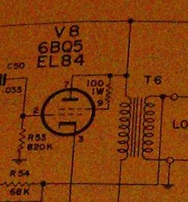

Probably best to experiment. Treat the capacitor as a fixed treble tone control.
So this is essentially a notch filter? Would seem contrary to what little I know (of course, the volumes I don't know outweigh any small insights I think I might have). If there was a full tone circuit at the front-end prior to the power amplifier why would the designers attempt to modify HF output at that stage of the design? Is this what the other fellows were inferring about the cap acting as an oscillation filter? Are you fellows talking about the same thing but saying it differently?😕
No, not a notch but a roll-off. I think I read somewhere that part of the idea is that a simple pentode output produces lots of third-order distortion which can sound shrill, so rolling off the treble can compensate for this (and reduce the third harmonic which a radio speaker might be able to reproduce to a certain extent). Many radio sets roll-off at somewhere around 5-10kHz.
It is possible that by reducing the OPT HF resonance frequency the cap also aids stability, by bringing the OPT phase shift down into a region where the first stage does not produce so much phase shift. Your diagram was difficult to read: what are the feedback component values?
We are not talking about the same thing but saying it differently. We may be talking about two different actions of the same component, but then it might be unclear which action the original designer was after.
Thanks for info DF96...you aren't able to expand the view of the schematic with your browser view zoom?
I'd be really interested in your thoughts about whether this circuit is tweakable, or worth tweaking.

As I said, it appears to be a standard 1950s radio receiver audio circuit, doubled up for stereo. Grounded cathode triode, followed by pentode SE output stage, with a little NFB which probably does not do very much. Probably a few watts output, at a few percent distortion, with a limited frequency response. If you like its sound, use it as it is (at least it won't suffer from crossover distortion!). If not, build a proper audio amp.

And that may be another reason for the hi frequency filter on the output anode; to calm down some shrieky sounding speakers, which were pretty darn common. I have a few of those "hi-fi" console speakers kicking around and they do sound "silly".

I think DF96 has it right, it's just there to take the edge of AM broadcasts, kinda like a Dolby noise reduction of the day, remove the background hiss to make it sound quiet and natural.

Yep, it seems confirmed that those .001 caps are to take the edge off HF's , I just don't see why that wouldn't have been engineered on the pre-amp section of this chassis, which was a stand alone plug-in component. with full tone controls. Bass/Treble/Scratch Filter/ etc instead of the power amp end of things.
The power amp may have been used in different applications, without tone controls, or perhaps the amplifier develops it's own surplus of high frequency content.

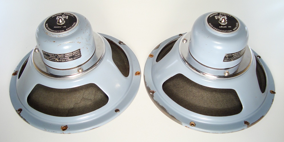

You are the first person I have ever heard mention the R&A's (Richard Allens) Talk about a secret!!!
I have a sweet little blue pair myself, they need repair.
They were my favorite speakers. They need a re-coning, the screw transferred some rust onto the surround and some cracking has developed.
They still sound fine, I just don't want to damage them should some uneven tension develop across the surround, may scuff the voice coil.
Some of the finest speakers to come out of England.

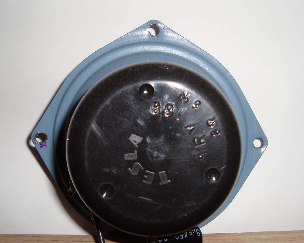

Not to go off-topic on ya, but here are the little beauties.
Another little gem that sound good are those Tesla ARO-666.
Yes an entire other, but interesting, topic paper cone tweeters, I have a set of the Wharfedale Super3's with big Alnico Motors that I think are the cats pyjamas, I have a set of Tesla Tweeters much like yours but blue baskets if I recall.

I agree, and yes I do have a little blue pair of Tesla alnico paper-cone tweeters.
I have tried 6 or 7 other pairs of paper-coned tweets, but these ones stand out from the crowd.
Hard to believe paper cone can make such a "crystal" sound.
They sound much better then they are suppose to, such audacity.

I don't know if this is a Bad Idea, but you could short out those .001uF capacitors between the EL84 pin 7 and B+. Just to see what that sounds like. It might be better, it may well be worse. Just tack solder a wire across it, from one terminal of the cap to the other. Obviously, be careful not to damage anything, and make sure the wire is attached well enough. If the amp sounds horrible that way, remove the wire.
You could also try triode-wiring the EL84's, just for fun. It's a relatively safe experiment, and easy enough to put back to stock if you don't like it. Here's how:
Find a couple of 1W resistors in any value from 100R to 470R. Heck, you could use 1k if that's all you have around. 1/2W resistors would probably be just fine.
Disconnect EL84 pin 9 from the B+ supply.
Connect the resistor from pin 9 to pin 7 on the EL84.
Pin 7 remains connected to the "top" of T6 (the output transformer).
In this case, you probably should short out the .001uF cap from pin 7+9 to B+. Or maybe you can leave it in. I don't know if the value would have to be figured differently (triode operation will change the internal resistance of the EL84, which is probably part of the filter).
Then you'd have a single-ended triode amp! It'll probably only make 2 watts per side, but you might like it.
Next thing you know you'll be dreaming about rewiring the amp with silver wire, or buying Jensen paper-in-oil coupling caps, or scrounging around for motor run capacitors to replace the electrolytics. 😉
I doctored your schematic to show the change.
