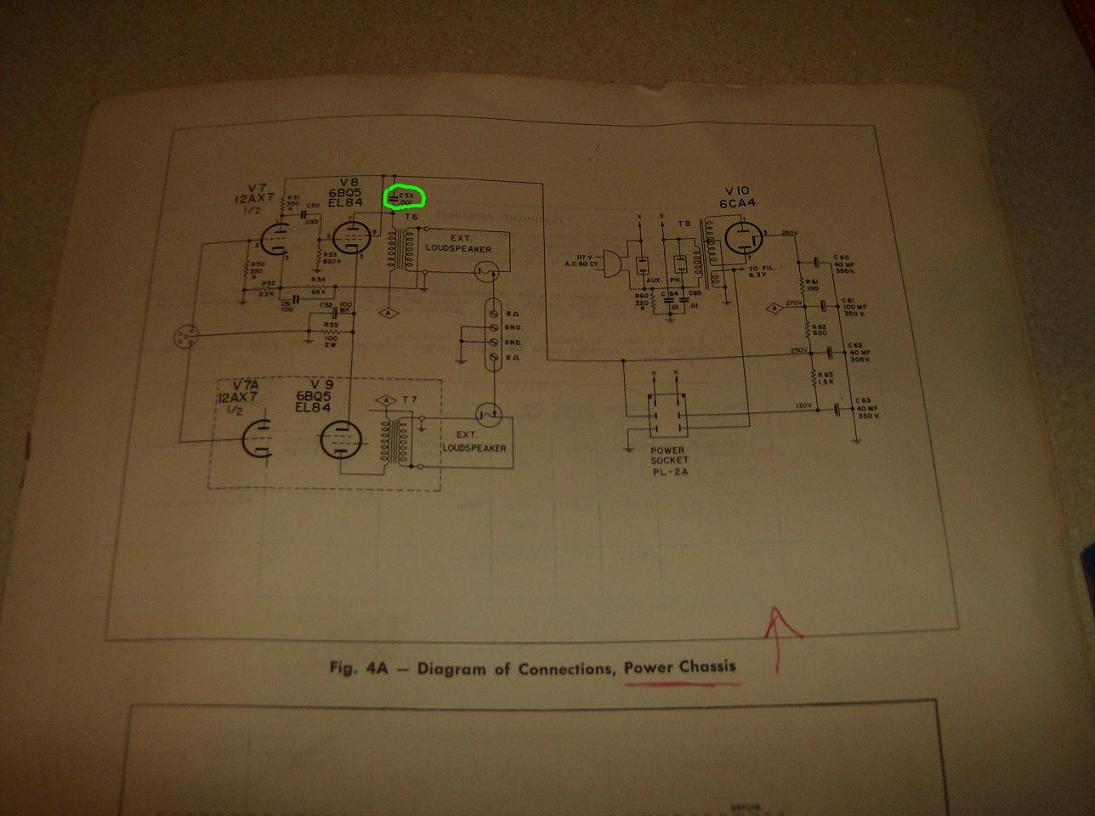

In a parallel thread I started off about the problems I encountered wiring in a volume pot, a question put to me during the course of the thread was: the purpose of a cap (circled in green) on the attached schematic that came with this little SET amp I am attempting to troubleshoot. I checked and it`s not a mistake as they are definitely wired in this way on both my EL84s
If I can`t even wire in a simple pot then you can imagine how far over my head this question is.😕
So any ideas on the purpose of this .001 cap between Pin 7 of the EL84 and B+..?
And of course, if anything jumps out at anyone regarding this particular schematic as being particularly problematic or improperly executed I`d be interested in your observations and suggestions.
Thks in advance. Leon

It's a bit hard to make out in that scan but it appears to be conected between anode of output tube and B+ supply.
My best guess would be to stop some high frequency oscillation.
It could have been connected from the anode to ground but would require a higher voltage cap. Maybe done for cost reasons.

Correct! It prevents the EL from oscillating.
Thanks to you both, now I can return to regular programming and continue troubleshooting my SE EL84...as well as answer the question with proper attribution to both of you, of course.
Just for my own curiosity...if this cap (which presently is one of those small clay-orange ceramic discs) were off spec...ie: bad...any idea of what the sonic signature (symptom) would be?) High pitched squeal?
As I am replacing the caps in this amp I imagine I shouldn`t be sloppy😱 and ensure I replace these as a matter of course as well?

Oscillation probably outside of audible range.
Possible effects could be overheating of the tube and maybe some audible distortion.
Maybe even interference with AM radio reception if frequency high enough.
Ceramic caps are pretty reliable but replace them if you feel more comfortable.

The capacitor ringed in green is for 'tone correction' i.e. HF rolloff. Very common in old radio circuits, as people in the 1950s were not used to hearing much treble. In effect, it lowers the OPT HF resonance frequency. In essence, you have a pair of radio receiver audio stages.
Thanks for the input DF...now as this amplifier had a separate pre-amp/radio chassis with treble and bass pots (which I simply removed from the equation) would I be better advised to remove this particular capacitor to restore (raise) OPT HF resonance?
I intend to use this amplifier with only a volume pot and no frequency compensation.
