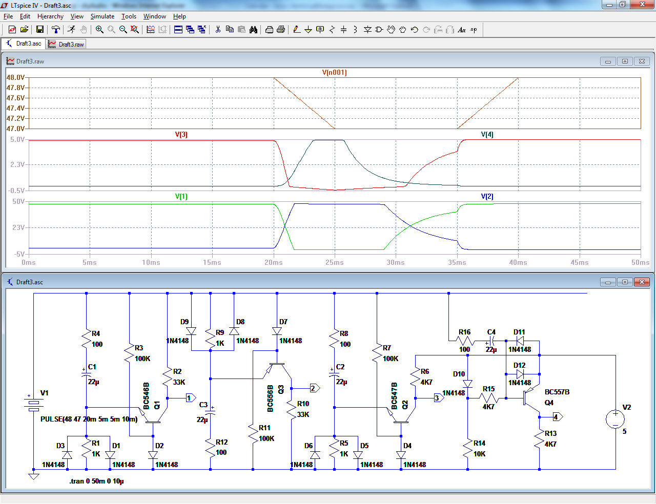

I need to detect when the voltage drops in a battery powered circuit. NOT to a certain voltage, but rather when the voltage quickly sags.
I want/need/require to do this using discrete transistors [NO ICs!] and as cheaply as possible.
I was thinking of a resistor and capacitor [in series] across the power - with a PNP transistor wired;
base to V+ side of the resistor
emitter to resistor/capacitor junction
but no luck...............should I 'tie' the collector to ground via a resistor - say 100K?
And get the signal from the collector that way?
The voltage in the circuit is up to 48V - any risk of blowing the transistor?
Thanks!
Ken

I think what you are looking can do it with a voltage comparator op amp.
Yes, BUT the requirment is NO chips, NO op-amps, NO ICs 🙂
only discrete solid-state - transistors
I tried open collector but got nothing............... 🙁
I'll try connecting the collector via 100k resistor to ground, and see if I get something from the collector.................

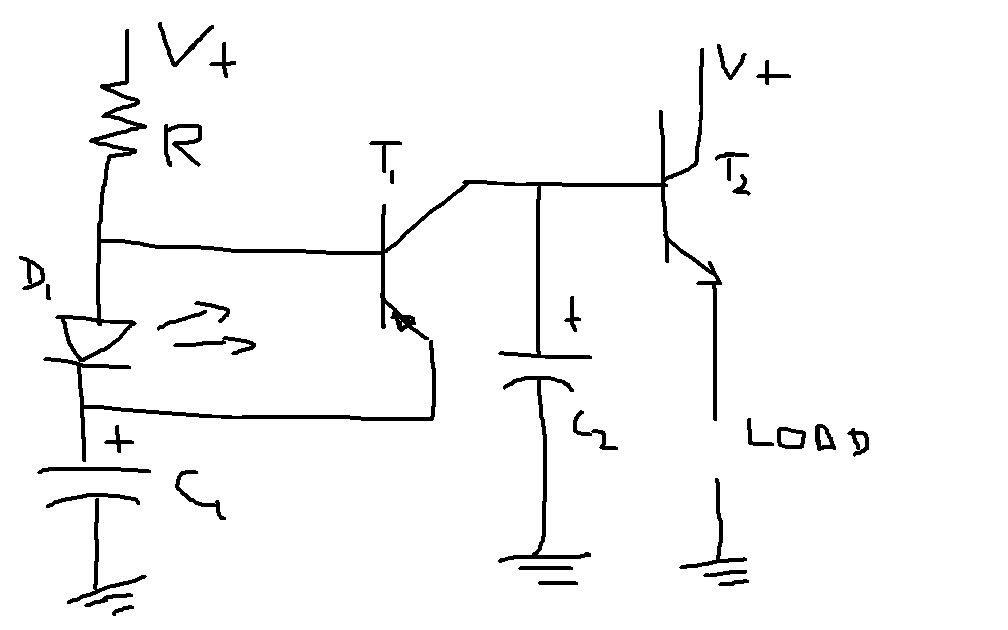

I get the stupid b*gger of the day award
It does work, as I 1st outlined.................some days, one should NOT do electronics!
The LED limits the voltage across T1 BE, and blocks reverse voltage flow when the voltage drops, keeping the V across the cap.
So when V+ drops, T1 turns on and hence T2 turns on - driving the load. C2 stretches the 'pulse'.
'The LED limits the voltage across T1 BE,...'
I feel the other way, I may be wrong.
Gajanan Phadte
Gajanan Phadte
Gajanan Phadte
It does, and for this application it is a good thing. T1 already amplifies the Vd, so anything over [say] 2V is not necessary.
