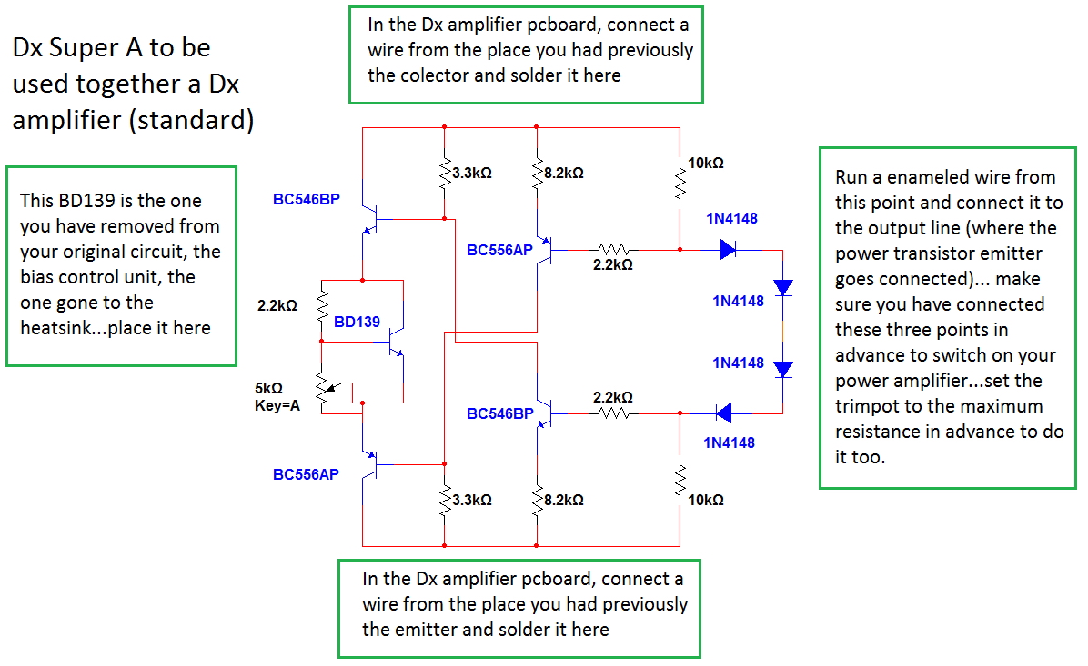

Here you have the schematic from the Dx Super A (JVC modified and adapted)
circuit to be used together the Dx amplifier...the standard one...the first one...this one you see in this thread.
The transistor BD139 is captured and removed from the Dx amplifier..then you gonna use it and also will run wires from the Dx Super A to the pcboard...one enamelled wire (short in length..around 1 inch) will go to the place you had previously your colector (the upper horizontal line of the Super A circuit).... another wire will go from the circuit to the hole you had previously the BD139 (bias control) emitter installed into the pcboard.
The output line (the point where the power transistor's emitters are joined together) goes to the junction of these two groups of 2 diodes... the central point..the mid way.....there you solder into the output of your Dx power amplifier.
Adjust your trimpot to the maximum resistance prior to switch the amplifier on.... you may not need to adjust anything more further.
Caution!
- This circuit was not assembled yet...not tested real life..it may work...but may present problems.... wait to be sure or do it under your own risk....i will assemble and test it for sure.
- Class A operation means 37 watts of heat...this is more than your soldering iron...a hail hot place you gonna have...use bigger heatsinks and or fan blowers breathing air over your output that gonna be really hot...may reach 70 degrées celsius easy!... and with big heatsinks and fan blowers pumping air over it...during stand by mode or at low power the heat will be this way..very hot.
- You may notice that you can listen hum....your supply condensers may not be big enought....if this happens (and it will) then increase your supply condensers to have, at least, the minimum of 20 thousand plus 20 thousand microfarads.
- Attention for the cooling man!.... this thing will be hot alike a coffee pot or a can over the fire ready to cook something..... good to cook eggs..... your enclosure must have holes below the heatsink and at the top of the case... good ventilation is a need...external heatsinks will be good...the original heatsinks used to the Dx amplifier may not be enough
- if you perceive sound warm and looking that has a small loss in the high end..do not worry.... this is a class A characteristic, but for sure the audio will be more clear and detailed at low volumes while you will be operating class A
I do not like, nor appreciate Class A...doing it because people want..doing it because everybody knows that transistor crosssover distortions are reduced.... because everybody believe it is superior....doing not for me..doing for you.

Doesent this just provide a non switching output stage rather than actual class A ?
All these AA, SuperA and similar techniques are refinements of ClassAB. They are NOT ClassA operation.
Simply controlling/telling the OFF device to pass an almost constant, near zero current does not make the push pull output stage operate in ClassA.
Yes....but works great...and as always, we have some power under
Class A biasing...or high bias class AB..well.... you understood.

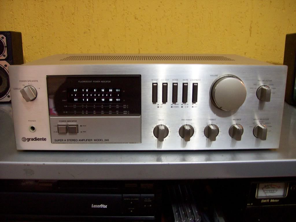

There's a thread about Super A in our forum, and there we have several schematics to see.
I am posting the one from Gradiente that was a very sucessfull unit down here...tilll our days this equipment is sold by a very high price to audio fanatics because of sonic performance.
This schematic was sent to our forum friend, Jan Dupont from Denmark few years ago... and from time to time i have posted some comments about it as i deeply appreciate the sonics of these units... originally JVC and adapted to the "brazilian taste".
This amplifier was produced in Brazil 35 years ago.

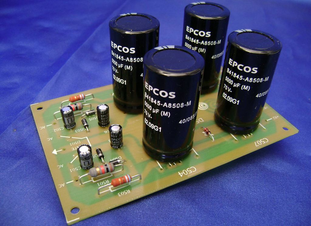

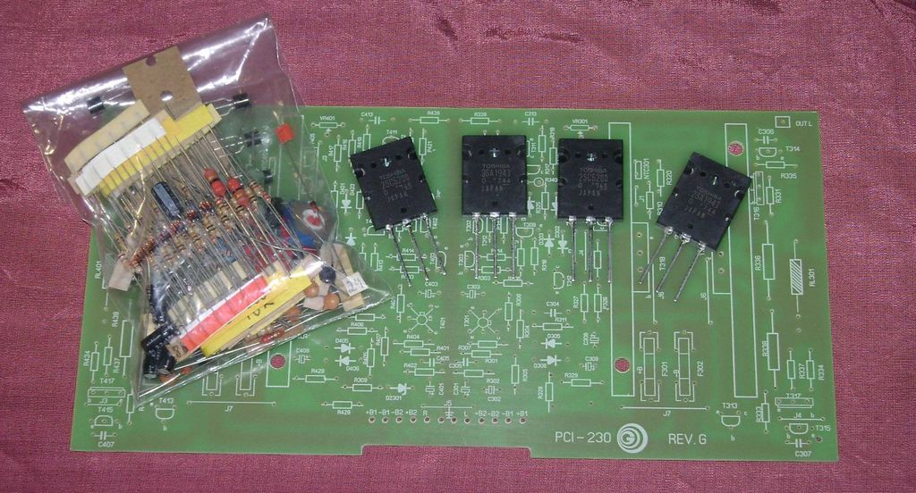

This Gradiente is deeply famous.... i have a sister in Brasilia
that has one.... looks new..works great till today....it is connected to giant speakers from Sony (Sigma 15) and from Gradiente (Master 200)... sounds good.... a little bit warm sonics.... a little bit muffled in the high end as usual in class A (i do feel this way...my point of view).

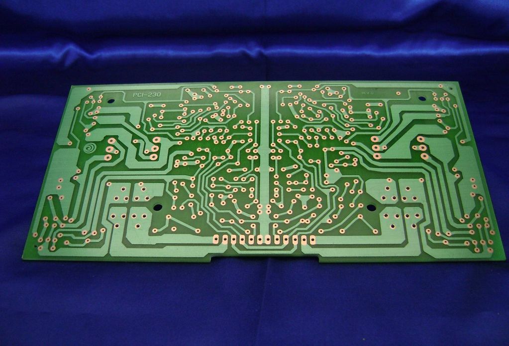

Last year i could see someone selling copies from the original pcboards from this Gradiente to the ones had the intention to fix old sets... Gradiente is broken and shut it's doors several years ago..no more Gradiente here in Brazil.
These boards was found to be sold in the Brazilian free market (Mercado livre)..something alike Ebay...and last year the guy was there selling.... a fanatic about the brand.
regards,
Carlos
Very nice.... a friend called Herman sent me these files
Great..... a very nice cooperation..... very good Herman.
Thank you.
