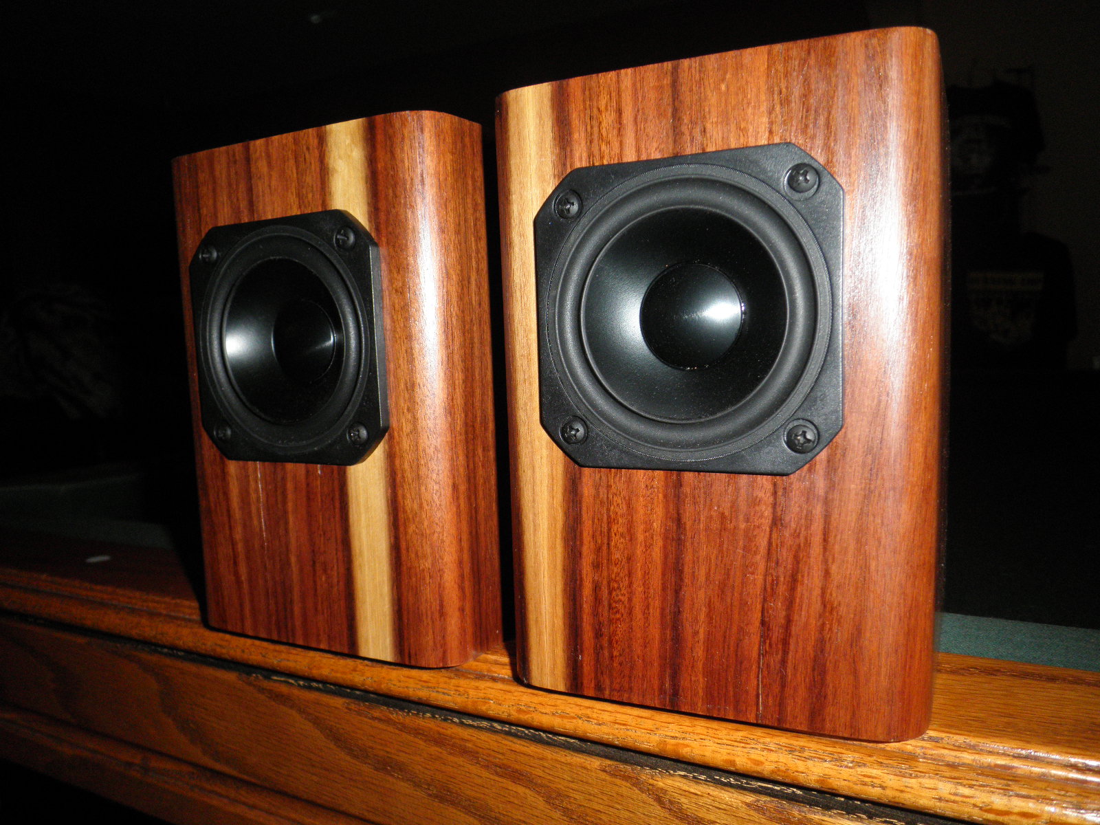

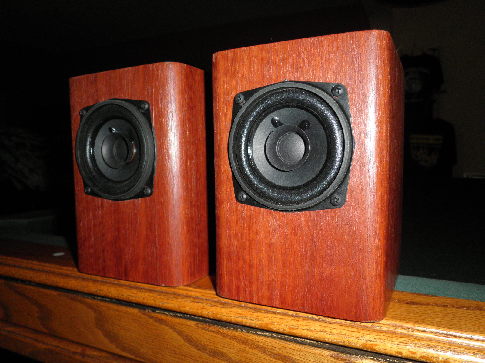

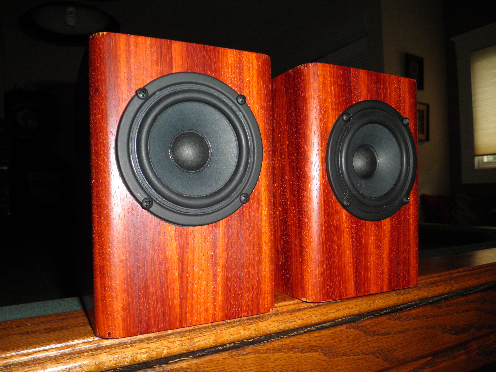

Wondering how small could diy PC speakers be and still do the job, I gathered three pairs of 3" full-range drivers expected to do well enough in aprx 1-liter (70cm^3) PE mdf sealed/stuffed enclosures and experimented.
Veneer left-over from previous projects was used to finish, from left to right, Peerless 830987 in rosewood, Aurasound (I don't recall the model but were on sale $6 about a year ago) in padauk and Hi-Vi C3N-III in jarrah. I listened with both a t-amp and a PP el-84.
By far and away the Peerless sounded best, and maybe should have at $25 and more than twice the price of either of the two other pairs. Surprisingly good for such tiny cabinets really...clear highs and mids, sharp transients, strong bass/punch and relatively high SPLability.
It was hard choosing between second and third. Without woofer help, though, the Hi-Vis get the edge for a fuller bottom end. With a subwoofer I preferred the Aura's with nicer hi freq detail.
