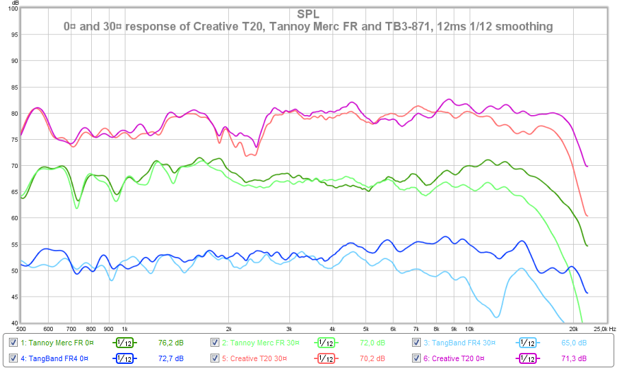

Here I compare three different desktop monitor's upper response range. Each has a different type of tweeter. Same measurement procedure, calibrated mic, REW with 12ms gating, 1/12 smoothing
The width of the tweeter is really important factor! Look at 0¤ and 30¤ diffrence at 5kHz/10kHz/15kHz
Red - Creative T20 - ½" dome tweeter
Green - Tannoy Mercury FR - 1½" dome
Blue - TangBand W3-871 - 3" dome with phase plug (6kHz notch filter)
This is the general picture - there are exceptions to the rule of course!

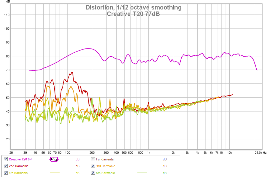

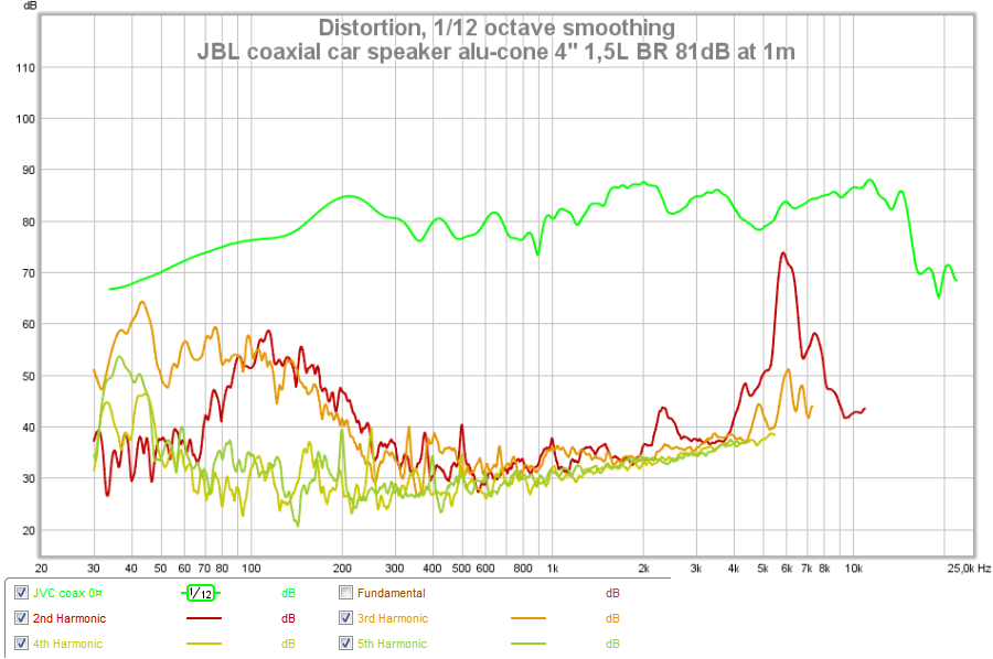

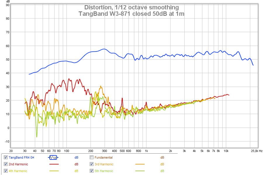

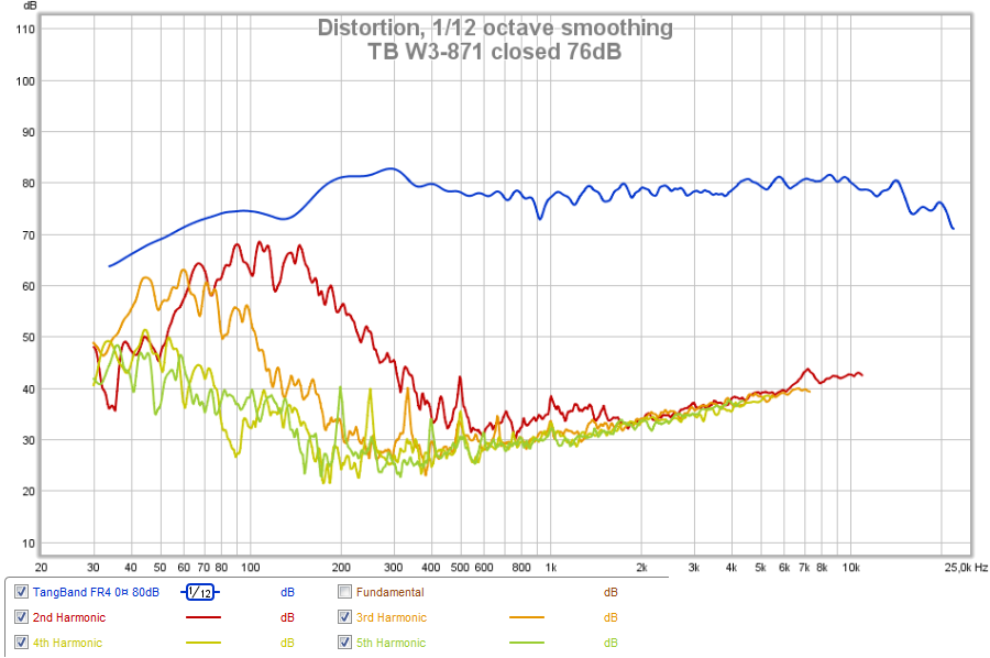

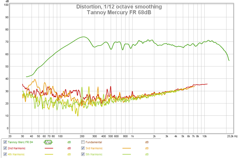

Another perspective is distortion of bass. Small drivers are in trouble at 80dB/1m below 300Hz.
Sorry, spl levels are not matched.
Now you may find out why I like Tannoy most of all!
