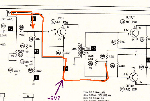

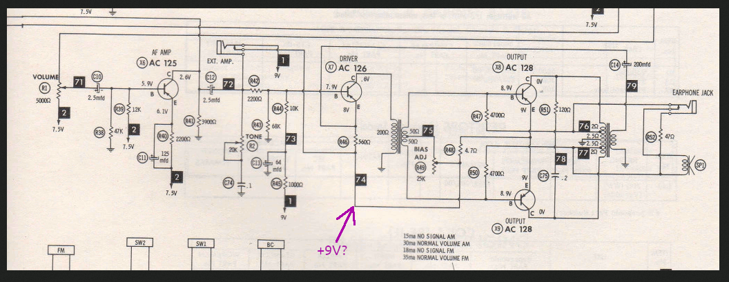

The schematic of the "Deacy" amp contains an error (I notated it in pink in the attached image), and also shows that there is a little negative feedback via C14 and the extra secondary winding on the output transformer. You can bet your boots that it was only a very small amount of negative feedback - a few decibels - in order to (a) not throw away too much precious gain, and (b) maintain stability with two cheap transformers inside the feedback loop.

No error. Point 74 is fed from point 1 via a jack. It WILL be 9V unless you poke a plug (not normal operation).The schematic of the "Deacy" amp contains an error (I notated it in pink in the attached image)
Yes the drawing suggests an error but it is just not drawn as clearly as we would wish.

Okay. That's not visible in the only reasonable image I found of the circuit, the one I posted. But that image has been cropped quite a bit (not by me).No error. Point 74 is fed from point 1 via a jack. It WILL be 9V unless you poke a plug (not normal operation).
Do you have a more complete version of the schematic that shows this connection between point 74 and point 1?
I did find a second alleged schematic for the Deacy amp - that one was riddled with mistakes, so I discarded it after a cursory glance.

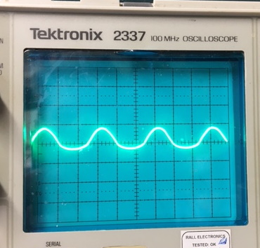

In the absence of negative feedback, due to the tight exponential current/voltage characteristic of a transistor, distortion is very high even for quite small signal voltages.
For very small input voltages, a rough rule of thumb is that you will have 1% THD for every millivolt of input signal; i.e., 1% THD for a sinewave input with a peak value of 1 mV, and so on. Remember that a 1 mV signal is really tiny.
For bigger input signal voltages, the rule of thumb becomes increasingly inaccurate as the signal voltage grows. I've worked out the mathematics that predicts the THD at any input signal voltage (not just very small voltages), but that bit of math is too complex to post here.
The good news is that, while the THD is complicated to calculate, it is very easy to plot the predicted output waveform, and let you see for yourself just how much distortion is created. The output waveform is very far from sinusoidal even for quite small input voltages.
As an example, the attached plot shows the predicted output waveform for a sinewave input signal with a peak voltage of 26 mV. As you can see, the signal is quite heavily distorted. This, remember, is for an ideal transistor with no negative feedback at all, in common-emitter mode, at room temperature.
Modern silicon transistors are close to ideal. Old Ge transistors were less so. For a leaky old Ge transistor, the actual output voltage wouldn't be exactly as shown in the attached figure - but it would be pretty similar. A signal generator, an OC44, and a 'scope would tell the truth.
To put it in perspective, even low-output single coil guitar pickups, on a guitar played with a light touch, will easily put out 26 mV peak voltage. So we can expect the OC44 inside the Dallas Rangemaster used by Brian May, to have been producing as much, or more, distortion than shown in the attached plot.
There is a reason why I chose the rather odd value of 26 mV, by the way. This number equals the constant (kT/q) at room temperature, where k is the Boltzmann constant, T is the temperature of the transistor in Kelvin, and q is the magnitude of charge of an electron (the elementary charge). The term (kT/q) plays a direct role in the transistor equation connecting collector current to base-emitter voltage. It is sometimes called Vt in electronics textbooks.
One thing we didn't discuss earlier in the thread, is that the Dallas Rangemaster has quite a low input impedance. These days it would be considered quite unacceptably low for a guitar input. But the low input impedance will have the side effect of drastically reducing treble response from the guitar, which probably contributes a lot to the smooth distorted sound - without harsh distortion - that Brian May became famous for. Transistor-based versions of the Big Muff Pi (guitar overdrive / distortion pedal) had the same low input impedance, and originally became famous for what was then perceived as smooth, creamy distortion.

Am I blind? The connection is visible to me in the image YOU posted above.That's not visible in the only reasonable image I found of the circuit, the one I posted.
