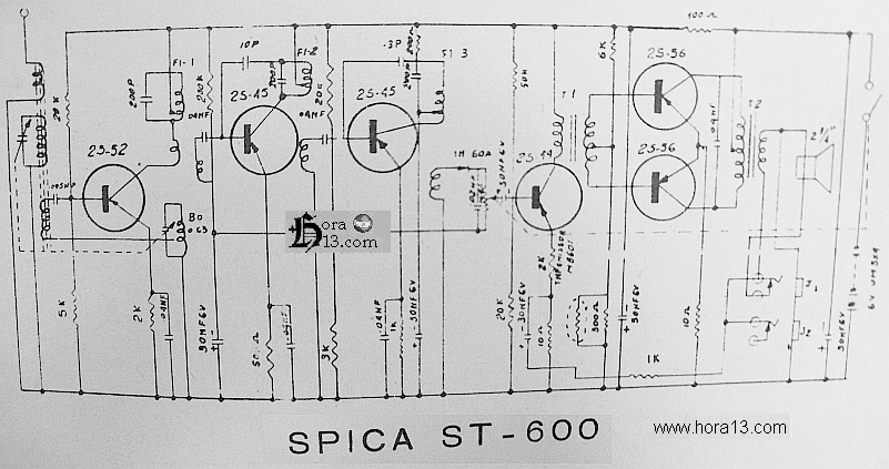

most of us might know the »Deacy« amplifier that John Deacon of Queen had built from an old radio and which is responsible for Brian May's signature guitar sound. It's main features are the germanium transistors used in any stage and it's transformer coupled output section. Even phase inversion was done with a transformer.
As there are many Ge transistors in my stashes, I have the idea to design an amplifier with these features. I think the math can easily be done for the output transformer, but I'm completely lost with the PI tranny. How do I calculate the power transistors' drive power demands and the winding ratio?

GE Transistor Manual. Almost any edition.How do I calculate the...
You could measure the drive requirements for your output transistors. What matters here is large signal input impedance. The change in applied voltage divided by the change in base current gives Z. Rig up a jig to physically measure the required quantities using a dummy load resistor and your supply voltage. Static DC measurements are fine here. I get about 20 ohms for most of the ones I’ve played with, but those include some degeneration (the usual emitter resistor values). Turns ratio on the trafo would depend on what you drive it with - what kind of voltage you have available in the driver stage. You typically want it capable of somewhat more voltage swing than you need to drive your outputs to full current, because you also have to charge capacitances with it as frequency rises and that steals drive power.
Remember driver transformers were typically fed from a class A single transistor so you had important DC through primary, so driver transformer is larger than expected, must be gapped to avoid saturation, etc.
So not as easy as it looks on first sight.

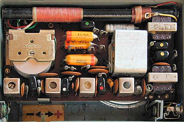

Driver transformer was as large as the output one:
The off-the-shelf split secondary transformers available nowadays don’t like ANY DC in the primary. I tried the little Hammonds driving Ge totem poles - and even though advertised to handle 56 mA of primary current they start saturating at about 4. Couldn’t generate enough drive with only 4mA. Worked ok AC coupled off an emitter follower - but that deviated from the classic design. You probably end up winding your own. Somewhere I saw some “instructions” on winding these up starting from 10 to 20 VA EI power transformer cores.

I've also observed in old transformer coupled transistor radios that both trannys are of the same size, and I'm well aware to do the winding job by myself. Luckily, due to the low impedances I don't expect it to be as hard as winding tube OT's.

Almost any of those Japanese pocket transistor radios from the 1960ies and early 1970ies used a pair of transformer coupled PNP germanium transistors, probably 'cause it was a proven technology at the time, and even more probably 'cause it was still cheaper than a PNP-NPN complementary, which became available and usual later on.

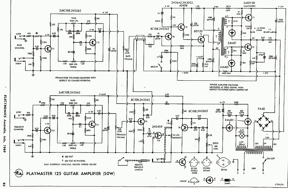

FWIW
I had a PM-125 interstage transistor amp (2N3055 based). Sounds good on paper. Utterly gutless (and soul-less) in reality. 50W that sounded like ten and weighed as much as 100.

That’s 2N3055 for you. Especially 2N3055 driving 2N3055. Not enough current gain - the Ge’s tend to be better about that. A much better implementation that I have seen is one with darlingtons (a decent driver on each 3055), being driven by the trafo and a better single ended class A stage running at a lower current.
