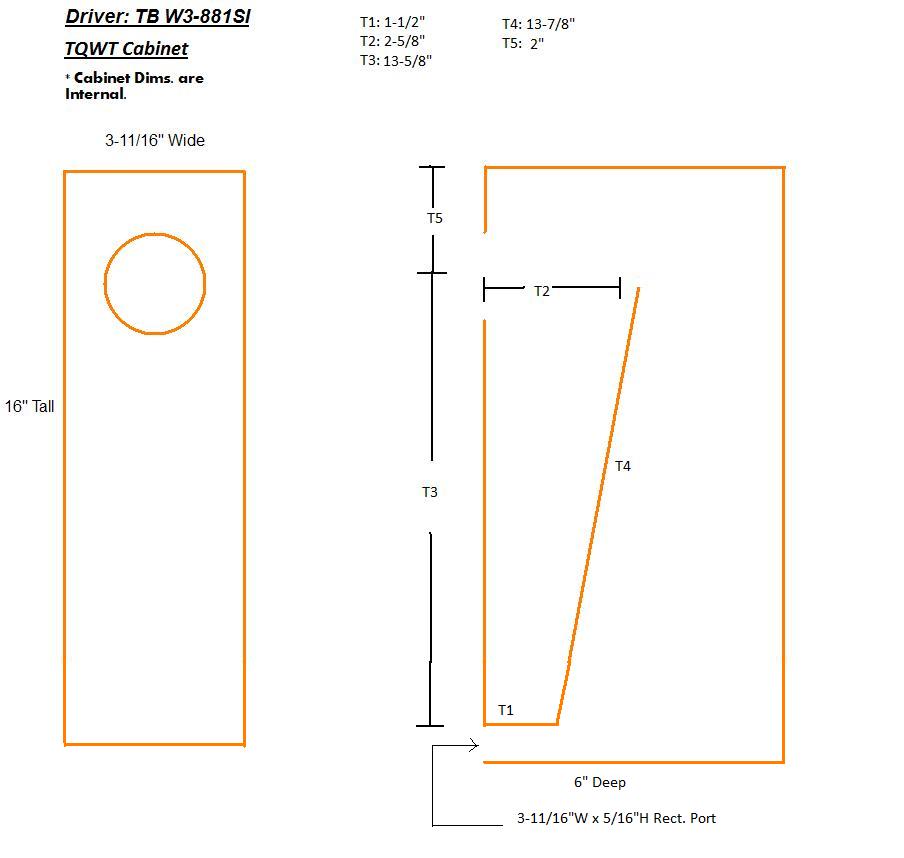

It's the same subject, so I hope is not a thread hijack...Anyways, all my DIY projects have been copied from proven designs (ie. uFonken), OB, and BR enclosures. In order to learn other type of enclosures, I started reading on TWQT, and did a simple design, which I will make of Foam Core to try it. The W3-881SI is the driver for this design. My question is on dampen. Should I line with wool, and if so where? Or, should I use polyfill only (T1 area I would gather)? Or, should I use both? BR I just line completely, but not sure about TWQT.
