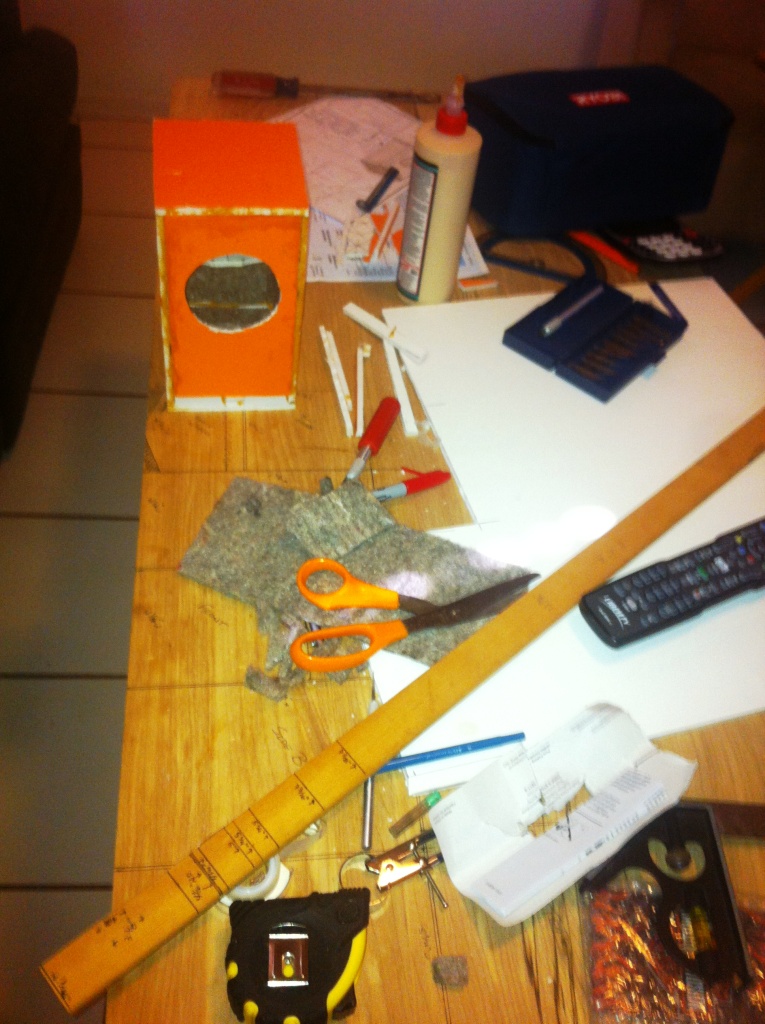

Not the prettiest, as it is my first foam core build. It is 3/16" thk. foam core. I have some old X-Acto "imitation" knives, so the cuts were not the best. Later I found out that 3/16" foam core easily cuts with scissors, so next one I might use a good pair of really sharp scissors I have. I also had a cheap-o compass to mark the circle for the holes, my good one is nowhere to be found. So, the hole for the driver is not the roundest, but within specs. I learned a lot, hadn't use foam core since my college days, there are some small gaps which I will correct with some kind of filler (wood, spackle, caulk, or silicone). They will be primed and painted, so they don't look so bad. The table is actually the 12 mm x 2' x 4' baboon plywood panel from which the final enclosures will be built. You can also see the felt used to line the inside of the enclosure. There is no picture of the other one, as I'm in the middle of cutting and gluing it.

Guangui,
Thanks. A sharp razor is the best for clean cuts. Scissors crush the edge. Cut in several strokes with the first defining path and go deeper each time. Very clean that way. How does it sound?
Tried the scissors, and yes they crush the edges. The X-Acto knives I have cut well, but in some areas they kind of rip the foam. I have plenty of razors, should have thought about the obvious before.

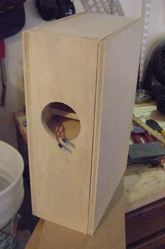

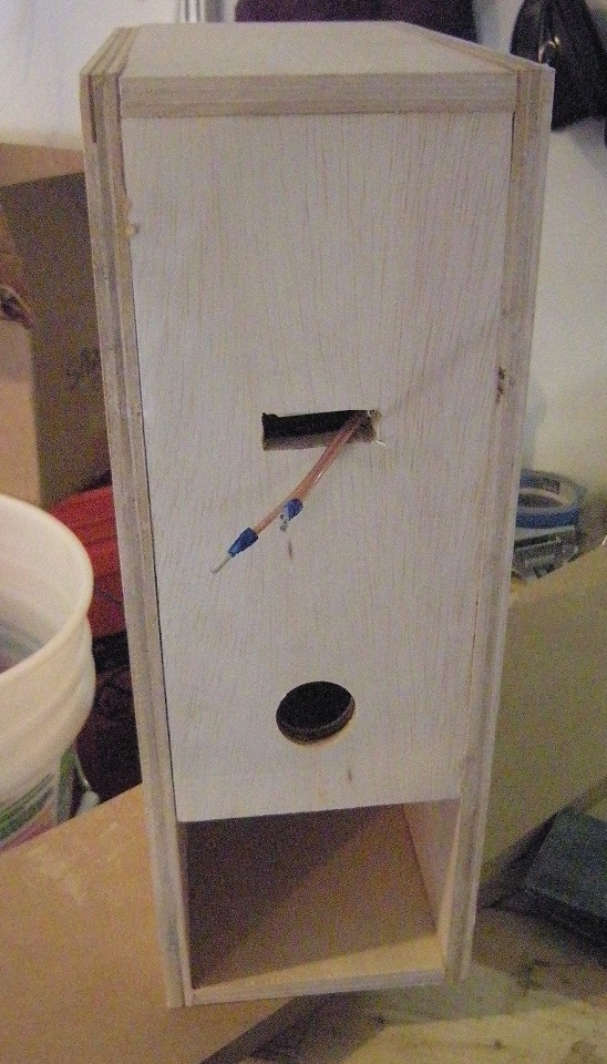

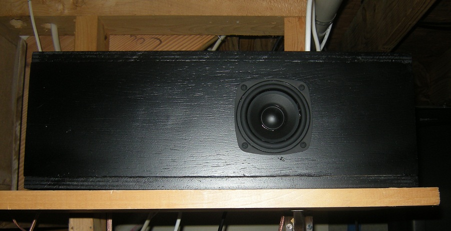

I have built two different speakers with the TANG Band 3" full range drivers
My favorite is the Del Sol at the following URL
DelSol - Aura NS3-194-8E - Inexpensive DIY Fullrange Bookshelf Speaker
The site has the complete plans and my version the sounds great to my ears with a surprising level of bass and great midrange. There is a lot of build experience with this speaker design on the internet. My cabinet did not have any damping material on the back.

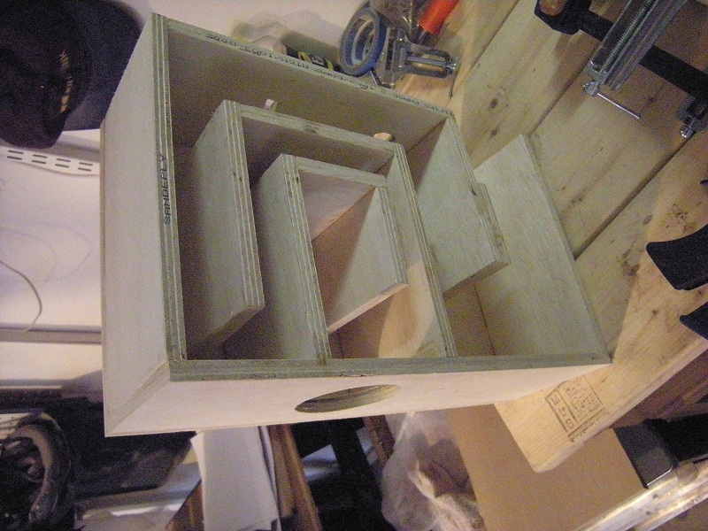

I also built a folded horn version. Which was a challenge for my limited wood working skill. I would get some advice on stuffing the cabinet. I only stuffed the main speaker chamber, but I did not really know what I am doing and did not test the speaker before final assembly

Sorry no measurements on either finished speaker.
Good Luck!

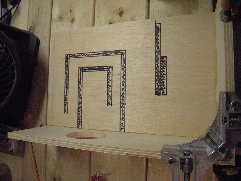

Very interesting responses since I last checked. Thanks for the practical feedback. I especially like the examples gychange and bigberts. Great stuff.
Bigberts, what is the purpose for all the maze of tunnels in that one you posted? I've seen people doing this, but I have not heard about the theory behind it. From a simplicity stand point the DelSols look very practical.

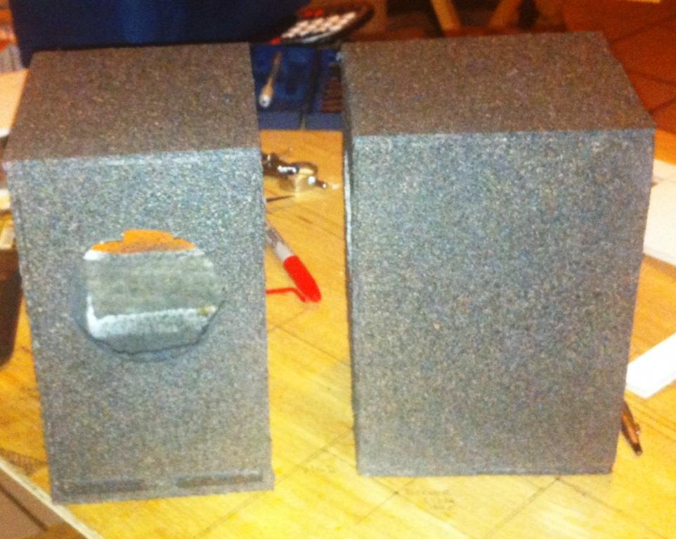

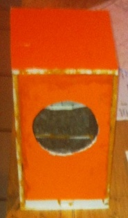

Here is the semi-finished enclosures, waiting on the W3-881SI drivers, as I just ordered them today, also ordered banana terminals for the back. In the order there is a pair of W3-1364SA that were intended for this enclosure, but if the 881's do the trick ($9.90 vs. $37.89) they will stay in the enclosure, and the 1364's will be used in another project, or in a wood uFonken cabinet. Rookie mistake, I forgot to do the holes for the terminals, but nothing that can't be fixed easily.

What you see with the maze of tunnels is referred to as a back-loaded, folded horn. They are complicated to build, yes, but even more complicated to design properly.
Most (good-sounding) speaker cabinets are carefully designed, with quite complex mathematical calculations that can be assisted greatly by various computer software. The reason why many of us just use other designs is because most of us do not have the knowledge/experience and access to software and/or design tools to do it right. Or, we have access to all the knowledge and tools but we are just plain too busy or lazy to learn.
Two types of cabinets are relatively simple; 1) sealed and 2) simple bass-reflex.
Some simple free design software can be used to design half-decent sealed or bass-reflex cabinets for almost any driver. One of these programs is called "WinISP". You can download it and try it. It is simply a matter of creating a new entry in the driver database for your driver and then entering the T/S parameters. Then you just start a new project, choose sealed or ported (bass reflex) and then start playing around (or just accept the default box that WinISP comes up with).
Back-loaded horns, mass-loaded transmission lines, TQWTs, etc. etc. are much more complicated and the learning curve gets very steep, so at least in the beginning it is likely best to use proven designs by the experts. You will soon learn who those people are around here. I am not one of them, but I have been around long enough to know what I am capable of, and what I need to leave to others.

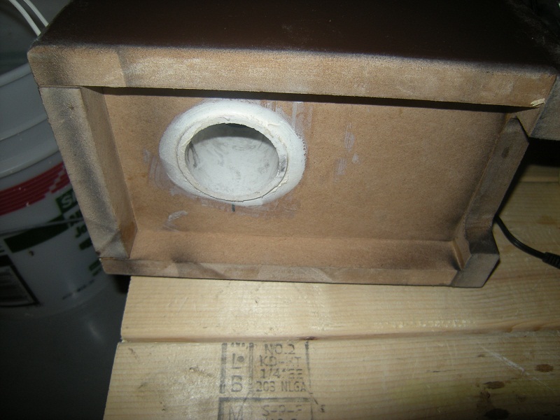

By the way, I have done my own "accidental transmission line" for the W3-881SI. It started out as a simple bass reflex in WinISP, but it performs far better than a simple BR due to its dimensions. I call it the nanoTower. You'll find the thread easy enough with the search function, if you are interested.
