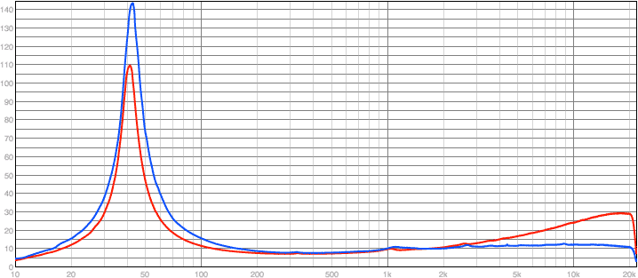

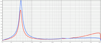

There are two different basic curves.
An impedance curve shoves some kind of voltage through the speakers then measures the current. This could be with a sine wave or with a noise waveform depending on the analyzer. The output from the analyzer connects to the speaker electrically, directly or via an amplifier. Another set of leads goes directly into the analyzer. There is no microphone in this setup. Then you should get a curve like planet10 posted.
An SPL curve measures the sound pressure at each frequency. The amp runs the speaker with a sine wave or noise, the microphone picks up the signal and measures it.

From Pete's post#2 we are trying to measure impedance calculate parameters.

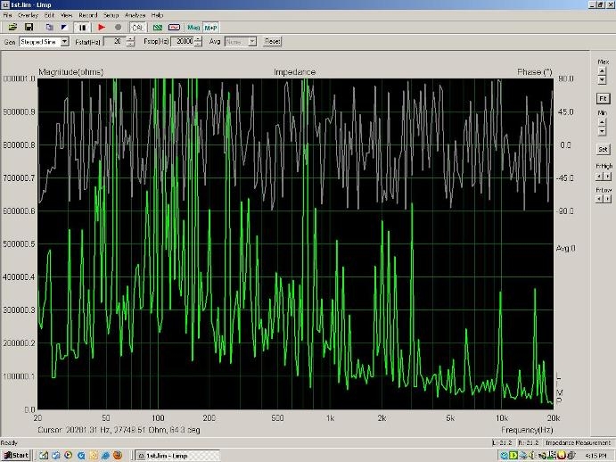

Ah, I couldn't see the thumbnail before for some reason.

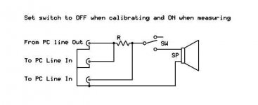

Seems like the level is too low, down into the noise floor of the PC maybe. Perhaps not enough output from the PC? It might need an amplifier in-line. What is the voltage across the speaker when the measurement runs? Voltage across the resistor? Even a cheap DMM would give interesting info.
If the resistor is big, to try and simulate constant current, the voltage across the speaker becomes very small-maybe too small in this case? If you reduce the resistor, to try and simulate constant voltage, it probably clips the card in the PC. (MLSSA uses like 80 ohms on-board, I think, which simulates neither condition and so is a tad hokey, but you can still get parameters to have some clue about the box).
Those are general issues, if not that then hopefully the ARTA thread will get some better answers.
re:'Seems like the level is too low' - that could be it, you may have to change your volume control settings, although this should be obvious when running the calibration.
(I'm responding while I'm supposed to be working, so can't look at the actual LIMP screens😉 FWIW, my cal resistor is 8.2 ohms, I use the Pink Noise rather than sine sweep. Computer is an oldish Dell with on-mobo sound.
I'ts worth persevering - LIMP is really easy to use once set-up, I went through the same problems but it was some time ago.... # brain cells diminishing rapidly...

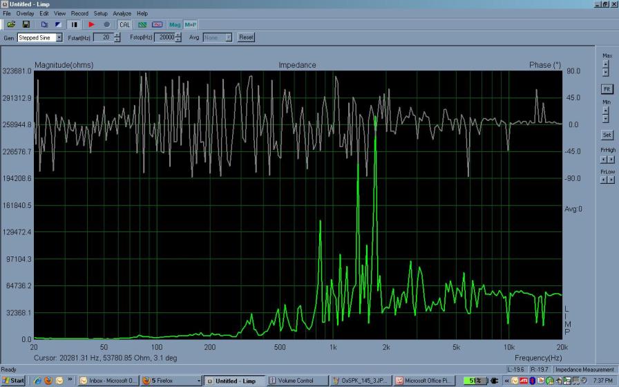

Thanks for the input guys.
I replaced the 100 ohm resister I had in there with a 10 ohm and the speaker got a lot louder. But it didn't make much difference in the plot.
Then I noticed that I had no db variation between channels so I rewired the whole jig, getting rid of the connectors and hard wiring everything. Still no luck but the speaker got even louder.
I'm doing this on my Lenovo t400 with onboard full duplex sound, as well as my old Dell Inspiron with a Soundblaster Live. The Dell seems to work best but the laptop puts out more output.
I've been reading through all the old Arta posts trying to find a solution.
It might be time for that new thread though... I've just about had it. :t_ache:
At what point do I start wondering if the speakers are the problem?
This is all using Radio Shack stuff so about the only thing left to try is replacing the cheap leads with something better.
Hey dude, Probably you are using Mic input to measure. use line in. Check and let me know. if its Mic input its gonna distort.I guess there is no "line IN" for your laptop. all you have is "mic IN". use some desktop. most desktop has "line in" socket.
Ok, will try the line in on the desktop...
So should I try to have the volume on the line in close to the same as for the speaker volume or should I have the speaker volume higher? There's lots of ways to avoid clipping on the calibration panel. I'm just trying to find the most optimal.

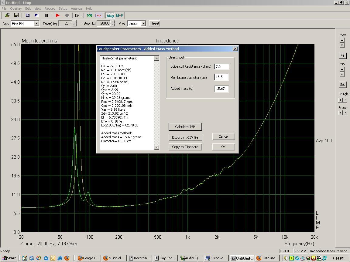

Success!!!!
Success! Thanks fellas!
Turned out that moving to the other input did the trick.
Now I get to start a new thread for enclosure suggestions!
Parameter Value Dim
Fs 77.3 Hz
Re 7.2 ohms[dc]
Le 504.33 uH
L2 1046.4 uH
R2 17.56 ohms
Qt 2.6 -
Qes 2.99 -
Qms 20.27 -
Mms 39.26 grams
Rms 0.940817 kg/s
Cms 0.000108 m/N
Vas 6.93 liters
Sd 213.82 cm^2
Bl 6.780901 Tm
ETA 0.1 %
Lp(2.83V/1m) 82.7 dB
