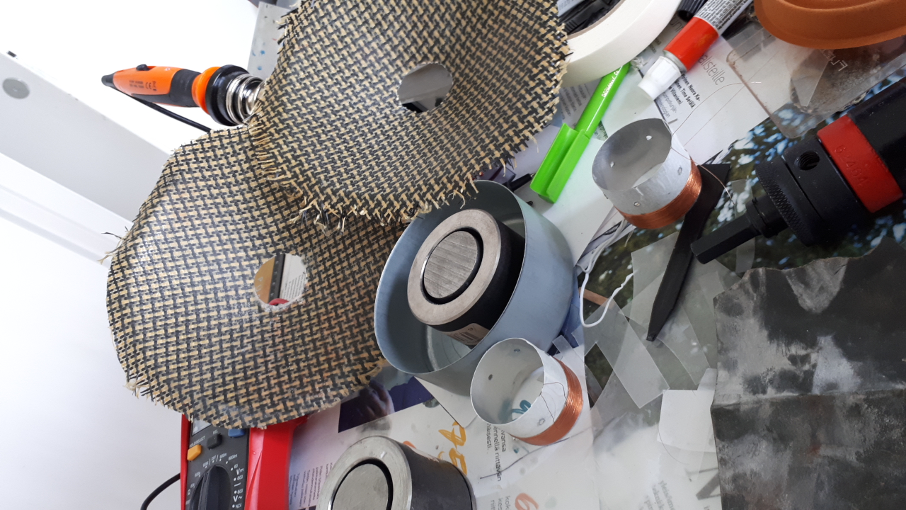

Thanks for the links. Often the biggest problem may be the minimum order quantity, and my lack of cutting tools. Everything would be easier, if I had all the tools to make iron parts with correct shape, and if I wouldn't live in a multi-storey block building.
However, I think that the material is probably not the biggest problem with the driver. I'm using Fe52/S355 steel, which should have magnetic saturation around 2 T and permeability somewhere around 1000. I'm not sure about it, but I think that could be enough when I use a super strong magnet. I should maybe try modeling it on FEMM to find out. It's also possible that the shape of the magnet structure is not optimal.
I'm using quite soft spiders (spiders and surrounds are the only non-DIY parts), and I wonder if that can also have some effect on the mechanical Q. Unfortunately, I don't have many photos of the building process (but I have some video that I will edit and publish later), I can still attach one photo that can maybe give some idea about how it looks. However, during the building process of the motor, I tested the system without attaching a cone yet, and at that time it felt like it was actually quite strong. Nevertheless, I have no reference to compare it to, maybe I just thought it was pretty strong.

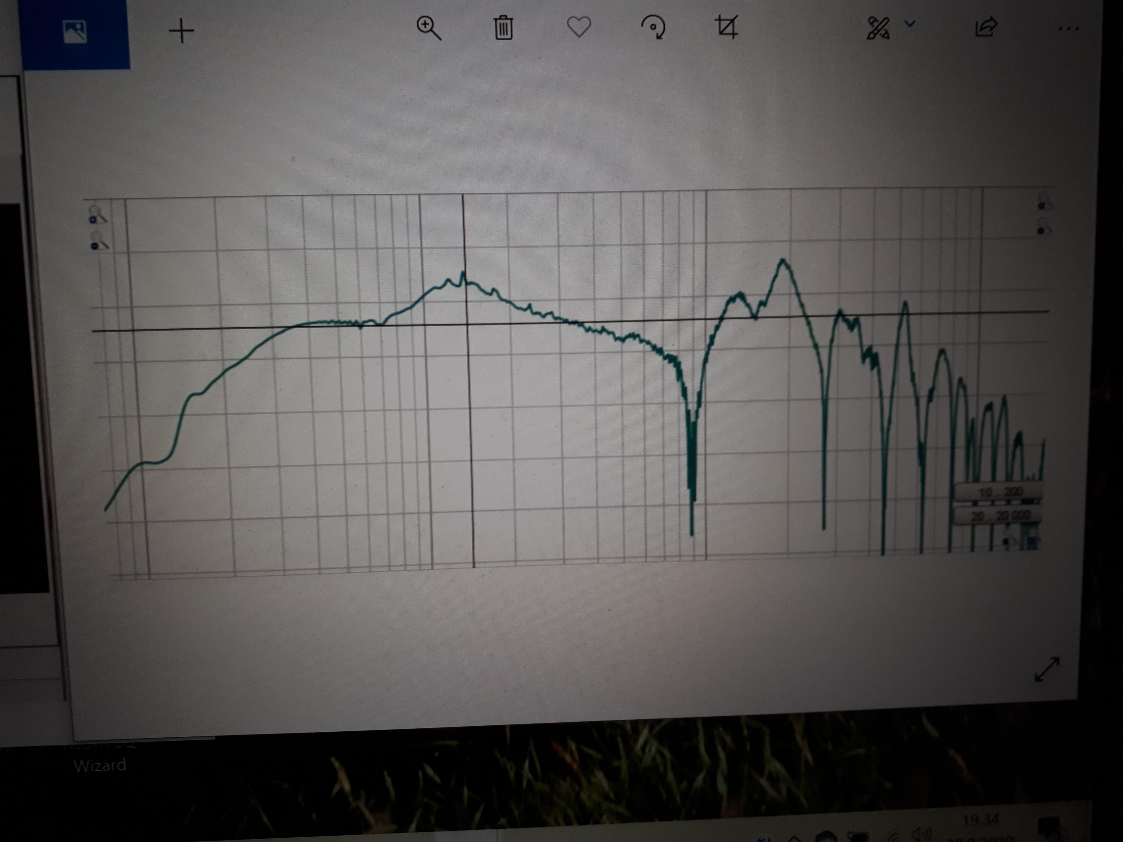

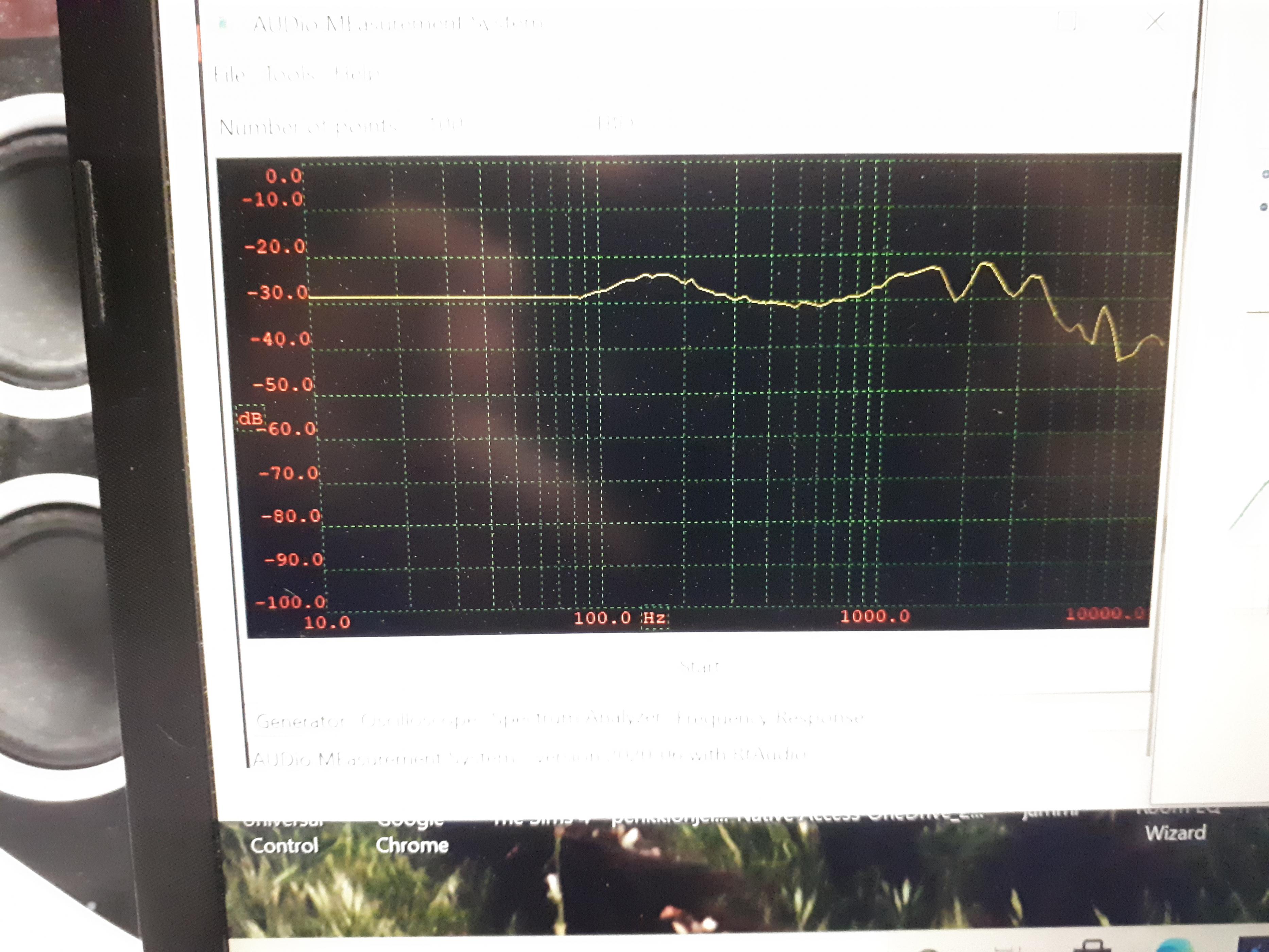

I made a spherical aperiodic enclosure for the woofer. Otherwise it seems ok, but there's some resonance between 100 and 200 Hz. The whole enclosure is stuffed with glass wool, and there is a 5cm diameter damped port in the back of the sphere. I don't know what causes the bump. I don't believe that it's caused by room modes, as I measured it from quite near of the speaker and the bump is quite wide. On the other hand, the cabinet is full off glass wool, so could the cabinet still resonate like that? Seems pretty weird.
I wonder if I could still tune it some way, like making the port larger or something, or adding mass to the cone (this would feel pretty stupid). Or if there is any passive analog EQs I could use for it. It doesn't sound horrible, but I wouldn't want to leave it like this.
Edit: I calculated the resonant frequency of a spherical helmholz resonator that size, and it should be somewhere 110 Hz, if the hole is 5cm. Maybe I should make a larger hole?
Or should I make the hole smaller? I maybe uderstood it wrong. However, I i make it smaller, it will maybe be less efficient in damping and more like an air spring. If I make a bigger hole, the resonance shifts higher, but does the peak go higher or lower? Or should I just put more and more glass wool 😀
The bump wasn't there post 18.
This indicates that the different enclosure (or test conditions) caused it.

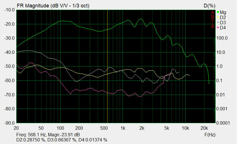

when I measured with REW, some strange comb filtering appeared in the response. That does not exist in the actual fr, but it is probably caused by something in my measurement setup.
Maybe it is caused by the big metal lip in front of the driver.

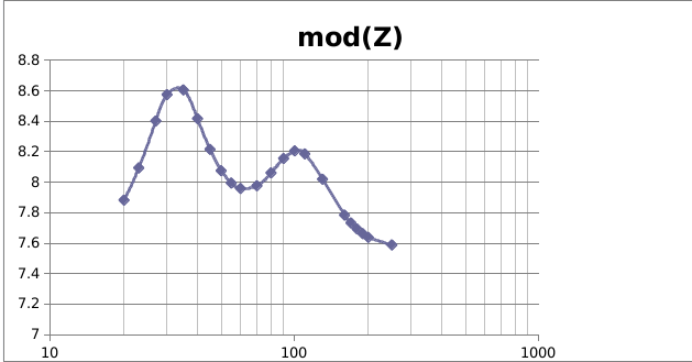

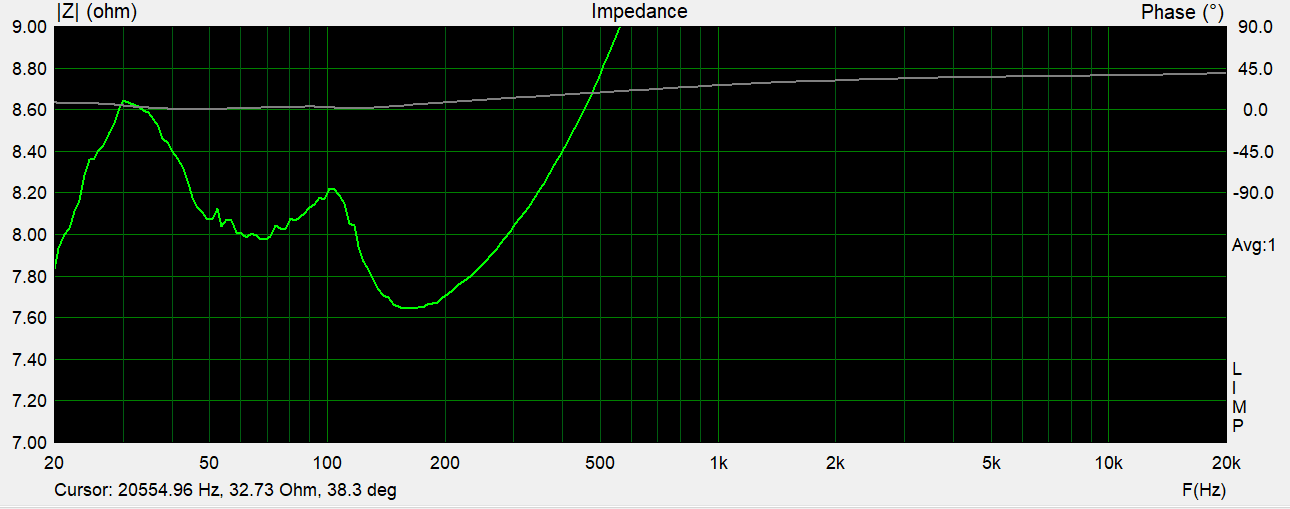

What does the impedance look like as a function of frequency?
I think it should be correctable with a Linkwitz transform circuit.

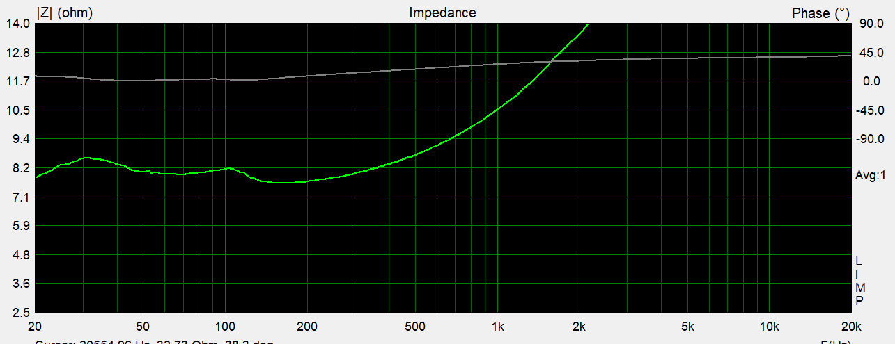

I made it to measured it today. However, I have not compensated the resistance of the cables etc. And also I'm not sure how accurate is it. But maybe this tells you something. The resonances seem to be at 30 Hz and 105 Hz.
It looks like a very damped bass reflex box with an unusual tuning. If you give me a couple of days, I'll try to fit it to a simple LRC circuit and determine the zeros of its impedance, which should be the poles of the transfer from voltage to sound.

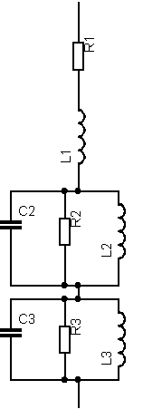

Don't take what I'm about to write too seriously, as I have no idea if my fit is good enough.
Anyway, I used an Excel sheet and some manual tweaking to fit your impedance graph to an LRC circuit, then used a program called LINDA (LINear Dynamic circuit Analyzer) to extract the poles and zeros of its impedance. Theoretically the zeros of the impedance should be the poles of the transfer from voltage to sound, at least at low frequencies.
I used the circuit in the attachment and ended up with these values:
R1 7.4 ohm
L1 878.24 uH
L2 909.45 uH
R2 0.72 ohm
C2 2.526267 mF
L3 4.421944 mH
C3 5.304 mF
R3 1.17 ohm
The extracted zeros of the impedance are at (-93.875 +/- 184.766 j) rad/s and (-303.426 +/- 586.802 j) rad/s and an irrelevant real zero due to voice coil inductance (at -8342 rad/s).
Expressed in natural frequencies and Q factors, these are two resonances with a Q close to 1.1, one around 33 Hz and one around 105 Hz.
Assuming this is close enough to the truth, you can either
1. Use a Linkwitz transform circuit to extend the bass. When you convert the 105 Hz, Q ~= 1.1 resonance into 33 Hz, Q ~= 0.56, you end up with a 33 Hz fourth-order high-pass response that is somewhere in between Butterworth and Linkwitz-Riley,
or
2. Use a Linkwitz transform circuit to cut the bass. When you convert the 33 Hz, Q ~= 1.1 resonance into 105 Hz, Q ~= 0.56, you end up with a 105 Hz fourth-order high-pass response that is somewhere in between Butterworth and Linkwitz-Riley,
However, when I simulate the uncorrected response assuming poles at (-93.875 +/- 184.766 j) rad/s and (-303.426 +/- 586.802 j) rad/s and four zeros in the origin, I only get a peaking of 2.06 dB. That makes me wonder whether the fit and the assumption of lumped behaviour are really good enough.

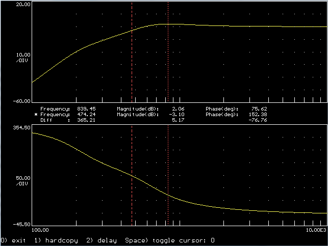

It could also be that my assumption of four zeros in the origin is wrong. They are practically in the origin with a bass reflex box, but you deliberately add acoustic resistance, which may shift them to some negative real location.
Attached are your measured graph and my simulated graph assuming four zeros in the origin. The simulated graph has a rad/s frequency scale, so all frequency values are 2 pi times larger than you would expect (peculiarity of the program I used). It's at -3.1 dB at 474.24 rad/s, so 75.48 Hz, and somewhere around -40 dB at 20 Hz. Your measurements only show a roll-off of about 20 dB at 20 Hz.
