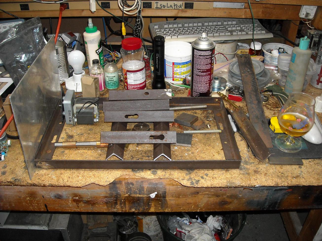

Most of the rail is cut. I need to remove the rivets from another section to finish the rest of the peices.
If I can find a source for EI cores. bobbins and end bells I will do some experimenting. Yes.
If it works out I plan on replacing the AC motor with a stepper motor and adding a second stepper with a lead-screw for wire feed traverse.
