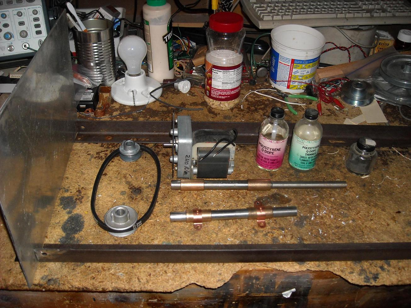

I've started collecting material to build a coil winder.
The frame will be made from old bed rails.
The motor mount on the left on a section of aluminum plate.
Bronze bushings and water harden drill rod for shafts.
I found my polystyrene Q dope and thinner, but the thinner evaporated. The bottles are probably 30 years old.
