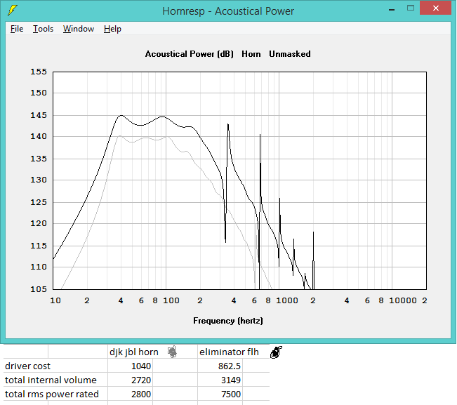

I did a comparison of the suggestion I made using the clearance eliminator drivers and djk's horn with the jbl driver. I ran the sim in 2pi and at the voltage for rated rms power into nominal impedance.
Looks like if you have the power available, using an assload of cheap drivers will get you more spl from similar volume and driver cost.

"It's not necessirliy the best match for the horn. A better impedance match would have less ripple and more efficiency (fairly flat around 40-50%, instead of bouncing between 10 and 60). But it would still be about 113dB/2.83V, down to the high 30's. That's all a function of the horn. "
In general, I like to design bass horns such that a stacked pair look like 5.10C, and a quad stack 5.10D.
5.10C is ±3dB of ripple, most commercial horns are closer to 5.10B for their smaller size. Note how 5.10D has less ripple, but it also has about 3dB less output in the bottom octave.
It's all about the trade-offs you are willing to make.
