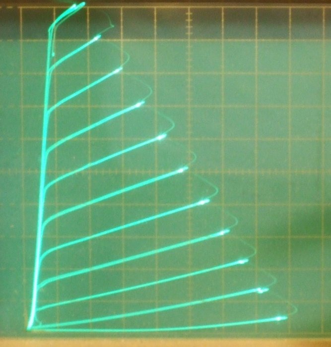

You take a pentode and put in the resistors for Crazy Drive. (R1 from grid2 to grid1, 4K say. And R2 from grid1 to cathode, 4K say. Also try R2 from grid1 to Gnd or some - Bias V, may simplify biasing. ) Then we add UnSET to it. Which is resistive Schade Fdbk plus a P channel follower to drive the cathode. The resistive Schade would be a high value resistor from plate to grid2 in this case. (normally to grid1 for Unset) Say 100K from plate to grid2. And then a P channel follower goes under the cathode to drive it. With everything combined (some R value tweaking for the specific tube likely), you can get linear mode triode curves. Or a "Wire with Gain". Here is a curve trace: (been mentioned several times, but never gets any interest)
Here is Crazy Drive alone:
And here is UnSET alone:

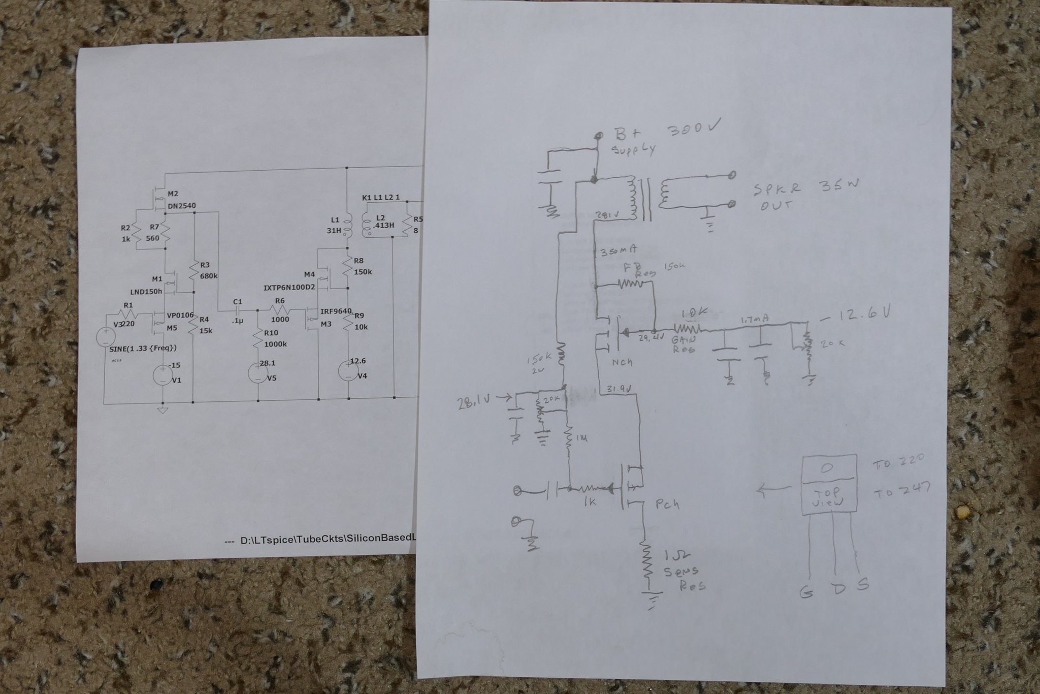

In reality the whole UNSET thing came from an attempt to remove the negative voltage supply needed in fixed bias tube amps. Somewhere about 8 to 10 years ago I made a simple test board with a 12 pin compactron socket with a Pch / Nch mosfet pair on the cathode, control grid, and screen grid with the capability to sink or source current through each of the three pins while simultaneously applying in drive from either phase output of a push pull driver board. These experiments were all single ended, but the first two working amplifiers were both push pull. One squeezed 20 watts from a pair of 50C5 radio tubes in a guitar amp design. The other got 50 to 80 watts from a pair of 6GF5 sweep tubes. The 6GF5 is a shrunken 6GE5 which is a 6DQ6 stuffed into a compactron bottle without a plate cap. They were once on the $1 list, so I got a bunch.
I did create an UNSET output board that can be used for a single channel push pull amp or a stereo SE amp. I have boards for the octal tubes, and have a layout done for 12 pin Compactrons but have not sent it out for fab yet. So far, I have seen a single pair of 26HU5 tubes hit 250 watts and two pair make well over 500 watts.both of these test amps used the Universal Driver Board feeding one or two octal UNSET output boards.
I also made an all mosfet SE amp that makes 20 watts in SE through an OPT on 250 to 300 volts. The board layout is about half done.
I am typing this from a hotel room in Tennessee, so I don't have access to my main computer for schematics, data, and pictures. I should be back Sunday but will be met with an acre that has not been mowed in two weeks.

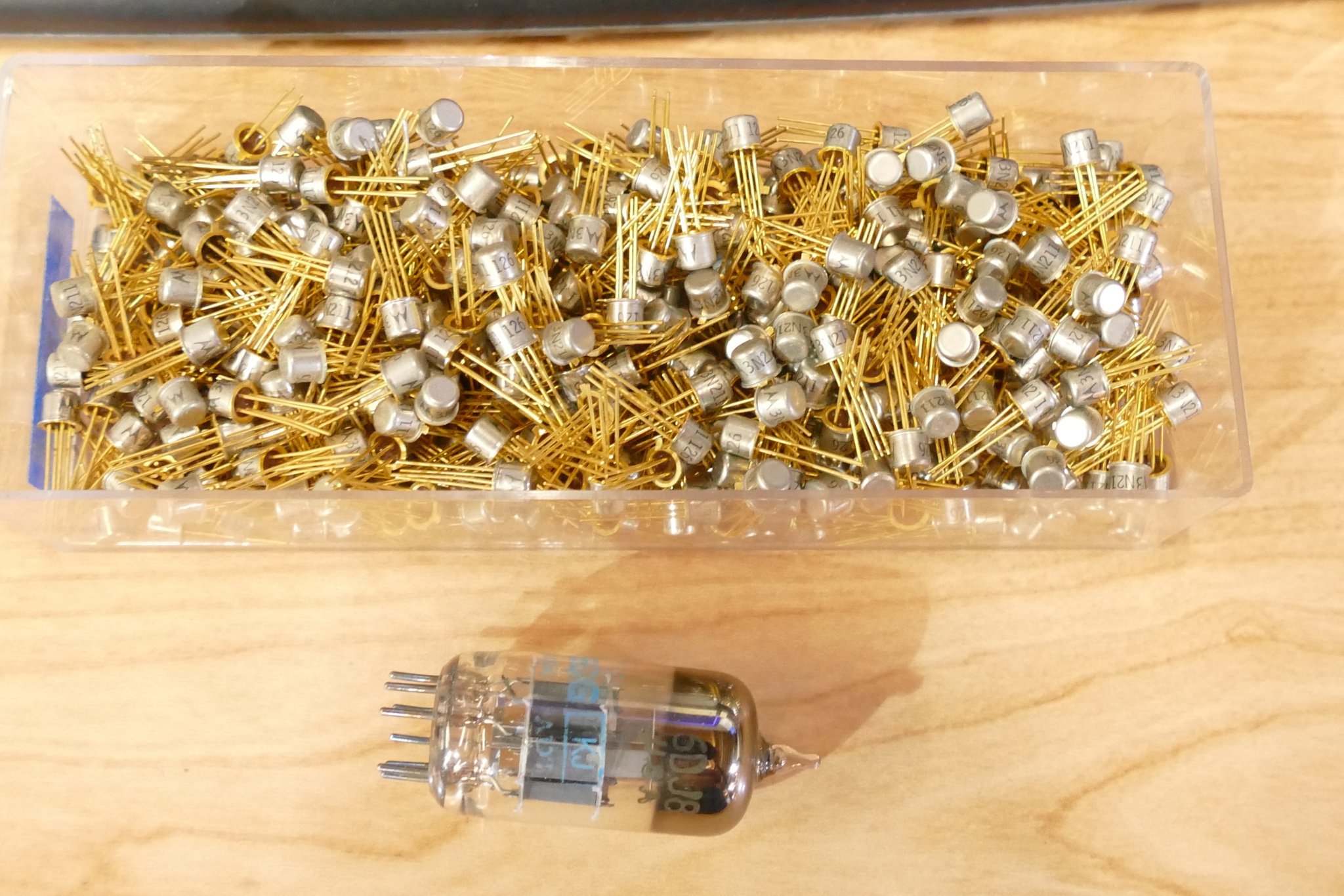

If anyone wants to play with some of the parts I have, I can send a few for the cost of shipping.
It seems that the 3N211 is still being made along with a list of other dual gate mosfets, and several other unique semiconductors from the past. Just how much these low run rate, high reliability parts cost is a different story.
https://digitroncorp.com/Products-Overview/Dual-Gate-Mosfets?page=1
Throwing some of the other common dual gate mosfet numbers at Digikey reveals the Harris 3N206 at about $14, unfortunately with a 22 piece minimum purchase. All of these came in a TO72 can with 4 leads. There is an SMD part, the 3SK264 at 22 cents each......but you need to buy a whole reel of 1400 of them.
Hmmm #1 ... 100K from plate to G2, 4K from G2 to G1, 4K from G1 to Cathode ... So G1 is always positive with respect to the cathode ... ?
Hmm #2 ....... and voltage gain of the output is now less than unity - some minus -6dB says my sim ... Unset's output stage had +10dB ... ?
It may be extremely linear with more than 100% feedback but this wire seems to have no gain at all, at least no voltage gain.
But maybe I am completely wrong and misread your description ... ?

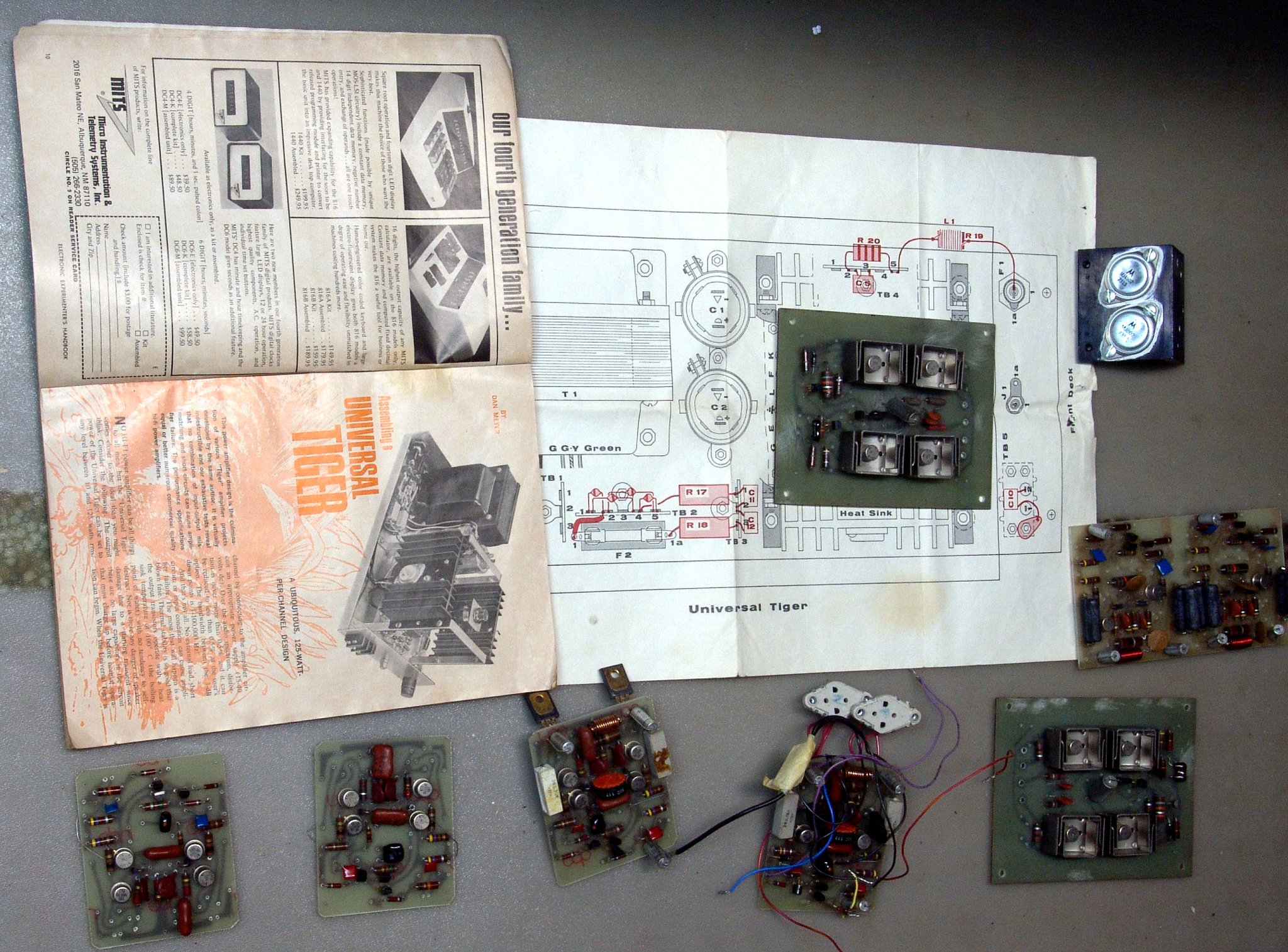

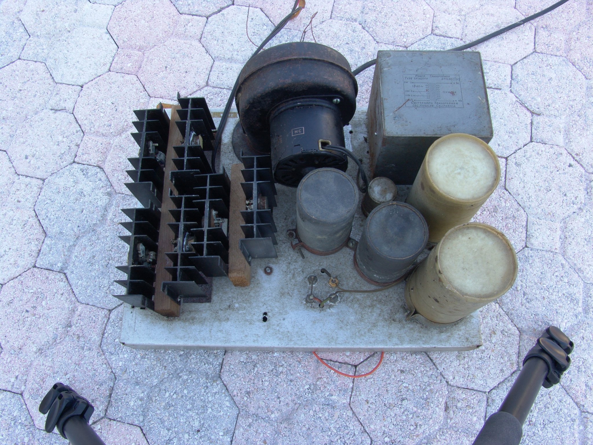

Over the years I built several of every Tiger except Tigersaurus. I built three or four Plastic Tigers during high school (1967-1970) They were simple creatures with 5 transistors. I used two for a simple stereo system. I don't remember any objectional crossover distortion, but I probably cranked up the idle current beyond what the magazine article called for as I used one large heat sink for all 4 output transistors. Before building the Tiger I used a DIY clone of the Heathkit AR13 power amp section in which I used HEP-230 TO-3 germanium output transistors in a transformer driven Totem Pole circuit. I liked it's sound better than the Tiger, though I switched back and forth a lot. One other Plastic Tiger went into an all transistor guitar amp that made maybe 15 watts into a 6 or 8 inch speaker. The fourth Tiger was used for science experiments and got blown up often. It eventually found a home driving a totem pole 6 transistor monster that made about 300 watts on about 100 volts using 6 "mystery transistors" that I got by the box full at a local (Miami) surplus house. A discussion somewhere on these forums resulted in my boxing up all of my remaining Tiger stuff and selling it cheap to another forum member after I had been building only tube stuff for several years.
The primitive Totem Pole circuit was found in the RCA Transistor manual. I simply super-sized it using three silicon transistors in parallel for each half. This thing paired with a DIY germanium preamp went in between my guitar playing and 8 X 12 inch speakers to create the loudest "thing" in the neighborhood. The workmanship is rather crude, but I built this thing when I was 15 years old (1968) with only a hand drill, a nibbling tool, and a soldering gun. I found it in 2007 after a hurricane destroyed the shed that it had been sleeping in for 20+ years. I plugged it in (outdoors) and it blew the fuse, so I jumped the fuse and plugged it in again to see one of the power supply caps vent, so I took off the heat sinks and the DIY driver transformer and trashed the rest. I took the 40 year old transformer apart to see how well the masking tape insulation held up and was quite surprised to see it mostly intact despite a serious soaking from the storm and a week of baking in the sun to dry. The transformer was wound on a fried Radio Shack power transformer core and bobbin.
My professional electronics career went a bit out of order compared to most people. I started on the line at Motorola assembling and tuning walkie talkies and worked my way up to an engineer designing them. Then Motorola paid for me to go to college for an engineering degree. As with most engineering degrees I had to build a senior project. Mine involved a Universal Tiger amp board, four Plastic Tiger amp boards, and a DIY power supply to power all 5 amps in a car. Those were the last of the Tigers that I built, and most of the boards had been built several years earlier.
My home stereo consisted of mostly Carver and Phase Linear stuff until I traded my first car (still drivable in the 90's) for an old Scott tube amp. After some fixing, it kicked all of the Carver / Phase Linear stuff right out of the stereo rack.

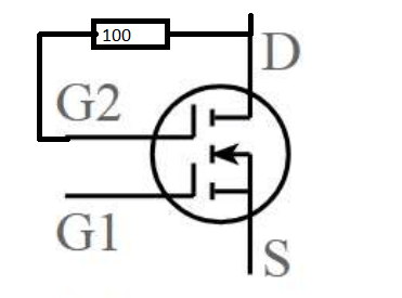

I suspect a dual-gate MOSFET simply consists of two MOSFETs with the drain of one connected to the source of the other. If so, you might as well connect two ordinary MOSFETs in series.
That would be a cascode.
If you tried to apply feedback from the upper drain to the upper gate, the upper mosfet's source and the lower mosfet's drain will just follow the upper drain, no feedback.
The situation with a dual gate mosfet is different because both mosfets share the same substrate;
you can't do that with two separate devices.
After all it is the voltage potential between gate and channel (which resides in the bulk) which determines the gate characteristics.
That parameters in the datasheet are referenced to the source is due to the fact that the substate is connected to the source and usually not available on a pin.

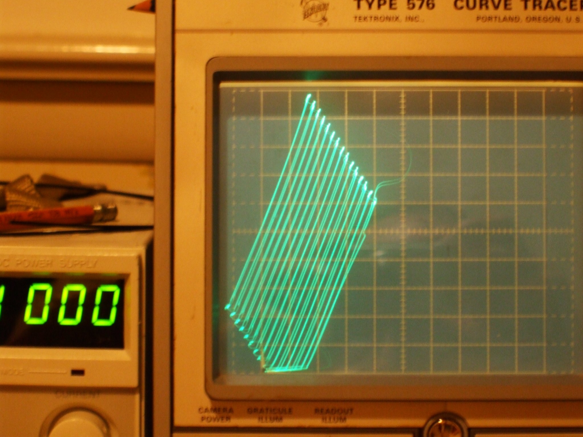

re: Sorento: It may be extremely linear with more than 100% feedback but this wire seems to have no gain at all, at least no voltage gain.
Unfortunately I don't have the data for the R values for that old C Tracer picture, except that it was a 21HB5 Sweep tube with Crazy Fdbk and cathode drive for input. The gain was clearly a little low judging by the reduced plate voltage excursion in the graph. If you increase the resistance between the plate and grid2 the gain should go up, but the "linear" quality may go down.
Yes, but only a few Volts. The Crazy Drive function works by current draw of grid1 reducing the voltage swing on grid1 at higher plate currents. (or grid2 voltages) So operation starts with grid1 control at low currents and transitions optimally to grid2 control at higher currents. Some optimization of the resistors is required to get a smooth constant gm curve set. Grid1 current should typically be prop. to SQRT of cathode current, and apparently reduction of grid1 control by divider action (lower grid1 Z ) effectively reduces the combined grid2 and grid1 3/2 power law to 2/2 law over the usable range. At least that's the "theory".
It might be possible to just use grid2 alone for Crazy N Fdbk with a high enough "Schade" resistor to get grid2 gm to drop off (from grid current Z reduction) for a linear result. The gain might be too high then. don't know. Grid1 could be biased negatively then.
Not really. It's mostly the gate-source voltage although the bulk-source voltage also does something. In the CMOS IC processes of 30 years ago and for a MOSFET biased in weak inversion, the transconductance from the gate-source voltage to the drain current was usually about twice as high as that from the bulk-source voltage to the drain current. Bulk effect has since been reduced in each and every new IC process. I don't know about the processes used for the BF981 and such.
By the way, the way we make a cascode on a chip is usually with a shared bulk. Assuming a P-type substrate, isolating bulks is possible for PMOSFETs and for NMOSFETs in processes with deep N-well, but it costs extra area and results in extra parasitics.
I think you have a point about there not being much point in feedback from the drain to the gate of the upper MOSFET, but I think the same holds for a dual gate MOSFET.

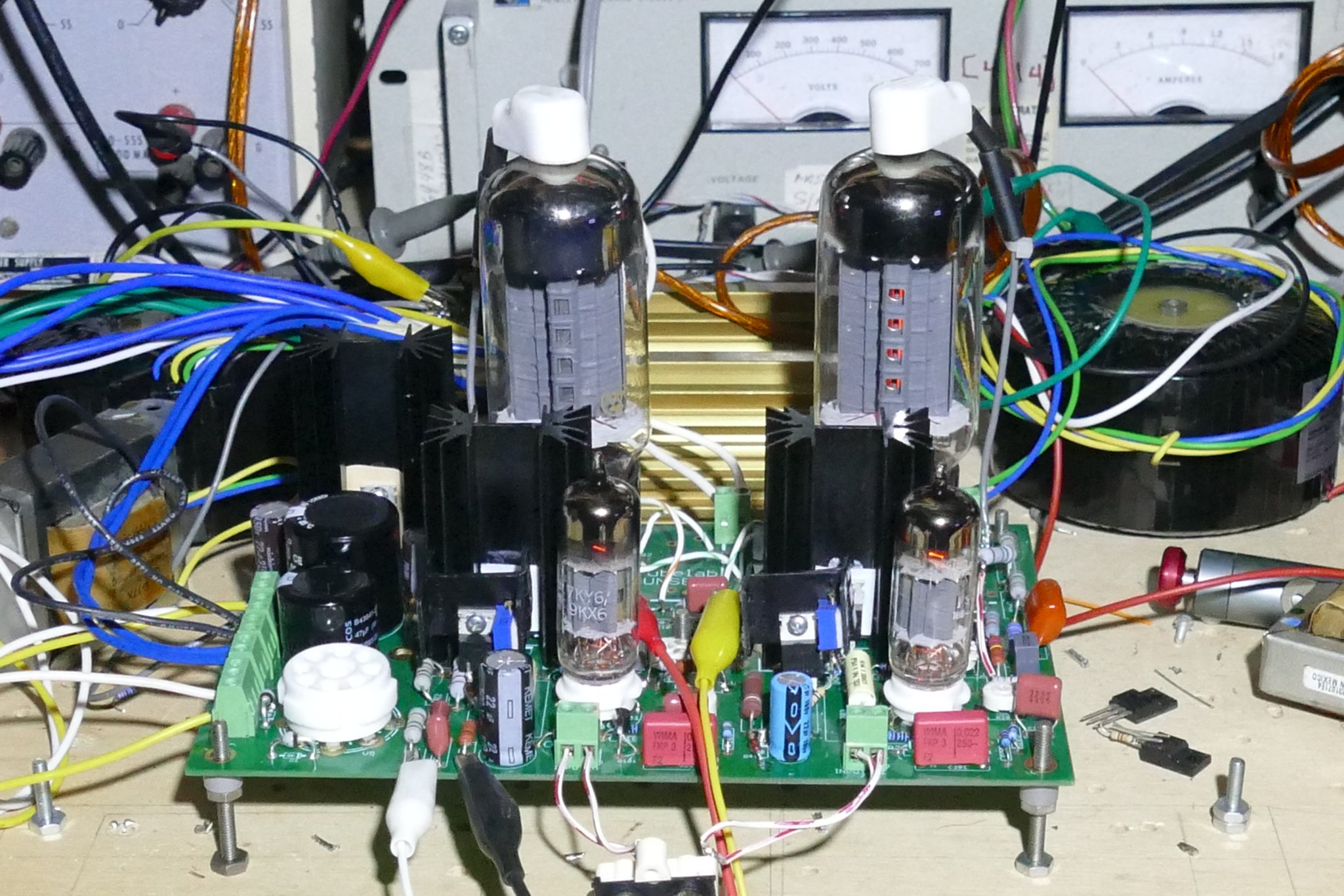

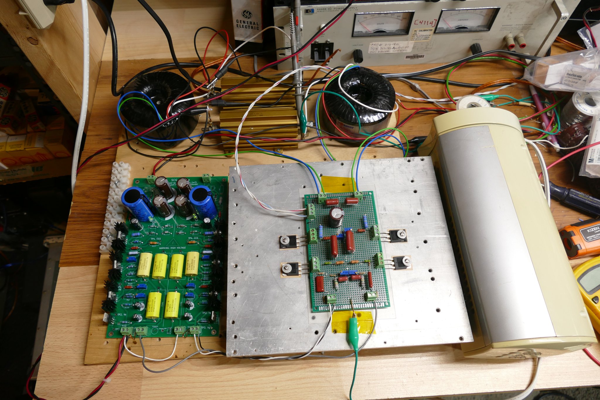

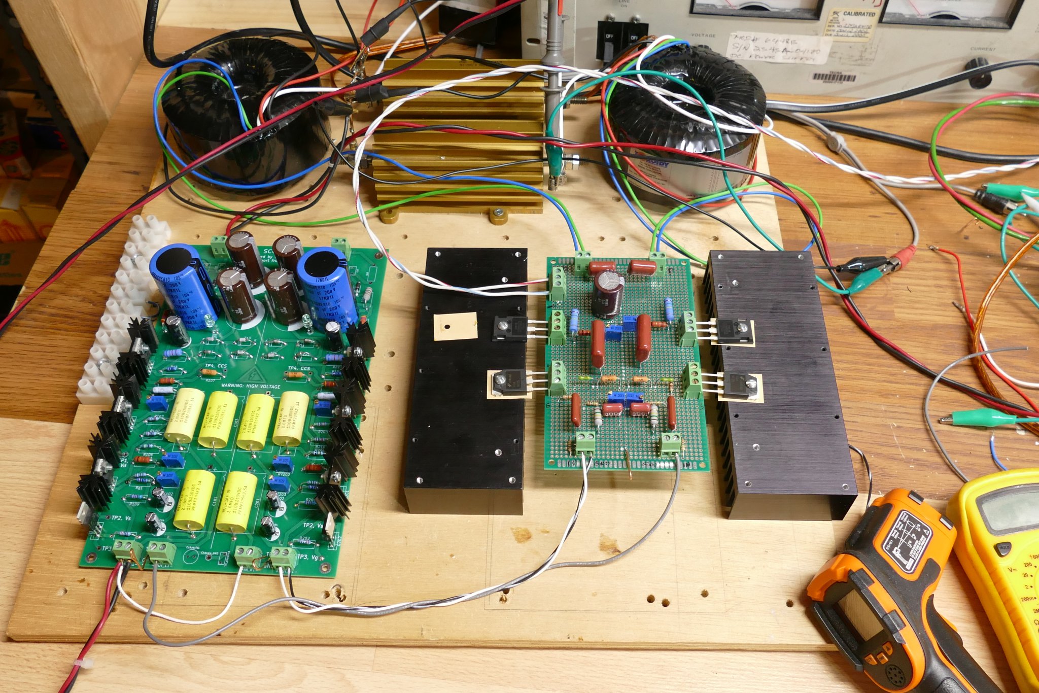

The UNSET amp board is here along with its schematic.
The FETSET breadboard is here along with the schematics and a version with the bigger heatsink needed to get 25 WPC.
Both amps make about 25 watts at the edge of thermal meltdown. The tube amp needs about 600 volts and the solid state version runs on 300 volts and eats 740 mA (over 200 watts to make 50 watts of audio). They sound very similar. Almost 20 years ago I stuck some silicon in a 300B amp to create the TSE amp. At first there were many haters, some even saying that I should call my company Transistorlab. That eventually died off as the word of how it sounded spread......but I don't think the world is ready for a Tubeless amp with OPT's yet.

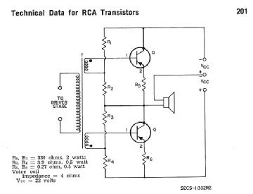

If you remember the 6 transistor AM radios with 9V batteries, from the 50s and 60s,
95% of them had an interstage phase splitter transformer, a thermistor bias stabilizer, and a push pull output transformer.
Practicality, and longer battery life, were the order of the day from marketing . . . to the engineers who designed the radios.
And, at least one McIntosh solid state Hi Fi Stereo amplifier had an output transformer to give multiple optimum output taps for different impedance loudspeakers.
Then there was at least one Allied Radio Stereo Hi Fi amplifier that used an interstage transformer with two floating phase splitter windings . . .
to drive the output transistors. That made biasing the output transformers simple.
Engineering Solutions Abound!
History goes around, and history comes around.
