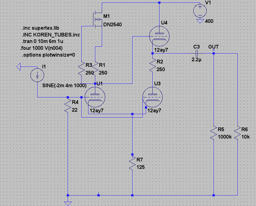

This is the alternative mu follower I have doctored... THD of 0.22%... no cancellation between tubes, lower B+.... biased with the TDA1541 offset
I am not convinced.... Thorsten, you have surely tried both mu follower and gomes topologies, and have advocated the gomes typology several times on this forum. Which one to pursue?

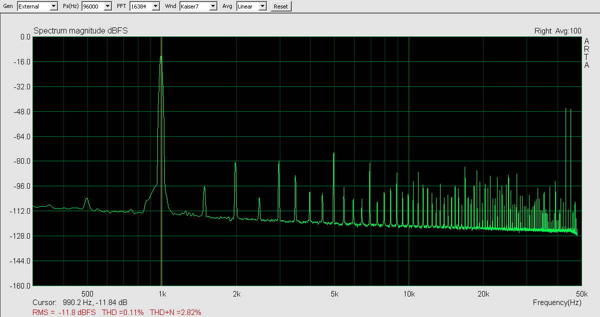

So I finally got around to building this. I have decided to do the grounded cathode version, with fixed bias from the TDA1541a. It sounds pretty great, even in a proto setup (final setup will be dual mono psu and salas HV shunt), better than my discrete I/V powered by Salas LV shunts.
Still need to tweak it a little bit, I didn't have the correct resistors to choose the optimal biasing point. What are other ways of further improvements? How to go about distortion cancellation?
Behold the plot (didnt manage to calibrate ARTA properly, so it looks better than it is)...

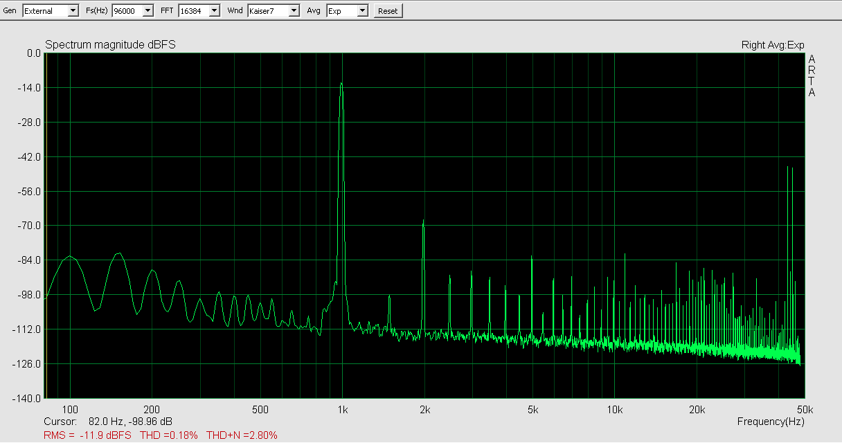

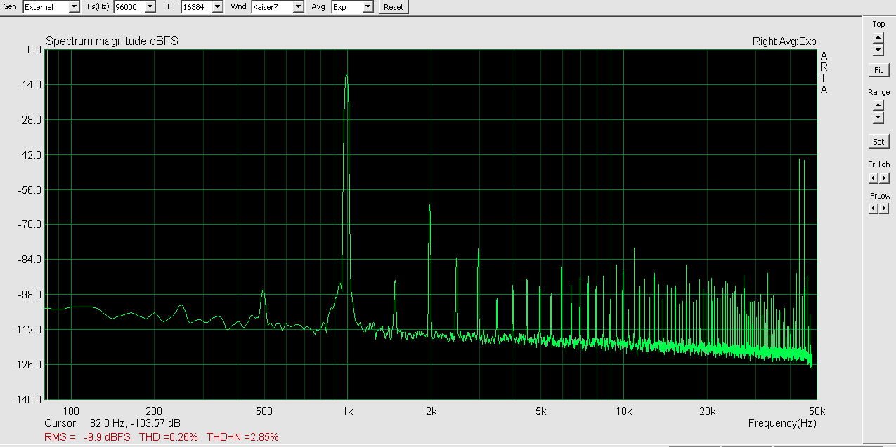

Today I tried to improve the operating point of the Gomes stage to a more linear area of the 6072a tube. Strangely, it measures worse.... Where do I go wrong in my thinking?
Old setup:
I/V = 33R, so fixed bias is 6.6mV (based on -2mA idle current from tda1541a)
Rk = Rak = 51R
New setup:
Rk = Rak = 18R
Based on the datasheet I expected distortion/harmonics to improve....
