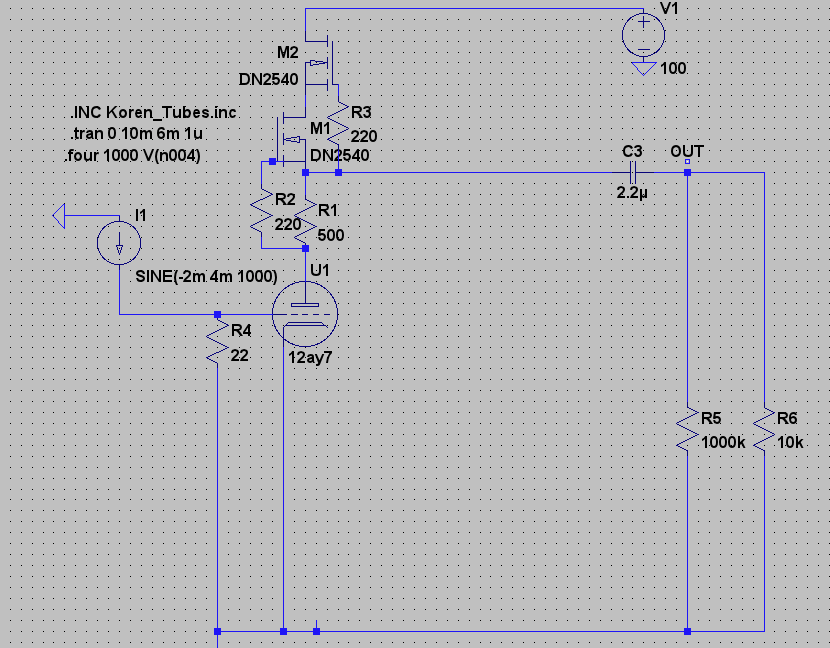

It´s no problem to add the DN2540-model.
Simulated the CCS with DN2540, both straight and cascoded... don't get to THD specs as with the tube...
You still don´t get it about simulations?
1 The .four is not to trust!
2 THD is uninteresting, harmonic spectra is!
But if you believe Spice is correct, the spectra of the Gomes is not nice as the higher overtones doesn´t diminish the higher they get. How it is IRL I don´t know but probably better.
And as I said to get a better picture you must try many different tubemodels. Why not try what T used in his design, a ECC81.
In a world were the amp with the lowest THD sounded best, it would be easy to choose😉.

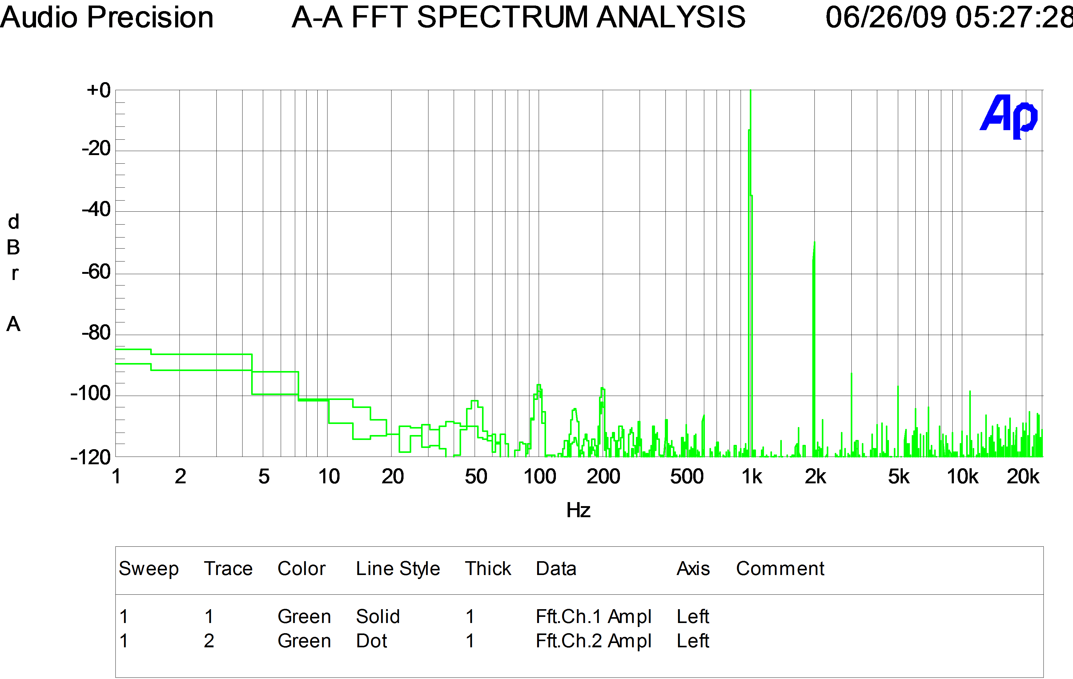

Attached a real Gomes stage, outputting 2V RMS into 10K. Note that this one deliberately did not have any aggressive distortion cancellation applied. Plus the ECC81 is a less linear Valve than the 12AY7.
As we can see, 2nd HD is around 0.3%, 3rd is 0.003%, 4th is MIA, 5th is 0.002% & 6th and higher at 0.0005% or lower. The spike above 10KHz is from the environment, not the test gear, maybe a CRT Monitor leaking in.
We can cancel the 2nd HD a lot more, but 3rd and 5th are then higher and the HD becomes more tube sample dependent. And it does not sound as good.
Using 6072A/12AY7 lowers 2nd HD appreciably, as it is basically a linearised and "audio grade" ECC81. Other ECC81 analogs, such as 5965 also give lower 2nd HD.

I must add, there is a TDA1541 DAC included in this plot, running "sans un filtre numérique", so it is likely to add to some of the higher order stuff.
Here by comparison a TDA1541 with Op-Amp (LM6181 current feedback) analog stage:
This is probably about as as it gets for the TDA1541.
Ciao T

Thorsten, what's your view on using a Mosfet CCS to replace the top left triode as suggested earlier?
Also i will change the operating point. Not comfortable to work with 400v in a Dac... Should be possible to get good results with lower voltage, also on 6072a.

It´s in the opposite direction. Your sim looks better in the higher order area than the sim. Just by looking at the fourier-analysis you can tell there is something funny going on.
Can also agree about the blogs. This also goes for the .four-sims above.
If I thought it had merit, I would have used in the AMR designs, wouldn't I?

Mine was the real thing on an Ap2, not a sim... 😉
The high order stuff looks better because the lower order stuff looks worse.
Ciao T

Typo, Off course I know yours is the real thing!
Wrong, all orders considered from first and up. The sim is better in the lowerorder and worse in the high order even without what the TDA1541 adds.
Only wanted to point out that one should take the simmed .four "cum grano salis magnitudinem montis".

This is the alternative mu follower I have doctored... THD of 0.22%... no cancellation between tubes, lower B+.... biased with the TDA1541 offset
I am not convinced.... Thorsten, you have surely tried both mu follower and gomes topologies, and have advocated the gomes typology several times on this forum. Which one to pursue?
