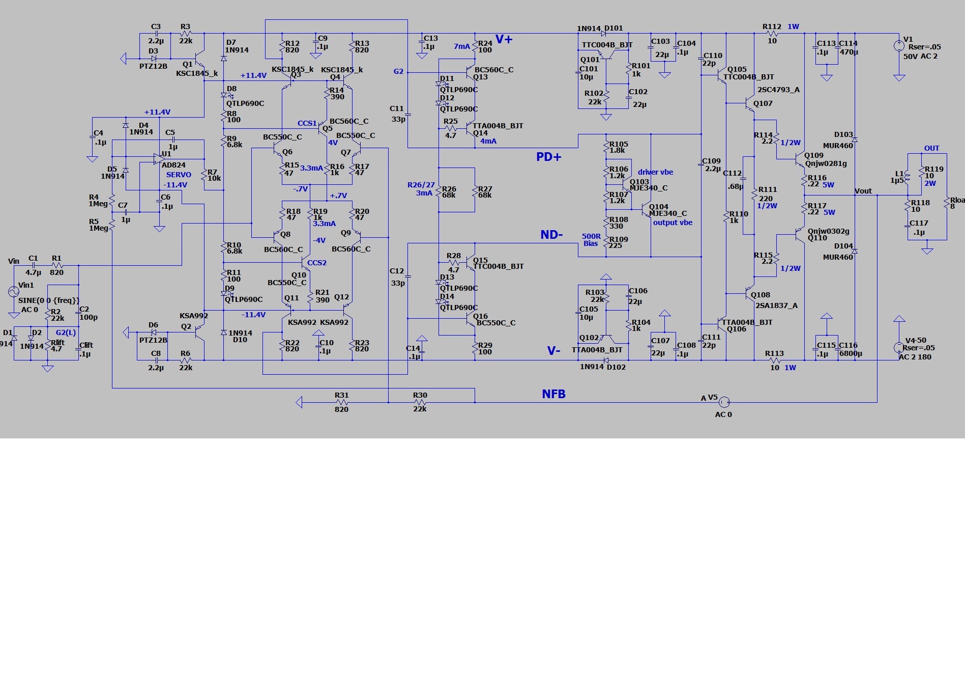

I've had this board laying around for a few years and decided to build a schematic for it. I've two questions about this thing???
1. Why would the designer use a TIP42c and a D880 for the drivers? Why not a TIP42c and its compliment, TIP41c? Or D880 and B834?
2. Is there a design name for this type of araingment, LTP. VAS, driver stage... I notice there is no bias adjustment and would not even know where to integrate one.
Any advice is welcome. I have not powered it up yet...
Scott

Thanks Nico... Well I connected it to a 30-0-30 300w toroid and It started with no smoke! DC Offset is about 14mv Lt and Rt.
I measured for bias voltage across R39 and R41, with the fluke set to DC mv, I measured 0.000 Did the same across the others with same result.
HHMM... Now to temp heatsink it and see what it sounds like. Will post results
Audio1Man is right.
With four b-e to bias, two 1N4148 sets this amp in class B.
TIP42C and 2SD880 because these were available, leftovers?
Input diff's not in a DIL14 case anymore (THAT's?), but more of these common bjt's.
Small rectifier bridge, fits in the board edges.
Lazy incomplete design, left after some disappointment?
Take a good design and move the usable parts, trash the rest.
Odd way to draw Q5-Q7, mirrored, rotated, flipped. But readable.

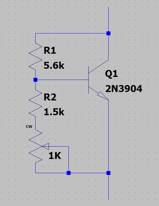

It looks like a resonable design, all you would need to do is re-engineer the bias network. Pretty simple to pull out those two diodes and replace with a Vbe multiplier. A Vbe multiplier is a single transistor and two (or three) resistors.
Here is what this type of topology should look like (below) - if the designer was not "lazy".
I've seen similar on Asian slave labor sub amps. Even those use zener regulated tail current sources.
Anywhere in between my example and the simple (lazy) version would work. "lazy" version would have crazy
DC offset , even with that blocking cap.
PS - this amp is "fully complimentary" ... Prof. Leach in Georgia,USA made it kind of famous. The "Leach amp" built by many a student.
It can .... with less lazy - be quite a "ripple eater" , giving cheap power supplies new life.
