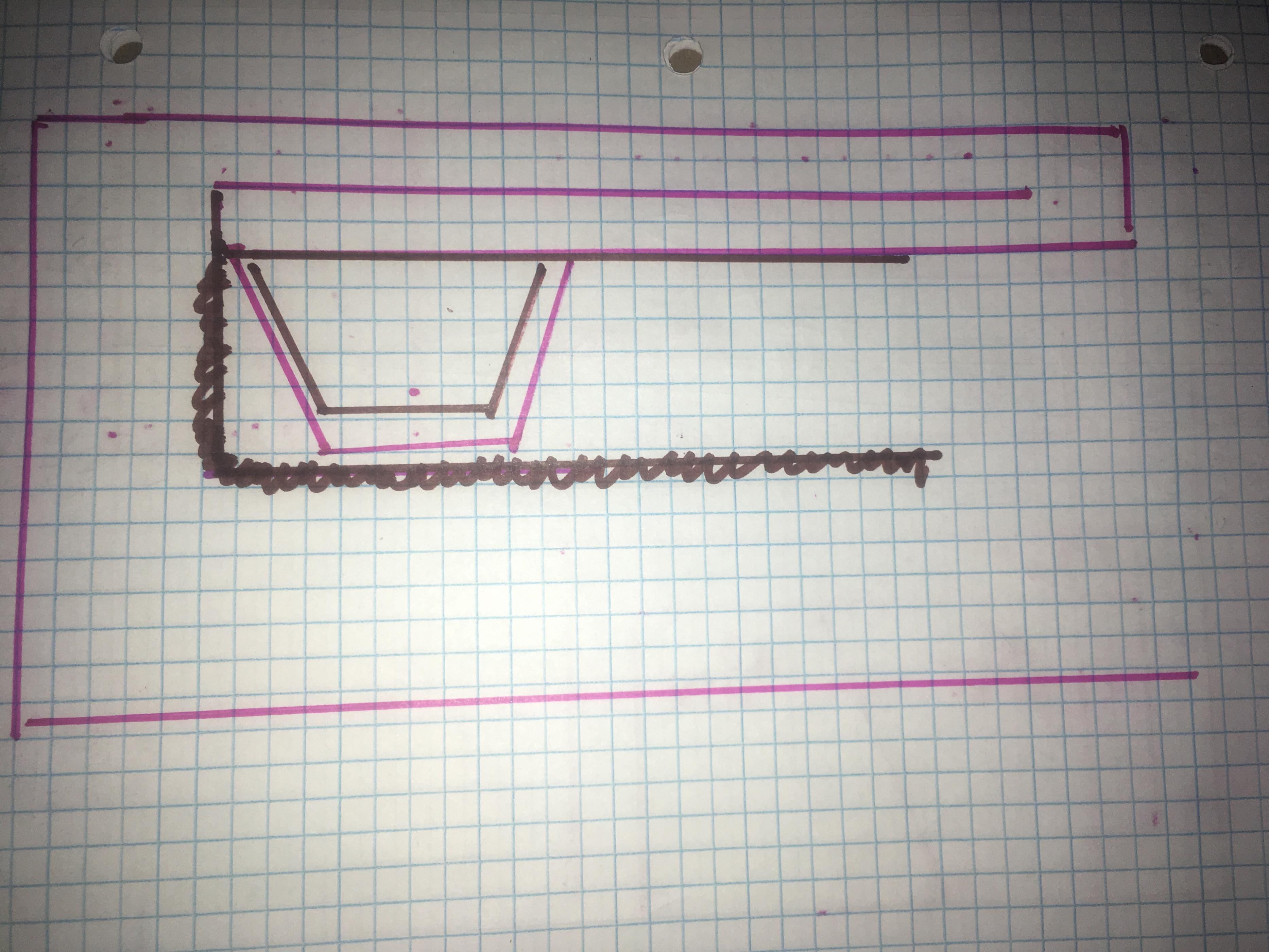

(Pic) this is stupid!! But tell me how you dont want to have a few moments ro experience it? This is only possible because of PA, THAM, progress, etc

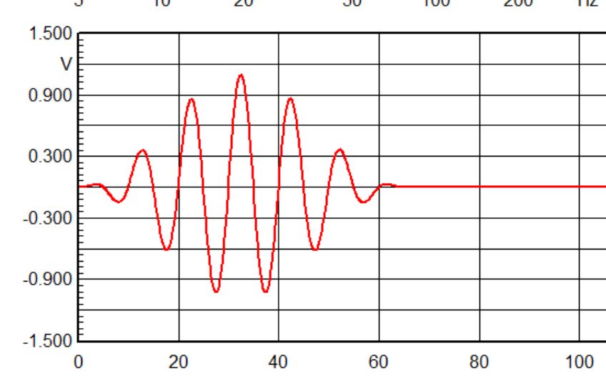

I have found this to work well in smaller tangband w5 1138 big mouth but not long offset driner entry point qw pipes. No sweep, slow and methodical finds and narrows in on things almost glazed over or ‘smoothed’ essentially. Im sure Brian probably used similar to find ‘dog food duct’ and its area of concern/resolve. (Great read btw).
Josh Ricci´s test recommend using the CEA-2010 short burst test.
This is the exact problem. The CEA-2010 short burst test allows for the Helmholtz resonance to gradually increase and build up before applying full power. A true transient will push the driver in a BR out of its linear travel and it will not have a chance to normalize around the zero crossing again until the main part of the energy from a drum strike has passed. This is quite evident just by watching a 218 BR box at high power at a live venue.
It is also quite evident why a horn, TH or high order QW BP will sound soo much better at transient content like drums, and the CEA-2010 short burst test will "hide" this problem with BR boxes.

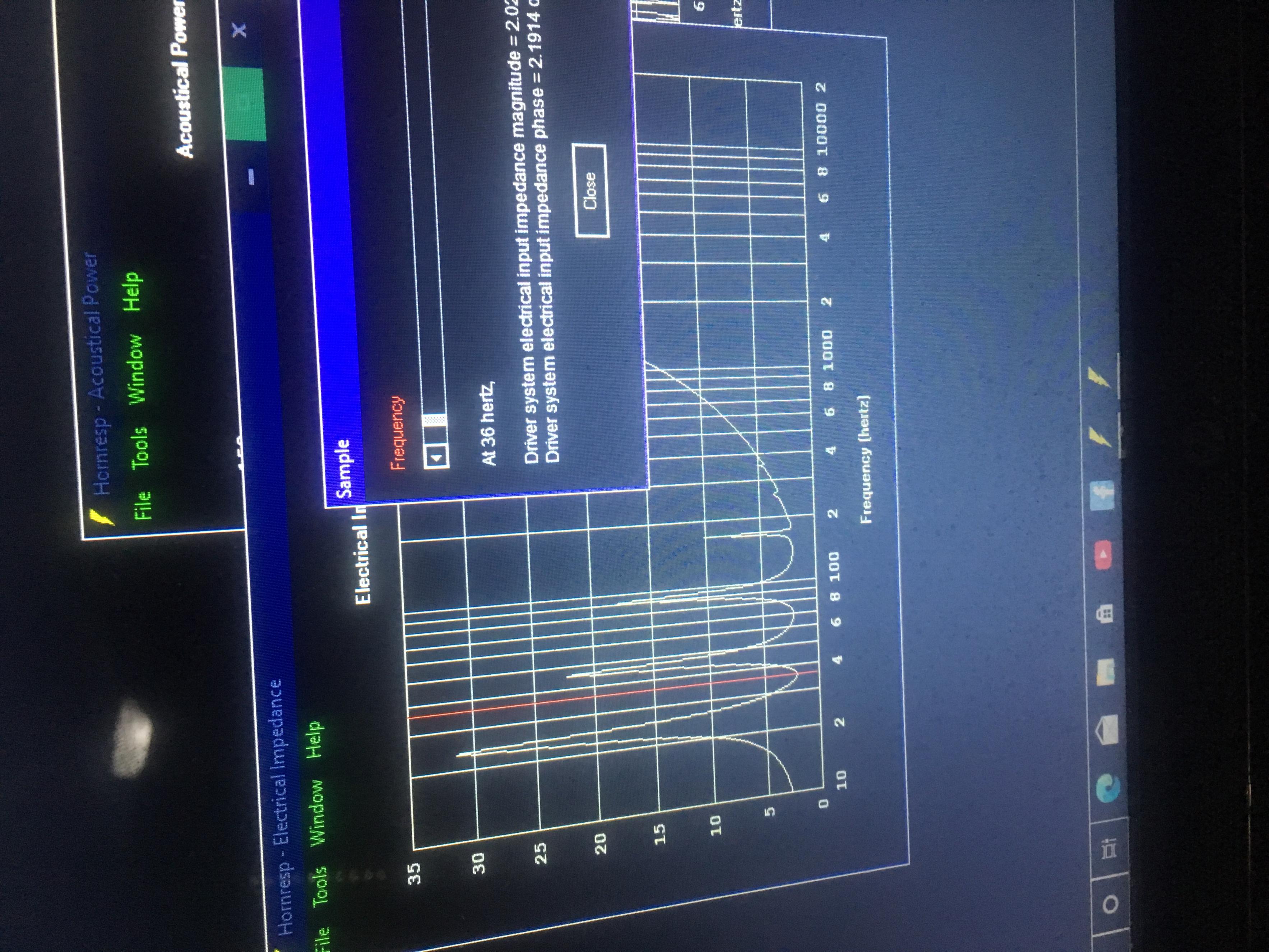

Paraflex 12 single, 160 liter: 38 hz
Using the sim As a ‘guide’ i test toned my way (sloppy hobby geek and not a professional) thorough things such as ‘efficiency’ impedance’ and ‘excursion’ and in a very tight’ boundary that might favor 48, 96, or 192” waves(?) (too many things are suspect and reoccurring) Theres a LOT of things to see on the cone of a paraflex that NOT on a ODTL. but in all of that , there is an observable interesting ‘issue’(even heavily stuffed versions as ‘transflex’ dont quite seem to handle) of transient activity on a cone thats sometimes looks like an epileptic flash in a person if ‘music’.
the things that cone has to deal and maybe helpful in the tornado of transients? are the reasons i hesitate to jump and widen as the CSa at throat and out area Chris refers to for this ? Or, It might WANT to consider a throat area of ‘surge tank’ because of what hes saying is the reason to consider and its possible repercussions? High pressure on both sides or low on both sides is steady state signals, nice and oscillating happy....controlled, but music is not necessarily so pressure -differential- steady state? And is the cone offset by pressure bias too!’?? BL as flux or as inductance issues changing? how quick and then at the distance from the VAS sensation(cone) is it felt? And then fought (Qes) in order to maintain a proper quality of whats being listened to? Its akward to think i could comment and be fair. slo mo camera is nit the answer unfirtunately , it has cycles too🙁
Double acoustic suspension / then ZERO (on one side or the other and twice if pushed?) thats a lot of heavy air to push and shove and react! Friction in surface area? I want small and long, not wide and longer. I think, but im Guessing, All in an instant ? Cone shaped like taco, drivers beware, of the rage inside the machine! Thats no jazz bar! Its helter skelter in there.
Sd 506.7
Qes .32, ((.64 )re 3.9, Le 4-4.2)
Vas22-23
Fs 37-38.4
Xmax15
Pmax 1000.
