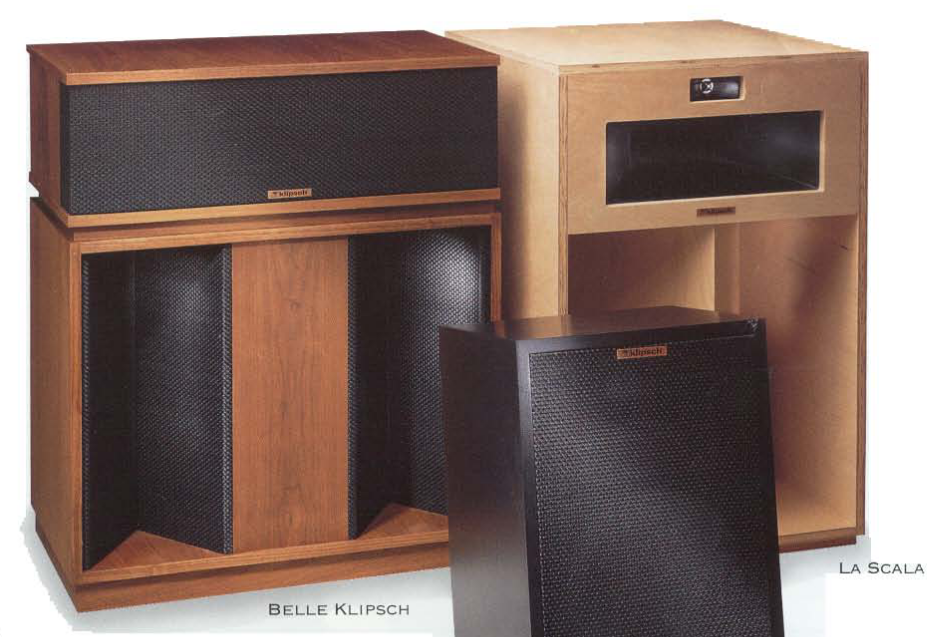

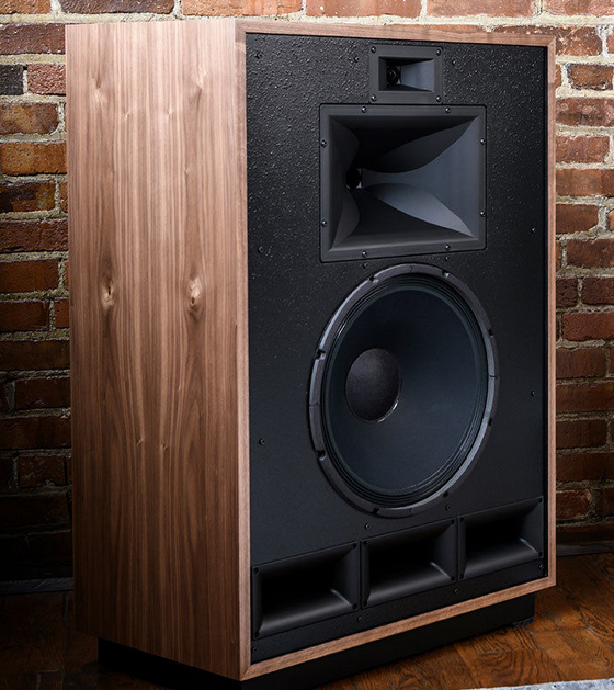

or even the mini-horn-like Cornwallis from Klipsch (I think that's the model)
The Klipsch Cornwall (PWK chose the name as a contraction of corner/wall) has a 15" K-33-E direct radiating bass driver in a reflex enclosure. The La Scala and now discontinued Belle Klipsch models have 15" K-33-E bass drivers loaded by relatively short "compromised mouth" horns.
