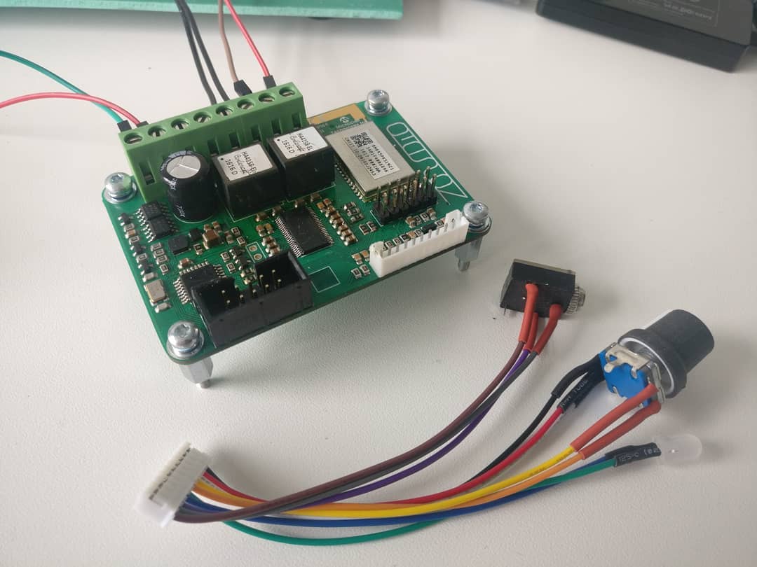

I made a PCB based on the TAS5754M that will be released in the near future:
-DSP (biquads, smoothclipping, bass enhancement, limiters etc)
-2x40W or 1x80W class D amplifier
-Bluetooth v4.2 class 1 module
There are some early versions being tested by early adopters and it looks very promising. Once I am ready to sell I will make a dedicated thread. Do not ask too much questions in this thread, I do not mean to hijack this. More so to show what is possible with these kinds of chips.

It is better to orient the MLCC with their long body side to the shorter pub side to minimize piezoceramic effects and possible stress which may result in cracks. For your shown design this would mean the MLCC around the TAS need to be rotated by 90 degrees. You may also thing about adding an additional center mounting hole to break up the mechanical „plane“. Doing wrong can directly couple into the audio path by piezoceramic modulation. (i.e. knocking onto the board) This is also valid if ceramics are used in voltage bias nets.
I understand your point, but rotating the caps would make layout more difficult and I doubt it would have a large effect, especially on such a small pcb. But maybe I'm underestimating it...
What do you mean by 'breaking up the mechanical plane'? Add an extra mounting hole to reduce flex in the middle?
Correctly.
We examined the influence of piezoceramic effects on a 1.0mm 35x50mm pcb with a TPA3128 which had MLCC as coupling caps and for local AVDD decoupling. Knocking onto the PCB clearly showed a influence on the lower frequency band up to 500Hz. It also where clearly hearable from the output of the speakers. If mounted into an 400 liter basshorn, there was an echo/effect like effect. So yes, flexing does have a signature impact on sound if mounted wrong or having insufficient mechanical decoupling. I can search for the plots if there's interest.
