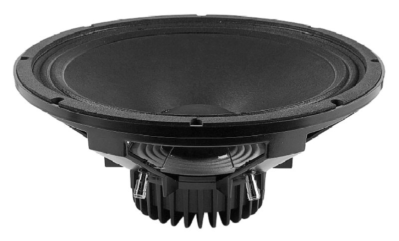

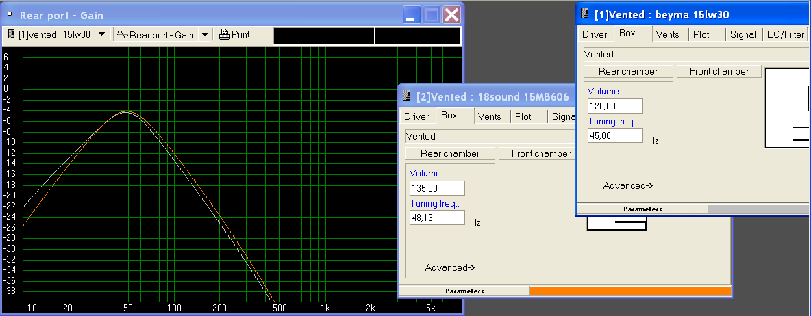

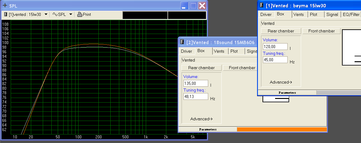

Woofer 18sound 15" cost $230,-
15mb606
Beyma 15lw30
[/QUOTE]
326268d1359124688-looking-recomendations-15-woofers-schermafbeelding-2013-01-25-om-15.36.30.png
326269d1359124758-looking-recomendations-15-woofers-schermafbeelding-2013-01-25-om-15.38.49.png
326271d1359124934-looking-recomendations-15-woofers-schermafbeelding-2013-01-25-om-15.41.34.png
This would make a 100dB 1Wmeter 2way system possible 35Hz-20kHz -6dB. Drivers and horn $763,- for one loudspeaker. And 3way will only increase cost and give less pin point sound stage.

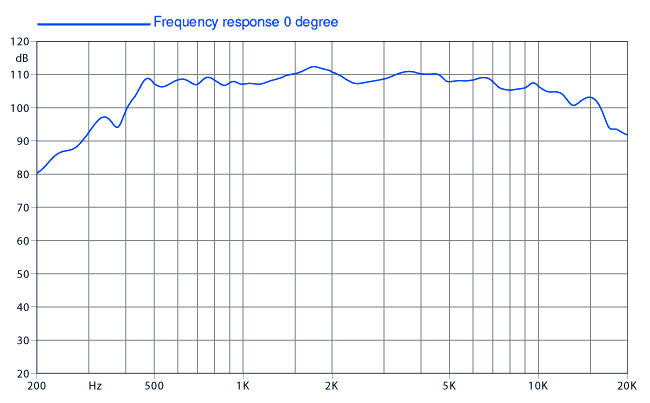

A 1" driver will reduce the cost a lot, only problem poor mid response there are nice ones that do 800Hz.
Like the popular 1" DE250 $128,-
http://www.parts-express.com/pe/showdetl.cfm?partnumber=294-605
Here a nice horn for 1" $200,-
AutoTech Iwata-600 - Horns DIY Sound Group
Will look good with 15" woofer about the same with.
Then one speaker would cost $513,- drivers and a horn for 2 way.

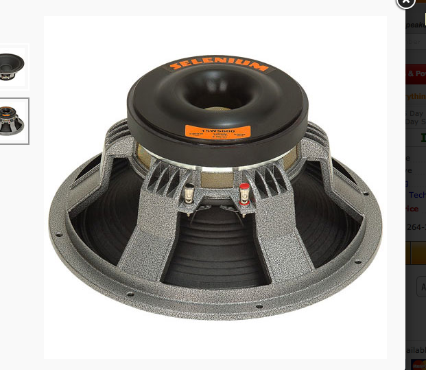

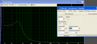

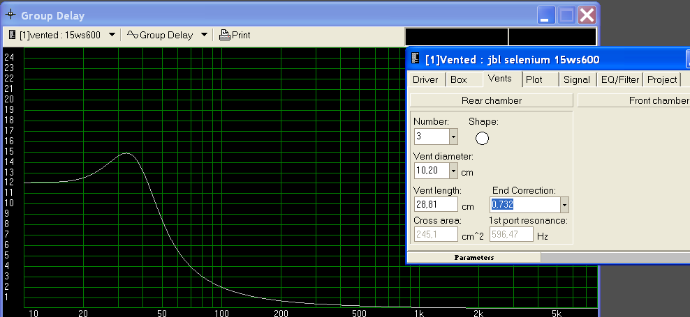

I think that the 2" fatialpro offers very good low response usable down to 500Hz with a 24dB filter. For hifi low power amp input a second order filter will also do. Will make a great precise midrange response.
Faital Pro HF204 - Faital Pro HF204 2" neodymium high frequency compression driver with a ketone polymer diaphragm. Faital Pro HF204 HF drivers available here at US Speaker.

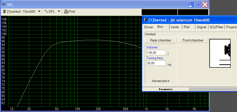

This to gather with the 15WS600 woofer a 97dB system 28Hz-20000Hz XO 500Hz. And the state of the art JMLC 2" horn. Point source 500-20000Hz 🙂😎
For $605,- 2"driver fatialpro, jmlc400, and jbl selenium 15W600.

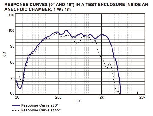

Mid-response of the 15WS600.
attachment.php
if you do that, wouldn't its own acostic-roll-off cause it to roll off earlier...and maybe even faster than 24db
which 'could' lead to phase ....
This is right, then you can filter the woofer steeper so you can match the phase with the horn driver works also fine with my own loudspeaker.
With the steep fillter the woofer can not mess up the clear tight midrange of the HF-driver. A win win situation isn't that great.

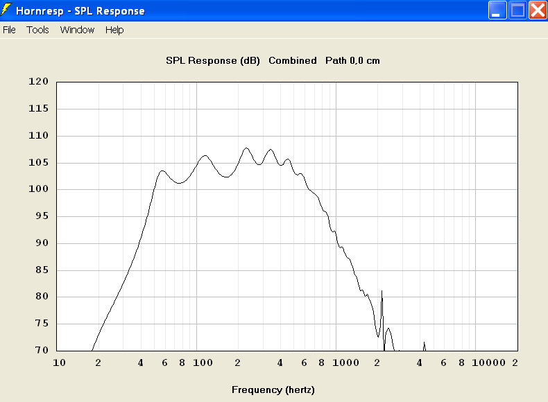

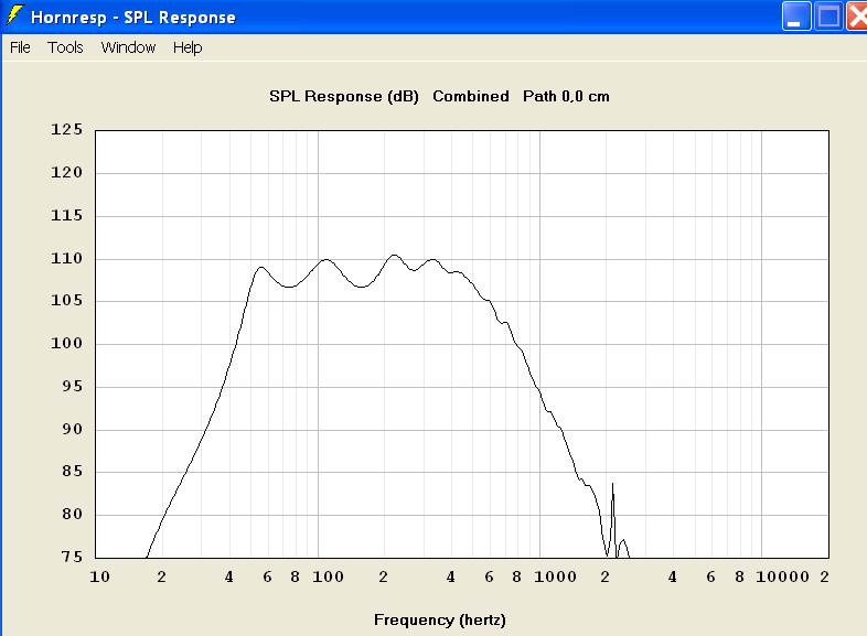

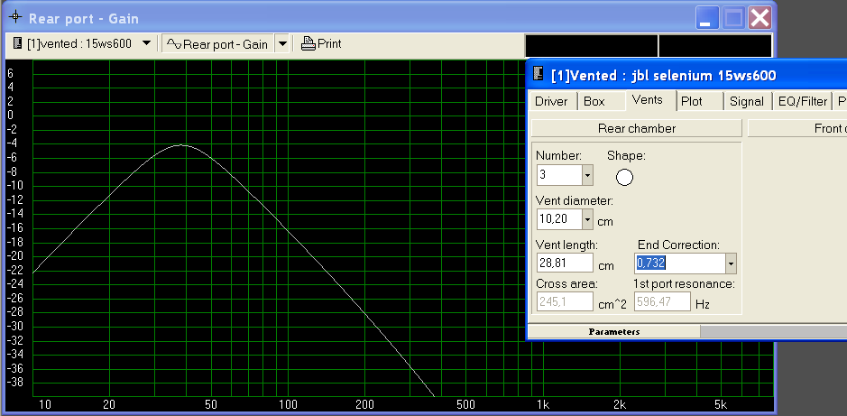

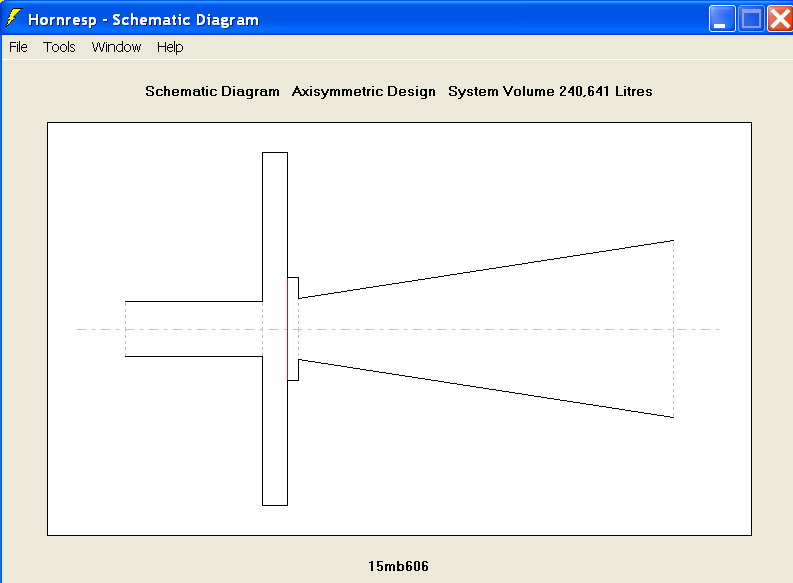

For highest sensitivety frontloaded midbas horn with the 18sound 15mb606, and bas-reflex port for bas extension.
here a nice horn design from volvotreter.
Sensitivety here is for 1pi situation. 108dB 1 W
attachment.php
attachment.php
103dB in 2pi radiation.
attachment.php
