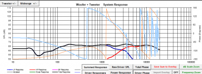

Yea, right on target. Slopes are right where I want them, for the most part.DrNick - RE Post 31.
That looks great. Nice cross over point.
Not really, the woofer has a 2 db hump where it begins to roll that needs to be ironed out. Probably needs a little more inductor and a little less cap or just more inductor. Probably going up to 1.5 or 1.7 on the inductor and maybe a little adjustment on the cap will take care of it. The slope is too steep though, I don't know why I was modeling an LR4 on the woof.Good driver integration. Very flat response.
Yea, it's actually very simple. I have an LR4 slope on both drivers with only 4 components. I think I'll need to reduce the woofer slope to get the phase where I ultimately want it. Symmetric crossovers never work on a flat baffle. They often work with LR4 on tweet and Butterworth second or Butterworth third on woofer, depending... It will fit though, no doubt about it and probably with only 4 components and an L-Pad.Relatively simple cross over.
Look at impedance though. I should have displayed electric phase too to see if there were any high angles. Amps don't like low impedance with large phase angle. The impedance itself isn't as big a deal as the phase when the impedance is low like that. I need to find a different set of L-Pad resistors to pad down the tweet. It's modeled using like a series 2.5 and a parallel 1.4 or something stupid like that. The issue is that with different resistors the phase changes too so it's a "gotcha" situation that could have been avoided if I'd chosen an 8 Ohm tweet. But there are always -alternatives-. And no you can't just do with a series before the crossover, it messes with the fs of the tweeter just like it would with a woofer. With the fs close to crossover like this is with large resistor values it will raise the Q and create a peak in the response. A proper L-Pad pads the tweet while maintaining the correct source impedance for the crossover that's behind it. Impedance is a two way street...

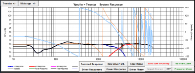

There's always one more thing. I had mentioned this in a previous post and then forgotten. So, here is version 4, with the woofer at -25 mm in z.
and with the tweeter reversed
This is using this session file, and frd and zma files.
http://www.drnicholas.plus.com/Satellite/Satellite%204th%20with%20offset.csp
http://www.drnicholas.plus.com/Satellites/SB Acoustics SB26STC-C000-4 miniphase.frd
http://www.drnicholas.plus.com/Satellites/SB Acoustics SB26STC-C000-4 miniphase.zma
http://www.drnicholas.plus.com/Satellites/Seas H1520-08 U16RCYP modified transformed.frd
http://www.drnicholas.plus.com/Satellites/Seas H1520-08 U16RCYP box impedance model modified.zma
The new crossover has only one inductor, so it is now third order electrically. As there is only one, I've changed it to have a lower resistance.
L2 2.00 mH, 0.1 Ohms
C2 12.00 uF
With a parallel leg over the woofer containing C 20 uF and R 20 Ohms. Before C2 was 15 uF, we had another inductor and only a 10 Ohm resistor in the parallel leg, so not a huge change, just enough to get the phase back in line.
The tweeter is crossover is unchanged from before, and has a third order section
C9 15 uF
L9 0.2 mH 0.2 Ohms
C10 25 uF
with a series resistor 2 Ohm after the crossover, and parallel resistor over the tweeter of 2.5 Ohms.

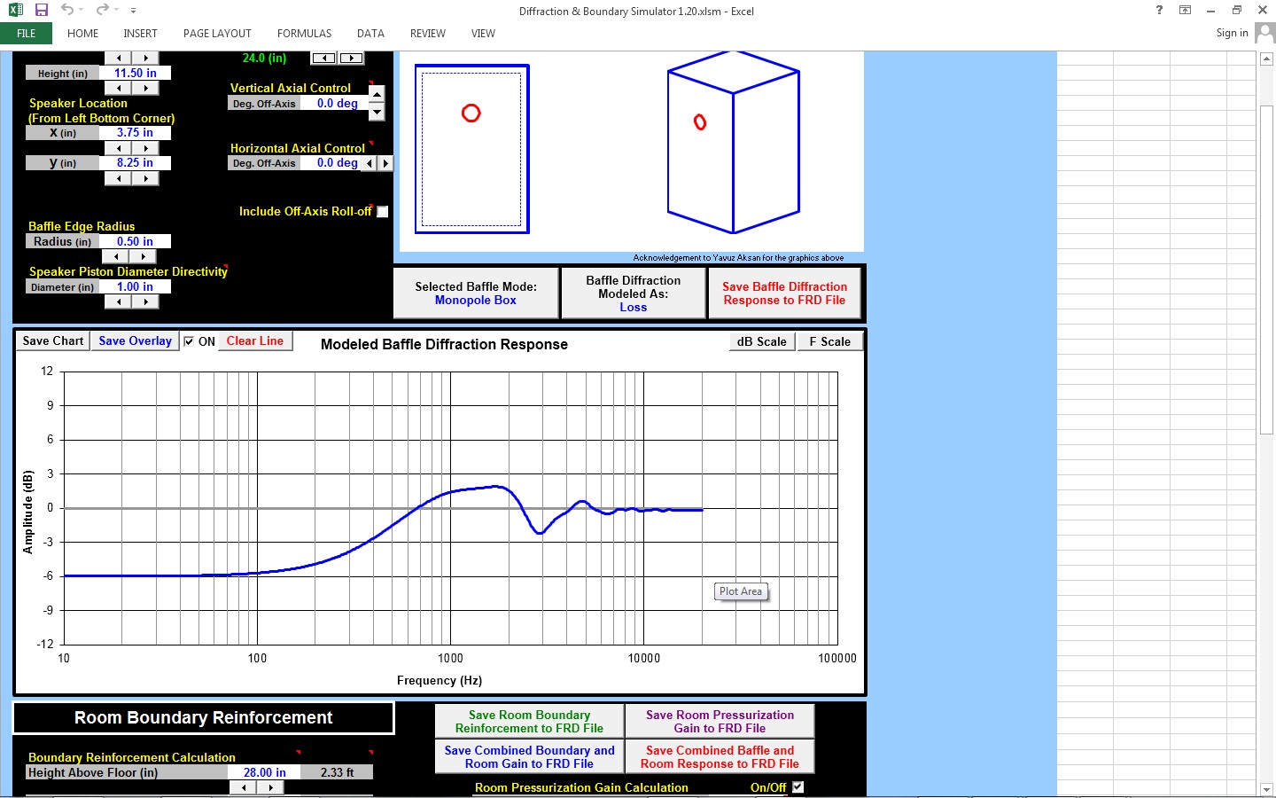

After modelling the system using the Seas U16RCYP, I wanted to see if it was possible to spend a bit less, so I have modelled a possible build using the Peerless 830860 5" midwoofer and the Vifa BC25TG-15-04 12 soft dome tweeter which retails for about £37 and £14 respectively. The woofer seems to model well in only 7 litres of volume, and the narrowed sides mean the baffle can be 164 mm wide by 296 mm high, with 15 mm left around the units so the edges can be radiused by 12 mm or so.
I've used the response modeller spreadsheet to include the baffle step and diffraction, and generate the phase information for the final driver response in the cabinet. The crossover for the woofer is just a second order with a 2 mH inductor and 10 uF cap. The crossover for the tweeter is third order electrically, with a 12 uF cap first, a 0.15 mH inductor and a total of 2 ohms resistance in parallel, and then a 5 uF cap. The tweeter level is then controlled by a 3 ohm resistor in series after the crossover and a 5 ohm resistor in parallel. This gives a crossover at 2.7 kHz, but this really could be higher or lower. The phase tracks pretty well from 300 Hz to 5 kHz. I'm choosing 2.7 kHz rather than going lower as this is a cheaper tweeter and I don't want to stress it. Also, this value worked well with the values of the inductor to give baffle step compensation for the woofer. There is 1/12th octave smoothing on the frequency responses, which I traced from the manufacturer's pages using SPLCopy. Some retailers seem to have out of date specifications on their web sites.
The overall response here is within +/- 1.5 dB of 84 dB over the range 160 to 13 kHz, which seems fair given the modest cost.
The system response is as shown here

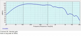

I finally have the crossover for the Visaton HT / Vifa speaker. After listening to it without BSC it sounded thin and horrible so I had to go back and add BSC (Baffle Step Correction) plus a notch filter for the tweeter. Below is the final expected response. Ignore the peak at 200 Hz, it's a measurement anomaly. The crossover has 11 components the largest being a 2mh coil on the woof so even though it uses a lot of parts it will be easy to build and fit in the box.
Nearfield measurements place f3 at about 83Hz in this .23 enclosure so it goes down quite a bit lower than what you're modeling. I'd build a .25 for an expected F3 of about 81hz.
Cool. Looks nice and flat but why is it at 65 db though? Is your measured frd file not at 1W, or can you normalise it to 1W?
It's not measured at 2.83 at 1 M. That's a simulation from PCD. I haven't measured the speaker yet and when I do I'll have to splice it together. I'll take a gated response down to 200 then take a nearfield below that and splice it together. Actually that crossover is OK but probably excessive for this speaker. It's better to just correct the glaring issues and get on with it. This is nearly as good and it only requires 6 components. It's a toss up whether a $50 worth of drivers is worth $30 in parts to make changes that are, in the end, barely audible.
But will post them if you want.

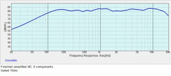

Just got it wired up and starting measurements. First is Gated measured very near 1 meter. Sensitivity will end up being about 82 or 83 db 1w/1m, maybe higher.
Second is nearfield on woofer showing slope. I'll bop into Excel and patch them together later tonight or tomorrow. Actually, after all the hassle I had with this it's a decent little speaker. It could use another ohm or two of padding on the tweeter which I'll do tomorrow but it's a decent deal for $100. As odd as it seems most speakers that measure flat on the tweeter sound hot and/or harsh. This doesn't sound harsh but it does have a slight edge. A little more padding, probably 2 db will fix that. I've listened to it before this version and its OK once it's padded down enough.
Thanks for posting the frd files. I just wonder if you have some resistance in series with the woofer in the PCD crossover model, to drop the sensitivity so much?
No I was measuring them at very low levels. Probably around 1 volt. I don't have a volt meter on the output although I probably should. I don't want to cook my tweets, it takes 7 days to get a replacement and they cost $18 plus shipping.
I have a very high noise floor here, it's about 50db avg all the time. I can set the mic with the SPL meter and measure a nearly constant 45-60 db background rumble. I'd have to really hammer the tweeter to get a clean measurement over that noise. Omnimic uses a CD for it's excitation. Optionally you can use the sound card directly but you can't choose which track you want when you use the sound card. There is a track on the CD with a frequency limited sine sweep 500hz and up I think, that I could use but I'm lazy and didn't use the CD. I really should try it. But it won't make any difference in terms of noise.
