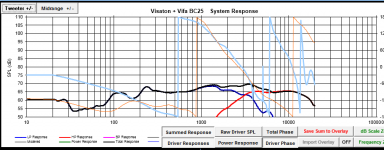

This is the PCD graph I have but it's the old baffle. I need to move the woofer forward a little and move it down, then re-valuate the crossover. It's not bad the way it is but the tweet is mounted on the edge of the top of the baffle. Plus, if I move the woof forward a little the phase tracking will be closer in time. Right now it's 21mm behind the tweet. With the new baffle it will be very close to zero Z axis. That will make the phase lines almost line up in the graph which should sound better as well. But, as with anything in reality it might change other things as well so I'll need to re measure and go over it again a few time, then assemble and listen and ...
THIS IS NOT INTENDED AS A FINISHED CROSSOVER
Woofer second order electric
1 mh coil
7.8 cap
Tweeter third order electric
12 mfd = 10 mfd + 2.2 mfd in parallel in series
.15 = .18 mh parallel to ground
90 mfd electrolytic or 80 mfd electrolytic plus 10 mfd plastic bypass to sweeten it up a bit. I would never put an electrolytic in series but in this case it's parallel and probably won't have any ill effect since it will be passing very little signal. Bypassing it with a good plastic will reduce or eliminate any harshness.
L-Pad
Series 7.5 Ohm resistor
Parallel 8.5 Ohm resistor
As you can see from the plot I have a ways to go to get the slopes the way I want them but phase is tracking over most of the usable range. The woofer phase crosses the tweeter about 200 Hz and track it till about 6K, but I can do better. I just didn't put the time into this version because I'm going to re cut the baffle. My version won't have any BSC and for sats you probably won't want any either. I'll get better measurements when I can set up over at the shop where we have a 40' ceiling.
Tom

I've had another look, and if I use the Response Modeller to extract the phase, but do not add any box effects, on the basis that this data was taken for a 10 litre box, I can adjust the crossover and get this as the final response
which seems +/-1 dB from 100 Hz to 10 kHz and then has a hump up to +2 dB to 20 kHz. At the bass end the response falls off from 100 Hz and is 3 dB down at just under 80 Hz.
Just to be clear, I've used the box model for a 7 litre box with the correct T/S parameters to generate the impedance curve, not the one from the specs, which is for a driver with no baffle. I take it this is the correct procedure?
The crossover for the woofer is third order electrically
L2 2.00 mH, 0.2 Ohms
C2 15.00 uF
L3 0.50 mH, 0.2 Ohms
With a parallel leg over the woofer containing C 20 uF and R 10 Ohms.
The tweeter has a third order section
C9 15 uF
L9 0.2 mH 0.2 Ohms
C10 25 uF
with a series resistor 2 Ohm after the crossover, and parallel resistor over the tweeter of 2.5 Ohms.

I modeled the new position using the old sweeps and it looks better already. Phase tracks much closer over the spectrum. This will be a decent little speaker.

That looks great. Nice cross over point. Good driver integration. Very flat response. Relatively simple cross over. Just to be clear though, you did enter driver offsets? Woofer z should be something like -0.025 if using the newer version of PCD. The older version should be 25.0 or something iirc.
This shouldn't make a terrible difference, it's probably fine.
