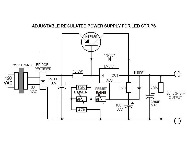

Back in spring 2019 I replaced the under-cabinet lighting in my kitchen with Luxeon mid-power LED strips, 4 strips with a total draw of 400mA at 34V, all 4 strips put out a total of around 4300 Lumens at full brightness.
That's about 300 watts worth of light, plenty for the kitchen counter lighting.

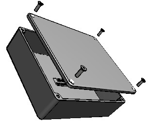

But I wanted a simple noiseless supply that was adjustable/dimmable and compact, tucked inside one of the wall cabinets, with an easily accessable power switch and knob through the bottom of one cabinet for control.
I chose a Hammond diecast aluminum box, containing a low-profile transformer, my own dimming supply design, and having ultimate reliability.
Naturally, It's got my trademark "over-built" design, I just want to make something once, and not have to fool around with it again in my lifetime.
The LM317 regulator and power transistor are on a heatsink and that is bolted inside to the case, to add to the heat-dissipation properties, although it never gets beyond slightly warm.
And it works beautifully the past 4 years!
I can dim the lighting to a 'night light' level, or full brightness, for cleaning the counters, doing dishes, or preparing food.
No 'design errors' here, I can assure you!
And the cost of all parts was very reasonable too.

@wiseoldtech: Nice! Next time you could consider using Schottky diodes, a way lower output voltage transformer like 22V and LT1085 or LT1086 which have 1.3V drop and no pass transistor and 5W resistor needed. Again a few Watts of heat saved. Just thinking out loud.

Thanks J-P, but those LED strips need 34.8 volts for full brightness, and are night-light dim at 30 volts.@wiseoldtech: Nice! Next time you could consider using Schottky diodes, a way lower output voltage transformer like 22V and LT1085 or LT1086 which have 1.3V drop and no pass transistor and 5W resistor needed. Again a few Watts of heat saved. Just thinking out loud.
Each strip contains 2 strings of 12 LEDS in series, both strings are paralleled.
A 22 volt transformer would only give 31 volts DC directly (22 x 1.414 =31).
I mis-quoted my earlier mention of current for those strips. - at full brightness (34.8V) each strip (24LEDS) draws 200mA, for a total of 800mA from the power supply.
The 30 volt Triad transformer is rated at 1.2A, and barely gets warm.
@jean-paul
Yes, J-P, I understand that.
But even a 24VAC can only produce 33 volts DC peak if used directly to the LED strips I use.
And at that 33 volts, they're only at around 80% brightness.
At 30 VDC, they're a dim glow.
My design gives a full bright light at 34.5VDC, just under the Max level of 36.8VDC rating of the strips.
I'm not worried about a few watts or heat, in operation the system draws only 34 watts from the 120VAC plug, gives me 300 equivilent watts of brightness, and the box when touched is barely above room temperature if left on for hours.
So it's like having a dimmable 75 watt bulb above each countertop area in the kitchen.
