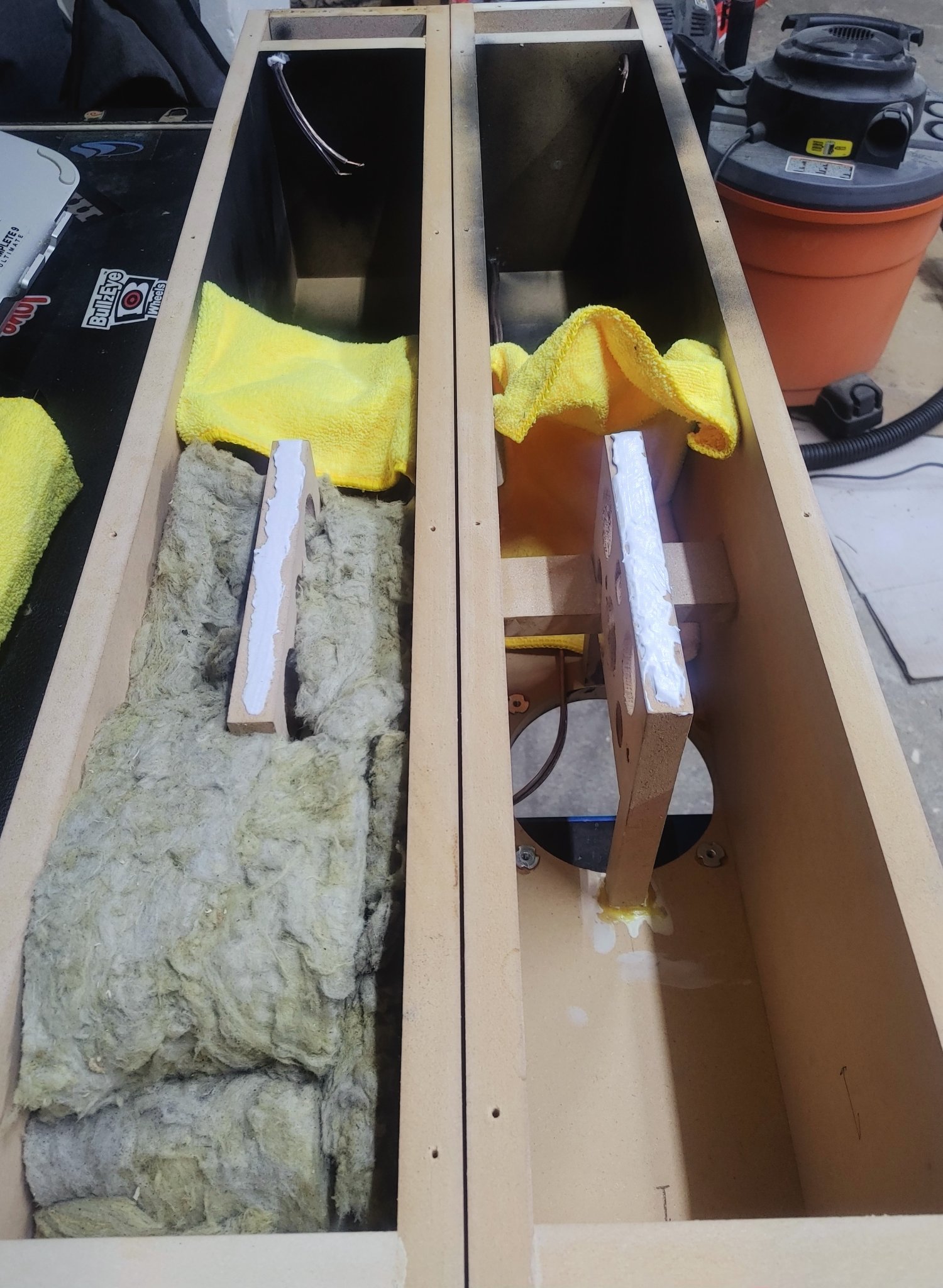

Driver is at .536345776 .... hopefully that's offset enough 27.3 / 50.9 Or do you multiply the total by that? Actually driver is at 0.349 going by total length.
PORT:
at 0.848 = 66.31 from top - I think this is my pref.
at .714 = 55.8 down...
.651 = 50.9 down... oh that's the same as the driver from the bottom! definitely not doing that. Though, it may be high enough the babies won't drop things in the port.
PORT:
- Full Range
- Design Check/Input TABAQesque with TB W5-2143
