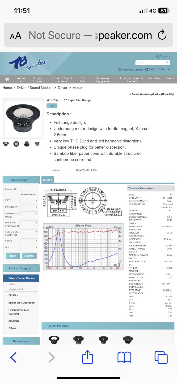

Ok, I have a design I like a lot (little more deep bass).
Learned you have to hit Edit on HR to use all those wizards, and view the stuffing, etc... NOT super intuitive, lol.
Take a look (if you would) and tell me if you note any issues...
One thing I still can't tell: Is the port an offset pipe? A bottom loaded TABAQ slot?
Thanks!

If you model it as a TL then the port is at the end, with the final section being the port.
If you do it as a MLTL from the start you can have a separate port, which you can place a distance from the end, typically between last and second-last sections. Using a little bit of offset smooths out the response a bit, but it's usually less than what the filling does and possibly not worth the bother. If you're going with a slot port it's simpler to put it at the bottom.
Also, if you double-click on S1 (or any of them) you can have stepped transitions and you don't need that .01 section.

I double click them, then I get S1S, S2S, etc. in the first row.
Changing CON to .00 just gives an error, then I got errors on L34, until I got it basically turned back to the way it was.
So with the current modeling, I can just take the port config (S4/S5, CON) and make it a slot? Or do I have to start from scratch as a TL?

those TB 5 » drivers start beaming horribly early. They need tweeter support.The width and depth of the internal dimensions need to be sufficient to accept the driver. From the pic (in metric) the driver is 155.5 * 85 mm. I’ve seen some commercial boxes where the outer part of the driver partially overlaps the sides so to be as narrow as possible.
Having built 3", 4" original TABAQs, and the 5" Large, I can't recommend the 5" myself.
Their low end is pretty much the same as the 4" , they are much larger in a room, they beam rather early so if you are a few cm/inches away from straight on, you'll lose the highs right away.
The 5" cone still does not move that much air, and for a slim tower, I much prefer the SBA 5x8", as they perform very nicely in a TL/MLTL, and supporting them with a smaller FR. Then, that's the best of both worlds.

You don't need a zero length section at all. You just make the end of one section whatever area you want, and the beginning of the next section does mot need to be the same area. It can go from 100 to 200 for example.I double click them, then I get S1S, S2S, etc. in the first row.
And yes, you can configure your end section to a slot but don't make the aspect ratio too extreme.

I do recall discussing this with the friend who will be taking these.those TB 5 » drivers start beaming horribly early. They need tweeter support.
He's heard my 6.5s (W6-2144), which are going to beam even more! Granted, I do like to sit in the sweet spot as much as I can when listening to music... if I'm not in the sweet spot - I likely have a friend I'm showing them off to, and don't mind...
OR, I'm just watching a movie... in which case I don't find the beaming to bother me, even if sitting off access.
I actually tried to convince him on the 4"... (my next personal MLTL goal), but he wanted to go all out, and go for the 5s. I like the look of the 3s, but I do feel one would need bass support on those. And, I have some B3N's already... So W4-2142 is definitely a goal to get into my LR at some point.
