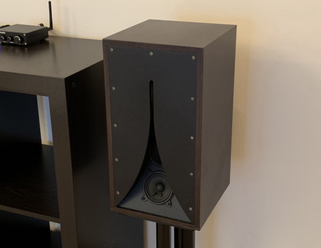

If sensitivity is important, I agree it’s tough to beat Faital Pro 3FE25 as Perceval points out. But you can double that sensitivity by using dual parallel 3FE25-16 in mini Karlsonator. That speaker combo has been verified to work really well with low power Class A amp like the ACA. Its sensitivity is theoretically 91dB +6dB for the parallel driver connection.
Mini Karlsonator (0.53X) with Dual TC9FD's

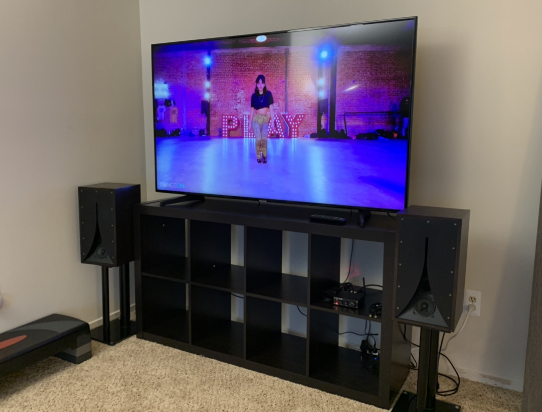

However, you would need a small stand - which in my view is worth it. Here is what they look like on a small stand - we are using them as the mains for a TV in the dance studio. These were a set made following the plans by jhofland and finished in 15 coats of hand rubbed lacquer over espresso brown stained BB plywood with baffles covered with Duratex in black.

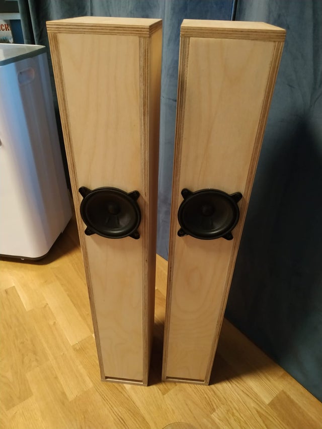

I think the 10p in the Pencil is your best option and worth every dollar.

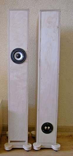

But, a slimmer, smaller and less expensive option is a version of the Castle referenced above, using one driver pair. I recommend the CHR-70 driver. This speaker is readily built using just one 2’ x 4’ sheet of plywood per channel.
MARTELLO-2, a mini-tower from a single 2' x 4'. - I used the now obsolete EL-70, you can use the CHR-70. These are small enough to flank a TV and be a real spouse pleaser. Bass is very good.
Both of these options have been used with a low power tube amp with great results!
