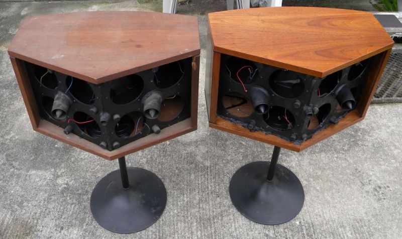

But each rear panel is angled at 30 degrees, not all energy would be displaced in the same direction only about 4.5 db per angle . or is this incorrect ? always thought the rear panel 30 deg angles were for dispersion first and imaging second ? never read anything alluding to the why for the rear angles except what was said in Amar G Bose AES paper "sound recording and reproduction parts 1 & 2"
The rear elements are fairly directional on their own. When you split them into banks of 4 then they become a pair of even more directional arrays. The idea of the 30 degree angles was to reduce the energy to a wall bounce placed directly behind the system and send more in a left and right direction. That would encourage multiple bounces and a more diffuse sound field from the reverberant energy.
The -9 directivity index applies whatever the exact polar pattern. It determines that the early arriving direct sound is relatively weak compared to the reverberant sound. The question is what is the best proportion of early vs. late energy, and what is the proper frequency balance for the 2 components.

If I had a couple of 901 cabinets to play with, I would give each of the 4" drivers its own little back chamber with damping & xover them to cut them off at 200 hz, add a front firing tweeter and use most of the volume of the enclosure for a decent sized long excursion bottom firing woofer or two that could possibly be ported down a (widened) support post and radiate at floor level, then xover the whole thing to shitcan the external equalizer.
The 4" Bose drivers have about the same amount of linear excursion as a 2" compression horn driver so would welcome help at LFs as well as at the top end. Your sheetrock won't be rockin' above 5Khz anyway.

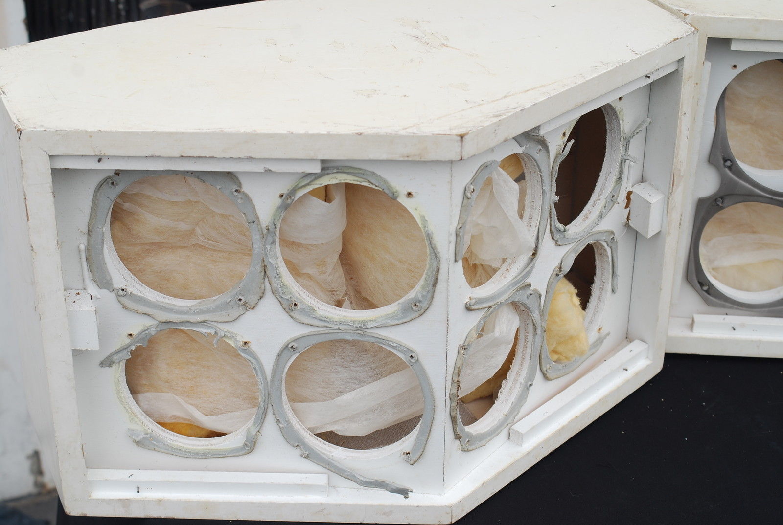

Unfortunately you would not have enough room inside the cabinet with a Bose 901 cabinet ( especially after series 2 when plastic was introduced..lol....It could be done with a properly designed 3d modeled home built cabinet ( 3d modeled )so you could really tweak the internal volume to what you are after without having to build and re-build till you get what you want.

I don't know. You might be able to get two 8" woofers at the bottom of each cab, especially if you ditch the plastic baffles that aren't doing any sonic favors and rebate the 4" drivers in baltic birch a little closer to the grillclothes. Then you could have Bose with highs and lows.
I've done a few custom built systems where the midrange drivers were 901 drivers, four off, mounted around a CD driver, they are very efficient and can handle heaps of power (edge wound flat aluminum voice coil wire wound on an aluminum former) and some of the higher MK order cones have rear cone treatments and tapered thickness profile cones to help tame top end response problems..
The plastic baffles are part of a full plastic inner cabinet. It is divided into 3 cavities with one for the front unit and two for the two groups of 4 on the back. All have the same volume per driver and are equally tuned. Cutting into it at all would be very messy and would have to sever the partitions.
No room for a 10" unit here. A better approach would be just to add a subwoofer. It would reduce the large amount of LF EQ normally applied.
