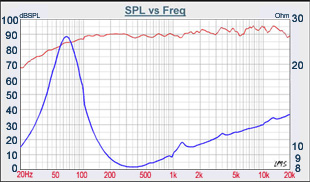

Well first I am looking at choosing the right drive unit that would require the least amount of equalization , lowest fs smoothest response curve and in this day and age the choices seem plentiful and at the top of the list so far is the Tang Band W5-1611SAF 5" Full Range Speaker.
Nominal Diameter 5"Power Handling (RMS)28 Watts
Power Handling (max)56 Watts Impedance8 ohms
Frequency Response 60 to 20,000 Hz Sensitivity 90 dB 1W/1m
Voice Coil Diameter 1"Magnet Weight 18.6 oz.
THIELE-SMALL PARAMETERS
Resonant Frequency (Fs)60 Hz DC Resistance (Re)6.3 ohms
Voice Coil Inductance (Le)0.02 mH Mechanical Q (Qms)2.8
Electromagnetic Q (Qes)0.52
Many more to choose from this is just the first one I have landed on that I really like , if I can believe that curve that TB shows it looks overly smooth to me.

From my relatively brief exposure to the 1611, I'd describe them as "as smooth as the graph might imply" - in other words I found they had great bass extension and weight, but were a bit shy at the top couple of octaves -compared to say a Fostex FF125WK or Alpair 7.3 or 10.3. Of the few TB's Ive heard, I was much more impressed by the W4-1879 - albeit at almost 3 times the cost.
My personal opinion of the 901 and Bose in general aside, if your goal is to pay homage to the concept with modern gear, I think it's fair to say that you could get there with far less than 9 drivers per side, and of course with DSP, the EQ and room correction is far more affordable and flexible than 45yrs ago.
It's hard to believe TB curves are so smooth, look at a Mark audio unit or Fostex or Dayton and it looks more realistic not as perfect as TB in fact all the drive units I have looked at show a more realistic slightly bumpy ride from 60hz to 20khz. Then again TB units get mostly very good reviews , when I find the ultimate driver I am going to buy 2 and use them for my computer speakers , single driver per box and see how I like them.
