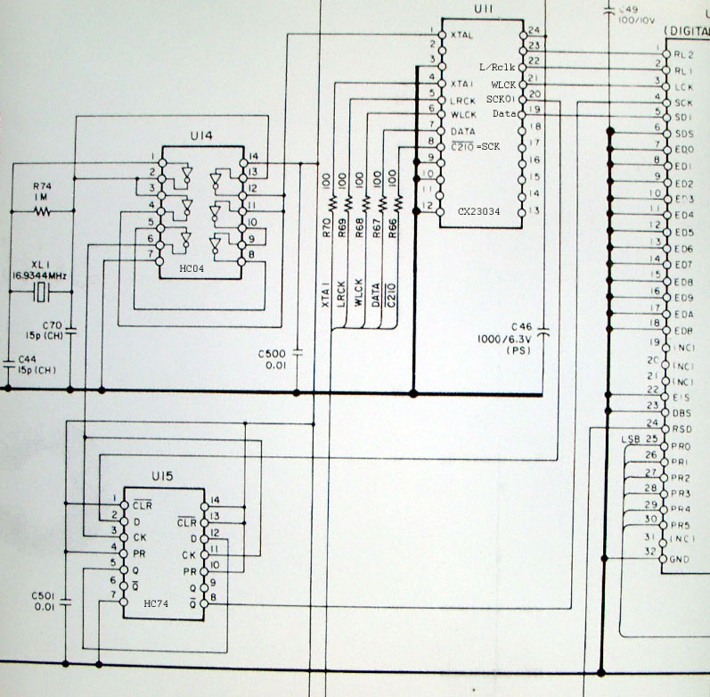

I have a player that has CX23034 in front of the DAC and with bypassed CX23034 it still works.
Now I want to use the DAC of that player with CS8412 receiver with or without the CX23034 . Is it possible ?
The DAC uses bitclock, wordclock, data and L/R clock.
Or would it be easier with Yamahe receiver YM3623B ?
Why does the Yamaha use a crystal ? Better ?

No. You will not get I2S out of this DSP without a considerable amount of glue logic. The CX23034 is strictly a Sony format device and I mean Sony not Sony/BB.
For the input to the CX23034.
Pin5 = LRCK@44.1KHz
Pin6 = WCLK@88.2KHz
Pin7 = Serial Data (Two's Complement MSB first)
Pin8 = BCLK@48Fs (2.116800MHz)
You need the TDA1543A
ray.

Not really a name, it is inside a Teac ZD3000 and uses CX23035 -> CX23034 -> Teac chip which has inputs L/R clock, L/R clock inverted, data, serial clock, word clock -> 2x PCM53.
I post schematic.
I post schematic.
You need to reformat the output of the receiver to match the input or the output of the CX23034.That means going from a 64Fs clock domain to a 48Fs one.
Send 32 bit per frame data to a shift register, copy into another register and read out with new clock and 24 bit per frame ?
Isn't that recklocking as side effect ?
Also CS8412 provides only LRCLK or WCLK, not both at the same time.
1. Use a Sony SPDIF receiver that outputs the necessary format.
2. Use a generic SPDIF receiver and some logic.
3. Design your own SPDIF receiver.

rfbrw said:1. Use a Sony SPDIF receiver that outputs the necessary format.
Any recommended Sony receiver ? From where take out ? DAT ? Model ?
Joined 2002
rfbrw said:CXD1076

Applies only if it's a normal Sony (In fact, every Sony CDPs I opened) :
CM made a circuit to convert 3 different EIAJ formats to I2S.
http://www.diyaudio.com/forums/showthread.php?threadid=58564
As for SPDIF, in a Sony CDP, it's not on the digital filter, but on the drive controller that you're going to find it. Try to find a DOUT pin on the transport PCB or the chip between the transport and D/F if there's one.
You have a lot of chances to find a DOUT pin on the DAC PCB and transport PCB. There's going to be an MD2 pin also, and you need to pull it high, make sure it's not presently grounded.
