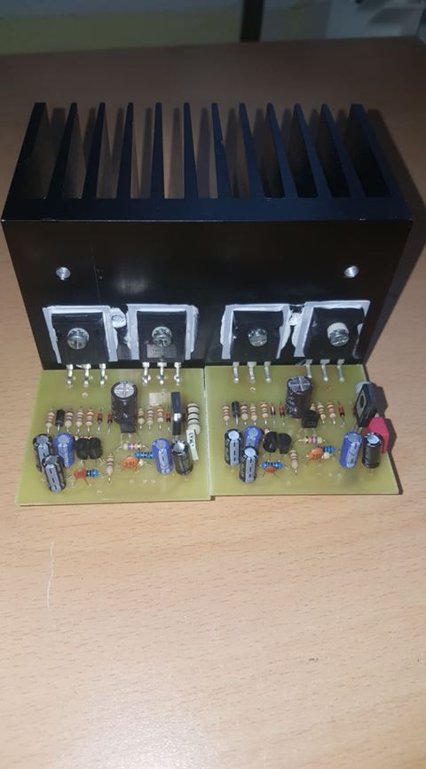

An idea of the result. The two board will fit if you not use too high caps. The output board is the one without Cx caps.
