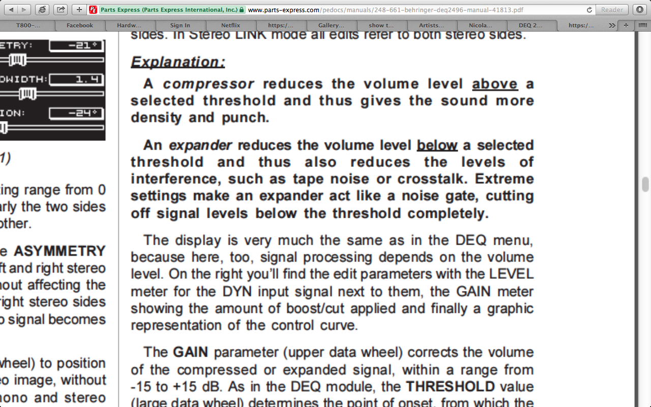

For those who can't follow the detailed method explanations for how signal processing works, you can simply refer to the manual and read a description of how the Behringer DEQ 2496 works.
https://www.parts-express.com/pedocs/manuals/248-661-behringer-deq2496-manual-41813.pdf

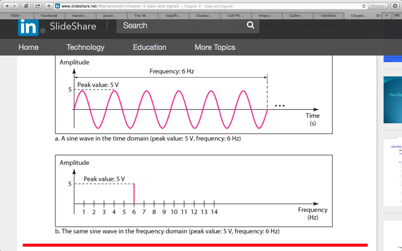

The volume of a sound is determined from its amplitude, peak to peak magnitude.
The DEQ doesn't boost amplitude modulated waves. It converts them to a different format, this format is not inherent in the DA Conversion and digital storage of an amplitude modulated wave, but is a mathematical process for converting the signal to a different mathematical space.
So stop thinking about how a DA converter works, and realize this is a different concept.
If you look at the axis of the graphs, of the examples you can see this is not a wave anymore, it's the signal represented in the frequency amplitude domain, which is a different mathematical space. It is not something you can play through your amp and have music. Each discrete point on the axis represents a frequency, and on the other axis the amplitude (voltage).
The signal has been converted into a large number of simple sin waves. These are not frequency bands obtained from a band pass filter applied to amplitude time domain signal.
It literally uses math to make up a large number of sin waves at different frequencies. You can now think of these all as separate independent channels. The "channels" are the discrete gradations on the axis of frequency , on the graph of frequency amplitude in the new space.
Each one can be manipulated independently of another. This is how you get the gain of any of these individually. With a code you can ask a program to set a threshold, and increase only frequencies below the threshold, or above, both, make one increase, one decrease, whatever you want.
Once you are done you recombine the signal and convert it back to a normal wave that you are used to thinking of.
The real question is how do we come up with all the individual sin waves from a complex signal? And that is where the Fourier transform comes in. You don't need to understand the math, but just know that is the tricky part to understand and the math is how its possible. Not the process of DA conversion, or some property of how digital audio is stored.
I know this is not easy to understand if you have not studied it. Not trying to be an *******. But to put descriptions down that are air tight with all aspects described in detail requires volumes of books. So if you can understand the concepts and keep going maybe we can get somewhere instead of trying to trip each other for not posting bullet proof statements in the court of DIY audio law. lmfao
I specifically defined what I mean by dynamics because there are many interpretations of that word. As you can now see from the manual I am just clarifying what the DEQ is doing. It adjusts the ratio of loud to soft sounds. It functions continuously.

I don't think you understand. 2 instruments playing together. FFt it. You get a bunch of sine waves of differently amplitude. How does the processor know which sines belong to which instrument? It can't. You really don't understand the concept.
