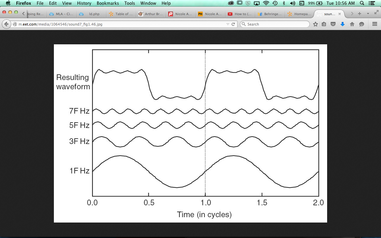

so charles darwin ......digital signals are frequency time domain signals, they have been transformed to the frequency domain, and each frequency is stored with its own amplitude. The signal is decomposed and stored in frequency and amplitude components. So there is no one single amplitude level in a digital signal, there are multiple different signals of different frequency and amplitude stored separately. It would be very simple to filter them based on amplitude and make some gain or cut.
You have to do a Fourier transform , and replot a signal in the frequency time domain to understand it, but basically these multiple frequency components are recombined when you do the inverse Fourier transform, and this give you again an amplitude time function which only has a single discrete volume level at a given instant.
It is the principle of superposition that this is described as. Reconstruction of any complex wave form out of sinusoidal components.

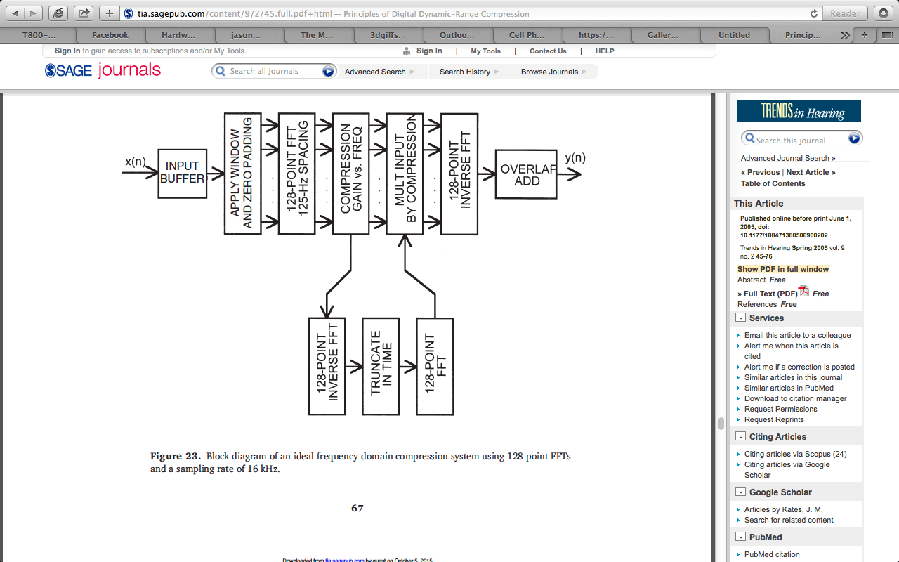

Google Fourier transform and think about it. When you come back consider this article about how a hearing aid is designed for dynamic compression.
if you still think i am talking nonsense and making this all up please note this paragraph which verifies the idea I have presented is valid.
Frequency-Domain Compression
The filter bank represents an approach to timedomain
processing. The input sequence is convolved
with the filters one sample at a time, and
the output sequence is formed by summing the
filter outputs. The compressor operates independently
on the signal levels estimated for each filter.
An alternative approach is to divide the signal
into short segments, transform each segment into
the frequency domain, compute the compression
gains from the computed input spectrum and
apply them to the signal, and then inverse transform
to return to the time domain.
see pg 65 of the following article
- Principles of Digital Dynamic-Range Compression

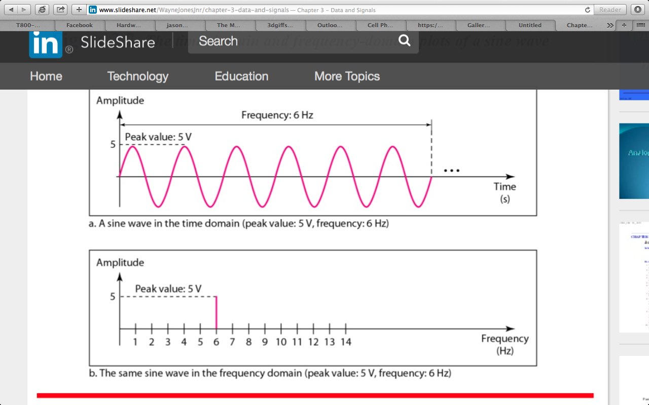

oh and back to the discussion on dynamic eq and how it works, I would still like to hear why you can't manipulate loud and quiet simultaneous sounds separately?
I think its just conceptually difficult to see how it works when you are used to amplitude time signals.
If you just look at how a frequency time signal works it seems really simple that you could manipulate any frequency based on its amplitude.
http://www.slideshare.net/WayneJonesJnr/chapter-3-data-and-signals
The next thing you have to understand is with math you can take apart any signal and make a bunch of simple sin waves like this, when you put them back together it makes the original signal.
this is the principle of superposition
