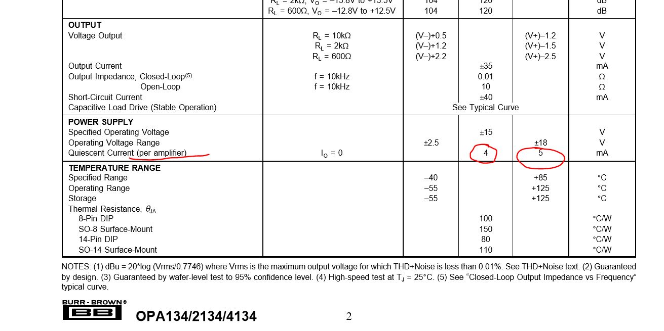

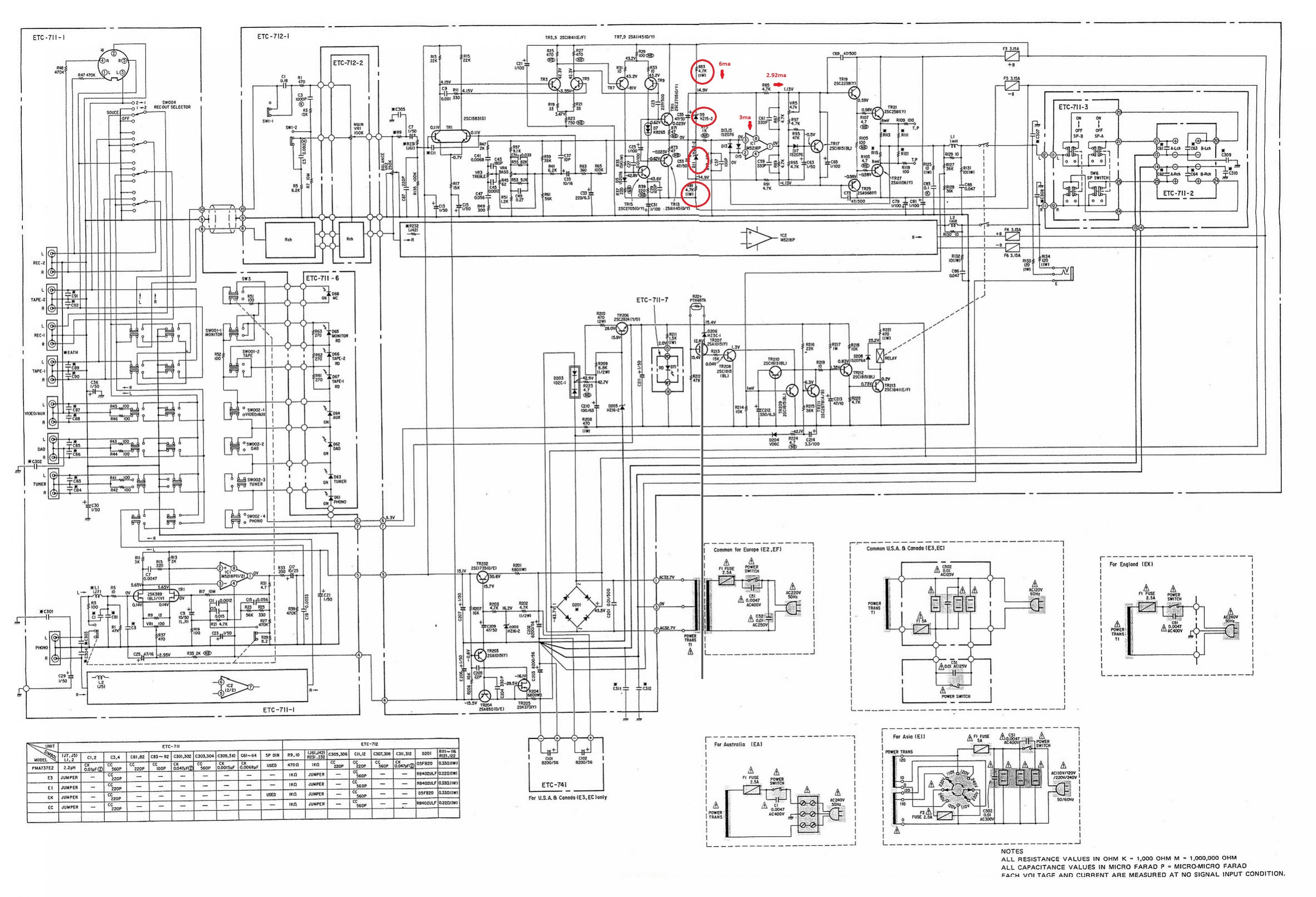

Hello.I also have this amplifier Denon PMA-737.Looking at the schemating ,resistors R81,R83 (4.7K) that feed the D9,D11 15V zener diodes provide about 6ma.Isnt it a bit low?
Even with original values shown,M5218P draws 3ma total and about 2.92ma are drawn by R85.nothing is lft for the zener to regulate properly.
A member used other opamps there like OPA2134,LM4562,NE5532 and claimed problems appeared like distortion,not being able to control the quiscent current and oscillation.
current demand for these opamps are:
M5218P: 3ma total
OPA2134: 8-10ma total
LM4562: 10-12ma total
NE5532: 8-16ma total
way above than the 6ma that the circuit can provide. the problems that appeared above (distortion,quiscent current) are propably due to the lack of current.
My thought is to make a current of about 4-5ma for the zener to regulate properly,plus the 2.92ma drawn by R85 and another 10ma for the opamp so a total current of 17ma through R81,R83 by using a 1.3W zener and a combination of 2x 2 Watt series resistor for each of R81,R83 mounted vertically (if there is space) to split the dissipation.
Any thoughts,suggestions ? 🙂

45 volt rail, 30 volts to be lost over the resistor.
Work to 20 milliamps total current as a worst case and you get a 1k5 of 0.6 watt rating required. Make it a 1 watt.
Zener needs to handle (in theory with no load) no more than 0.3 watt and way less than that with the opamp fitted.
I installed 1.3Watt 15v zeners and 2x 820 ohm 2watt resistors in series to get 1.6K. I mounted the resistors vertically.
